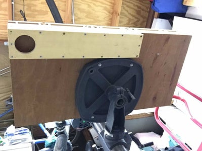

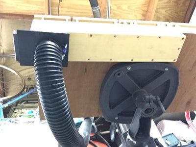

Step 11: Adding the Vacuum Adaptor
I made this adapter because I have a cabinet under my drill press table and it interfered with the dust collection. This step is optional if you don't have a cabinet under your table or if you don't have a dust collection system. If you do need this adapter, you may have to change dimensions to fit your dust collection system. I have a 2.5" shop vacuum system in my garage.
- I used 1/2" plywood to make my adapter.
- After cutting the pieces, glue the sides together and clamp.
- Before the glue dries, screw and glue the bottom on using 10 1" screws.
- When I mounted it to the bottom of the assembly, I removed the 1" screws in the corners.
- Then I glued and screwed the adapter to the assembly using 2" screws in the corners.

Step 12: Mount the Assembly to the Drill Press
- Position the assembly on your drill press table where you think it needs to be. More than likely it should be centered left to right on your table and the back edge of the assembly aligned with the back edge of the table.
- Clamp the table into position.
- From the bottom, locate where you can put holes so that the 2 back holes align with the back rail. Mark the locations.
- Remove the assembly and drill holes all the way through the table.
- Re-locate the assembly where you had it before in step one and mount to the table with screws.
