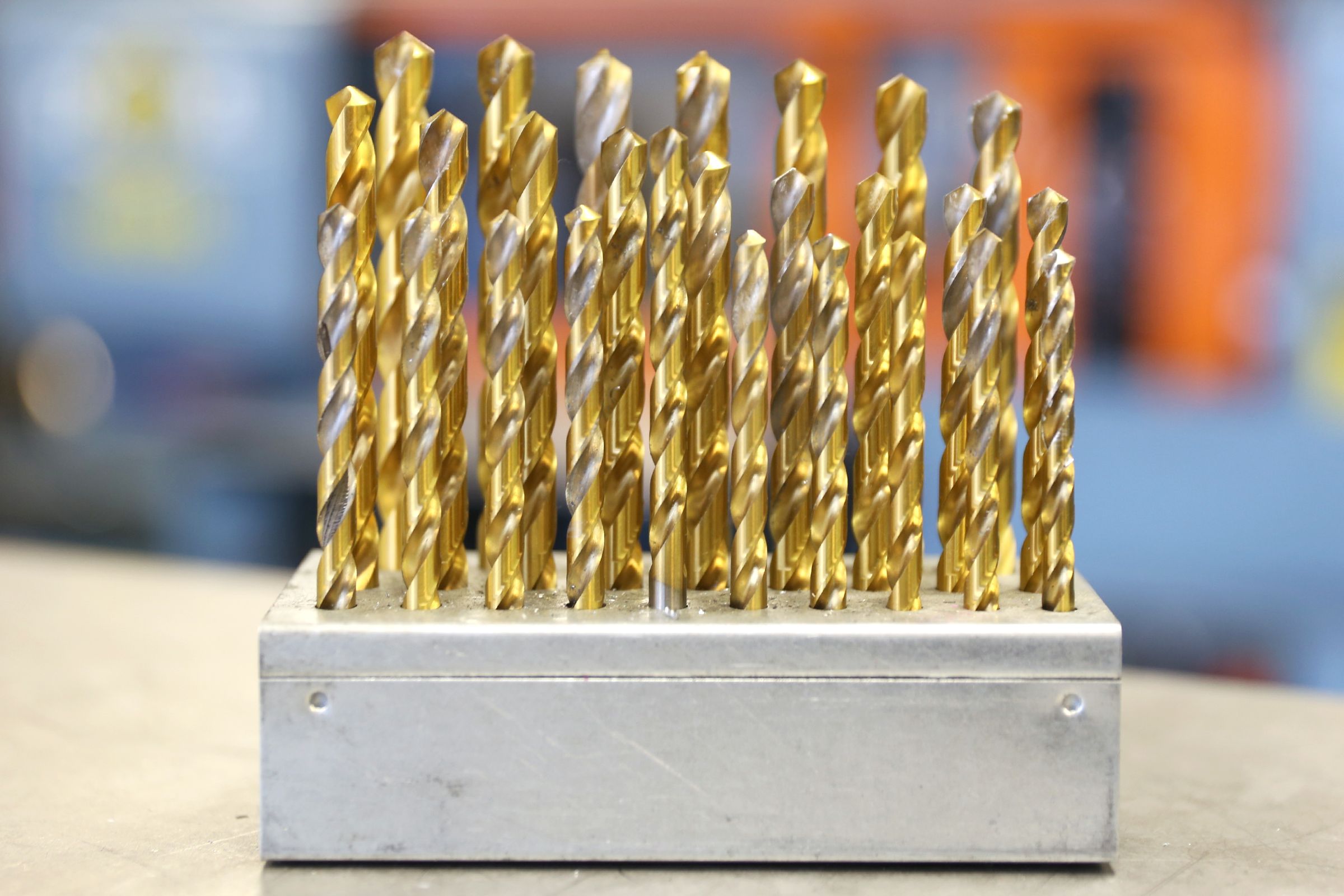

The primary type of drill bit you will use when metalworking is a split point drill bit. These bits have two cutting surfaces or blades, which are angled together to a point in the center. They are also angled in such a way that it cuts away material as the drill spins clockwise. The cut material is then cleared away through the spiraled flutes (channels).

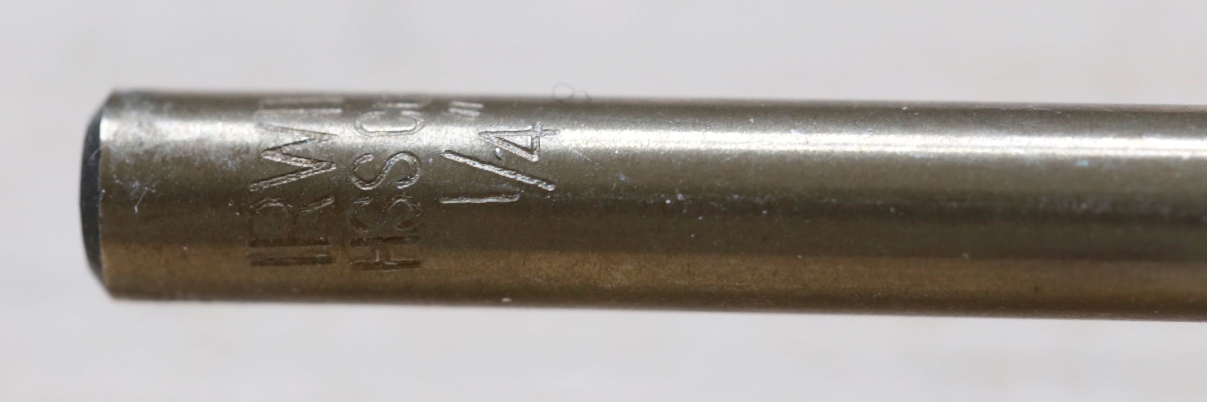

The opposite end of the drill bit is called the shank. It has no channels or blades, and typically has been hardened to withstand the forces of cutting. Typically, the shank will have a marking which indicates the diameter hole the drill bit cuts, and the type of steel it is.
Since we are working with aluminum, standard multipurpose carbon drill bits should do you just fine. However, when working with harder metals like hardened steel or stainless steel, you will want to use something manufactured to cut hardened metal such as high speed steel drill bits. You can see the HSS marking on the pictured drill bit shank which indicates that this one is in fact high speed steel.

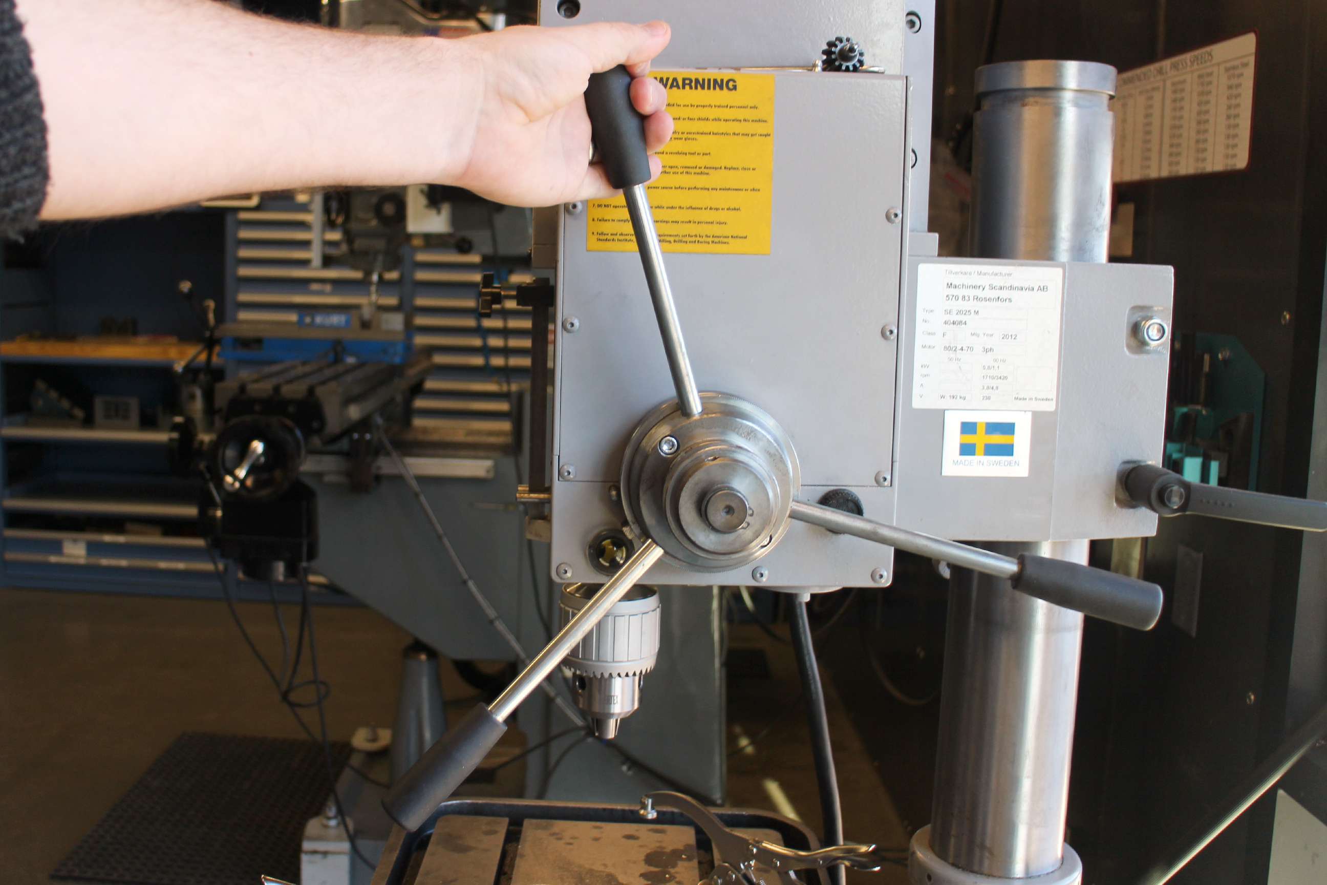

A drill press is a stationary shop tool with a spinning chuck that spins a drill bit really quite fast. Even though that is the basic gist of it, there is actually much more to it than that. Even though we will be using a hand drill I will be remiss if didn't briefly go over the functions of a drill press.

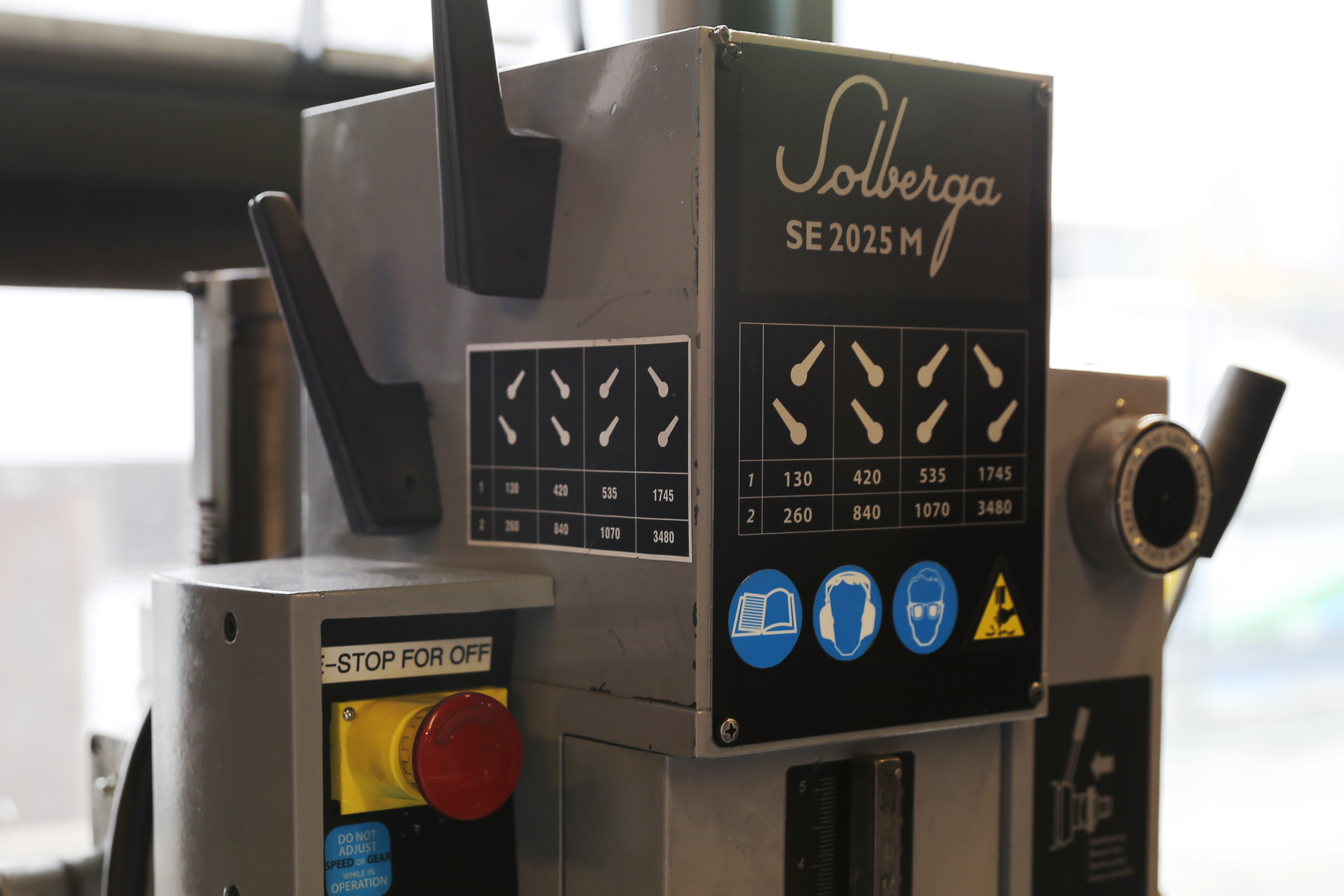

Like a motorized saw, drill presses have their own required speeds and feeds.
The speed is typically set before you begin drilling by setting the proper configuration of pulleys or gears. Is is determined by the diameter of the drill bit, and the hardness of the metal being drilled. The goal is to cut as much material as possible without creating too much heat.
The feed is determined by the person using the machine. By turning a crank or lever on the side of the machine, the machine operator can determine just how fast to try to move the drill bit through the part. While this is dead simple to operate, it can take a lifetime to really master.

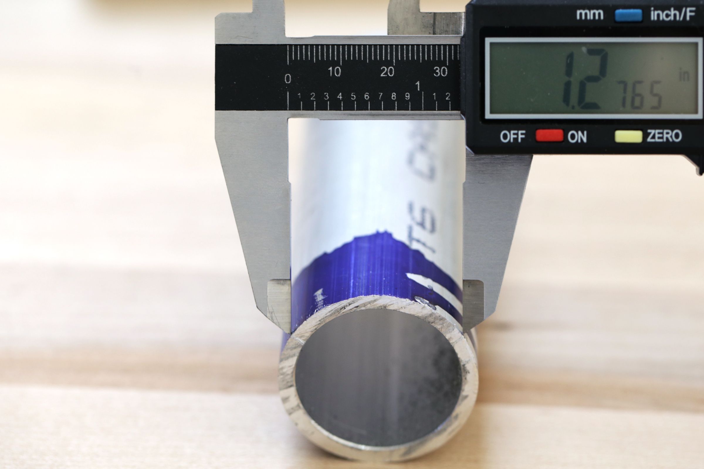

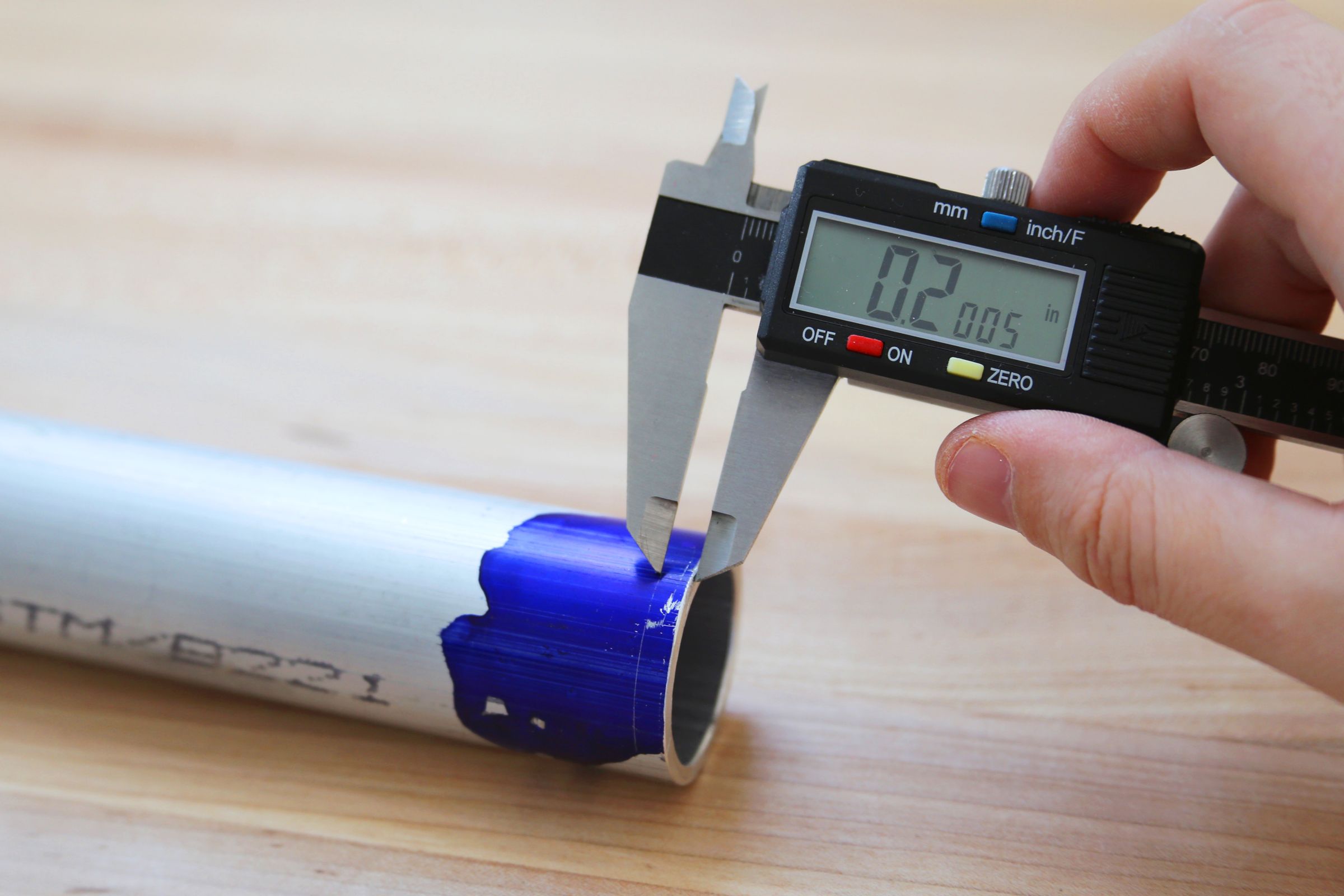

Draw a marking 0.2" parallel to the edge of the aluminum tube.
A trick for doing this is to use a set of calipers. Dial the jaws in to your measurement, and use the set screw to lock it in place. Use one jaw to follow the edge of the tube, and the other to trace a marking around the circumference.

Next, you want to use a scriber to draw perpendicular crosshairs along the circumference line that you have just measured at three equally spaced points around the circumference of tube. Figuring out three equidistant points along the surface of a round tube is very difficult. I would not judge you if you eyeballed this to get it right, as the precise spacing is not entirely important for these holes.
However, should you want to be precise, you can use your calipers to measure out an equilateral triangle along the round surface of the tube, and then drops lines down to intersect with the circumference line. The points should be approximately 1.275" apart.

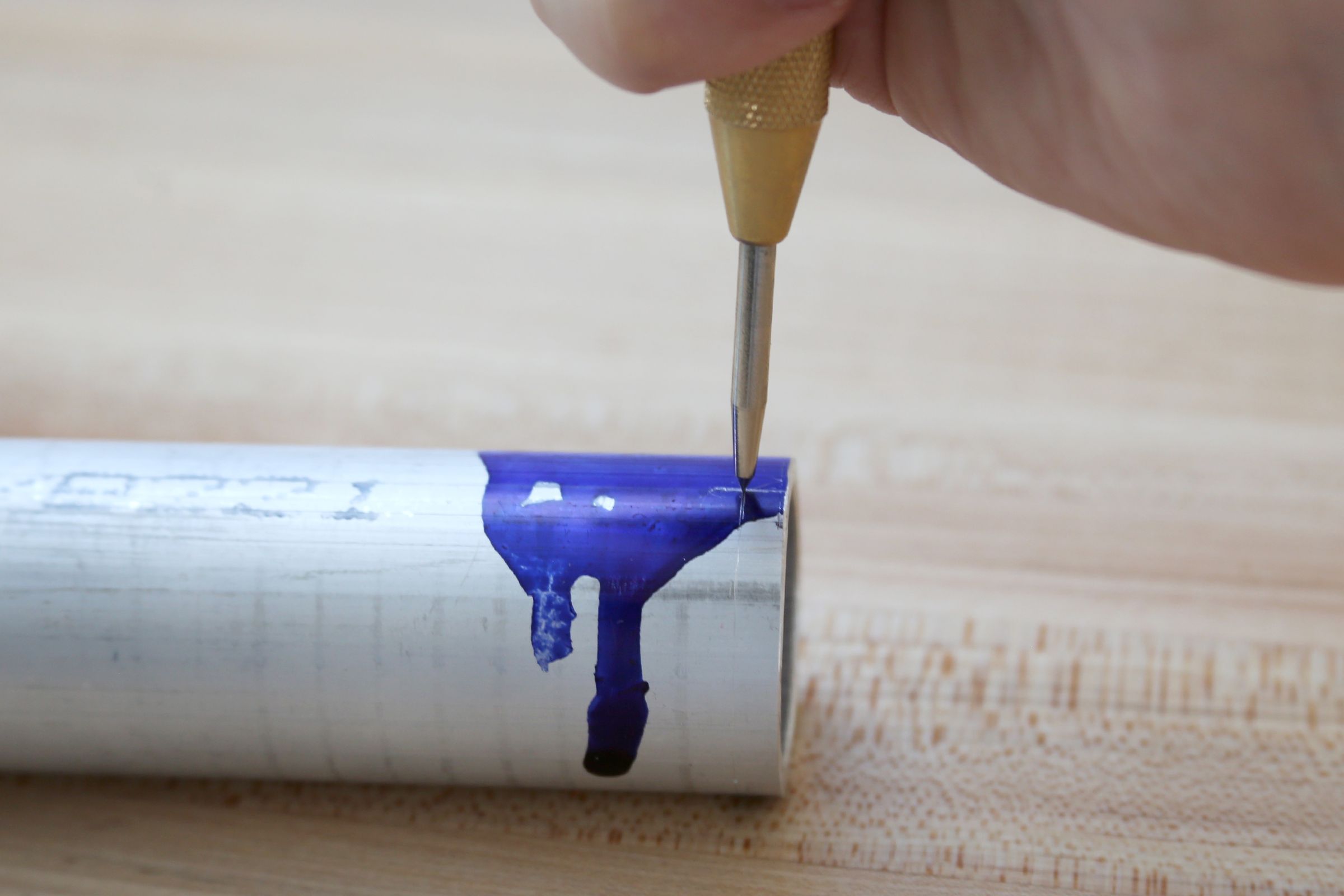

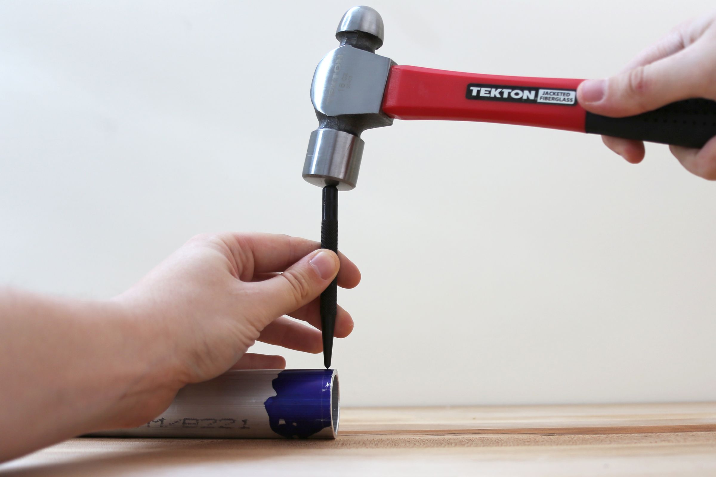

Now is time to punch a dimple into the three crosshairs that you just marked. This will give the drill bit a starting groove to spin in, and prevent it from wandering off-center. If you drill without first doing this, your drill bit will wander all over the piece of metal.
To make this indent, place your part on a nice firm surface and go grab a punch. This can be either a spring-loaded punch, or a more traditional center punch.
To use the spring-loaded punch, place the tip of the punch on the center point and push down until it forcibly kicks back at you. This is quick and easy.
A traditional center punch can leave a better marking, but it is a little bit trickier to use as you have to align the punch with one hand and give it a swift hammer tap with the other. As you will notice, doing this to a round surface (that has a tendency to roll) can get a little tricky.
