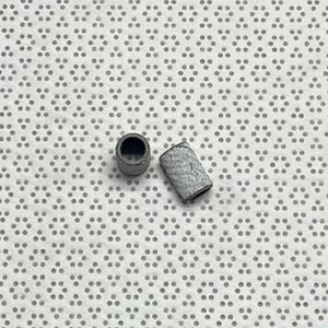

  5. 180 grit sanding band

For removing acrylic, grab a cone-shaped safety bit to avoid any cuts. Safety bits come in different shapes, so pick one that feels comfortable, keeping an eye on how sharp the edge is. You’ll also need a sanding bit for your drill to hold the sanding band—make sure they’re from the same brand for the best fit. Go for a 180 grit to buff things out, and when it comes to speed, use medium-high for the safety bit and medium for the sanding bit.

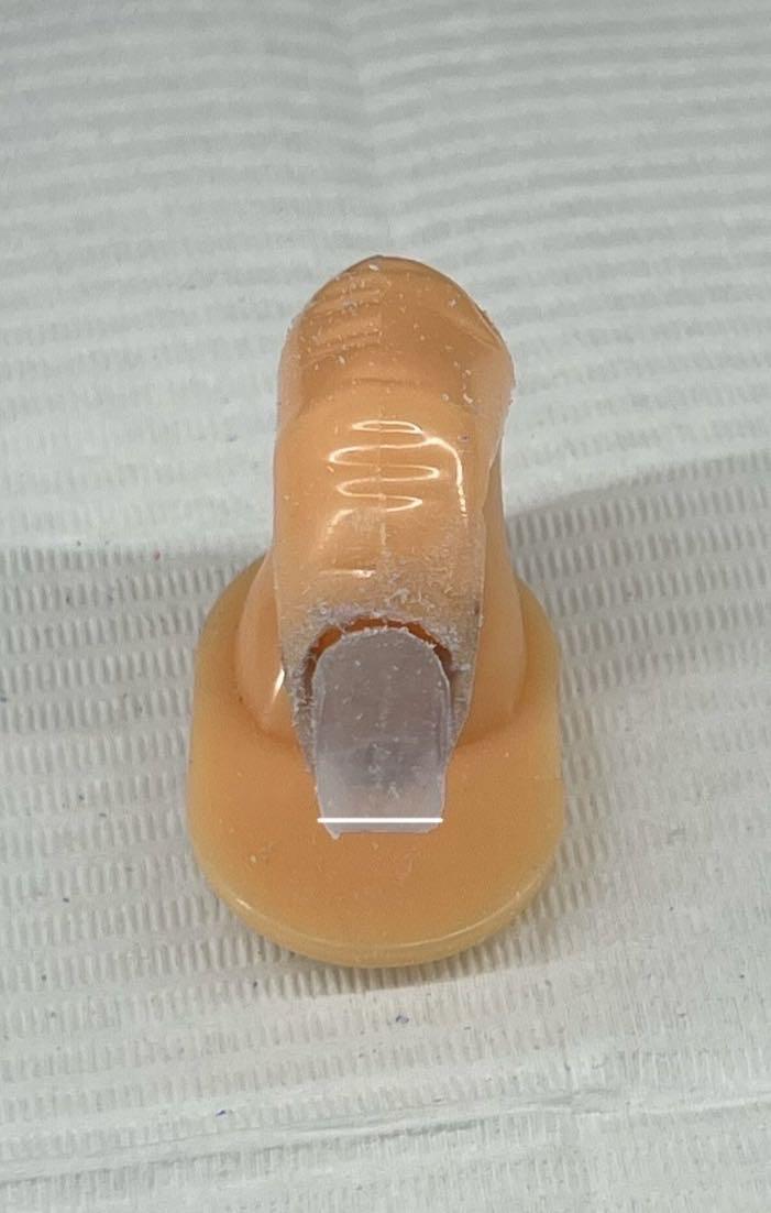

Remember to follow your imaginary guide. If using a two directional drill, set it to "forward" and pull it towards you to avoid pushing product toward the cuticle and risking injury. Apply some pressure when removing the product, but not too much to prevent the drill from getting stuck. When working on the right side of the nail, either flip the client’s nail or adjust your drill to work around the cuticle for complete product removal.
Step 6: Shorten the Nail If Needed
In this step I use my drill but you can use a nail file or clippers if you feel more comfortable. I take the drill and hold it to the right side of the nail and push through the free edge to get it to the right length. Make sure that all your nails are even at this step.

This is where your sanding bit comes in handy. Hold the drill parallel to the nail and use a low to medium speed to swipe the sanding bit side to side to make sure you have a smooth surface to work on top of. If you are using a buffer you will do the same motion but you will need to tilt the buffing block to ensure that all parts of the nail are being buffed.

Use your file at this point to refresh the edges or totally reshape the nail. I also like to use my sanding bit under the free edge to get a nice c-curve, but this is just my preference. I know there are people who prefer flat nails.
