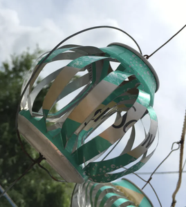

I first noticed these Drinks-Can-Wind-Mobiles when in Hong Kong, and was somewhat blown-away by how elegant their design was. I think they are part decorative, but also I suspect keep birds away from crops. They were from a place in Tai O, and island, known for it's laid back, slow pace, dried fish products, and cool crabs and mud skippers. In contrast to the bustle of Hong Kong island metropolis, it is indeed the sort of place people have time to craft things like this and have space to appreciate them.
However, I never met anyone nearby who could tell me how to make them, so I had a go at trying to figure it out myself... I should be said that these cuts can be made with a steady hand, but as I wanted my young son to have a go also - I felt that a 'guide' for the blade would be wise.

Step 9: Create 'Wind Blades'
Insert the pliers and add a crimp as shown. Do this all the way around, at a slight angle.
This 'angle' is what makes the wind have a pressure to rotate one way and not the other.
NOTE - reverse the crimp, on the other side, so you have both crimps facing the same 'focal point' if you like.
Step 10: Squash!
To give the 'blades' a bit of angle, press the can, to flex them outwards.
If any bend inwards, carefully push them back out with your finger (careful!) or use pliers.

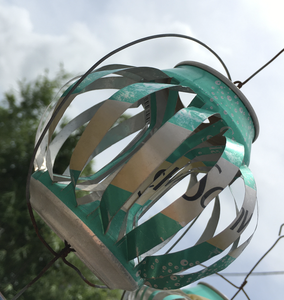

This is ready to go!
You can of course make different cuts and angles.
Of course some of the HK ones have the blades also pushed inside!
Step 13: Demo
See what variations work best. You can try different 'blade angles' and variations.
