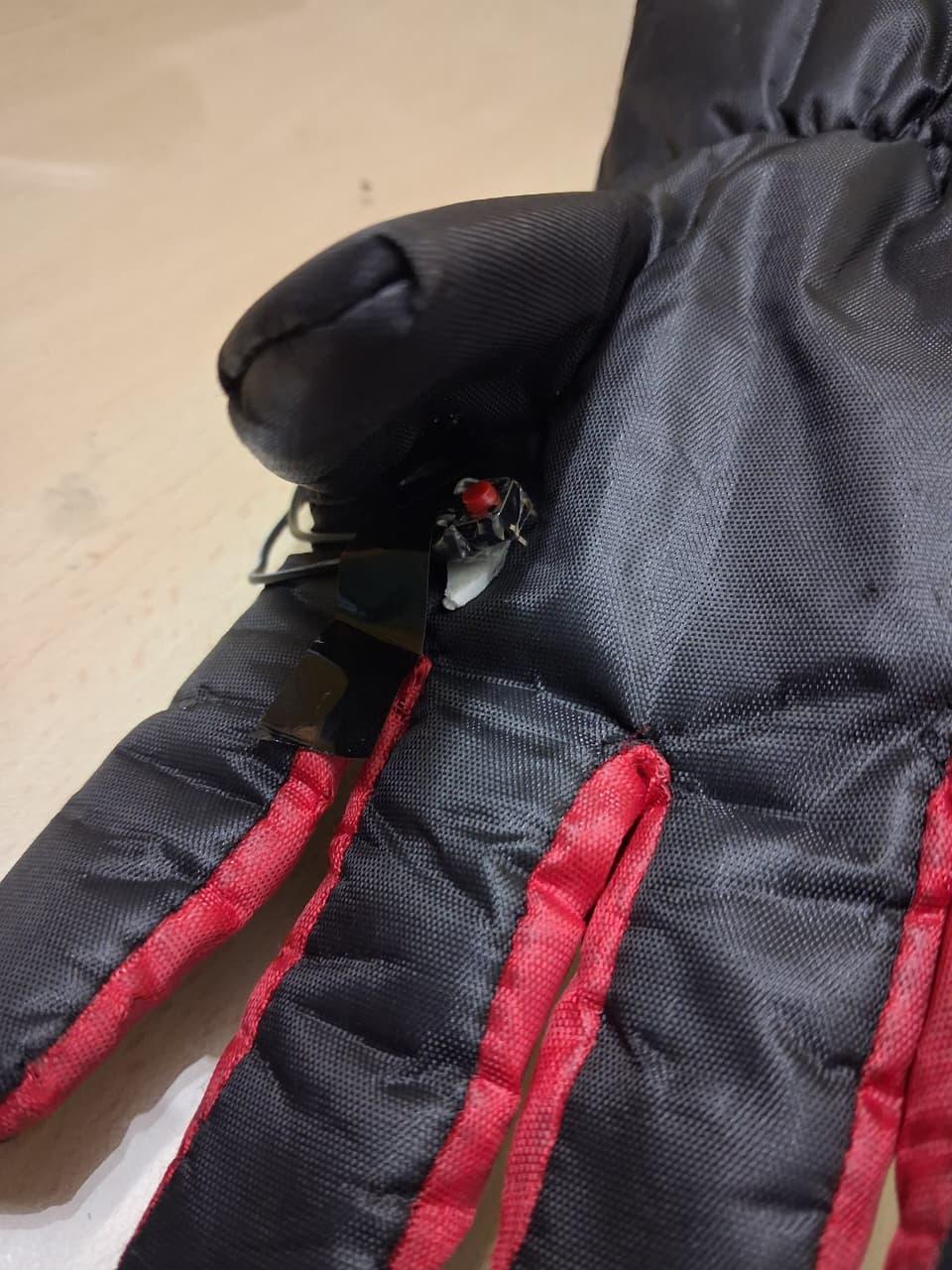

Step 1: Wire the Push Button
Wire the push button to GPIO 17 and GND of the Raspberry Pi Zero W (using the female to female jumper wires). The end product is shown in the picture. You can take help from the second image.

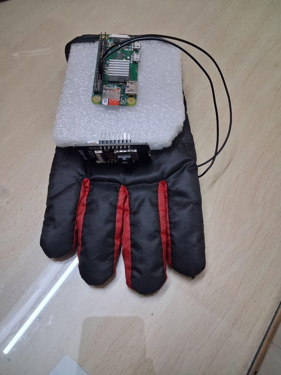

Steps to make the basic structure:

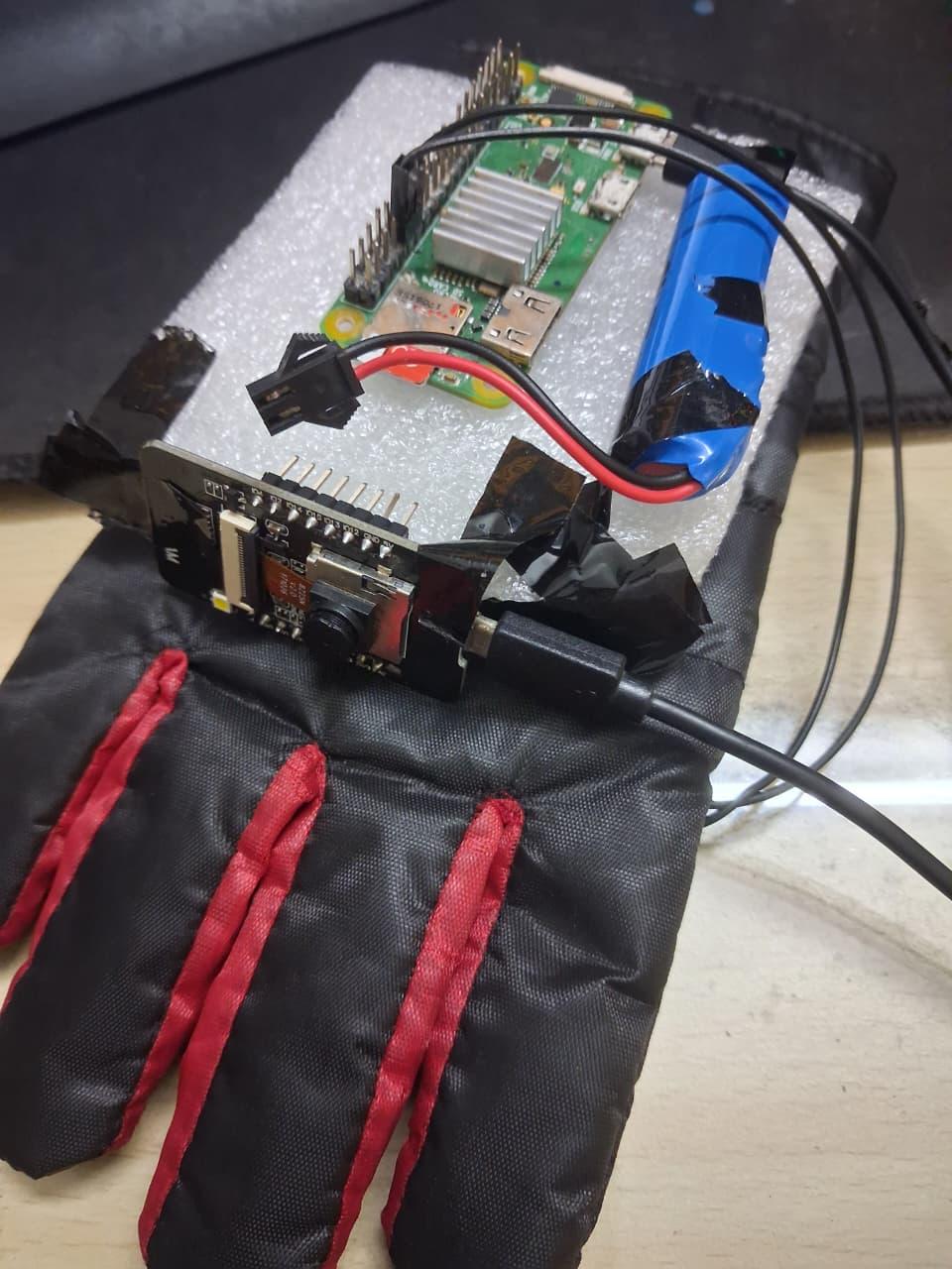

  1. Hot glue gun the foam board to the upper side of the glove.
  2. Double side tape the ESP32-CAM to the foam board so that it points forward
  3. Double side tape the Raspberry Pi Zero W.
  4. Double side tape the push button to the bottom side of the glove in a way so that you can press it with your thumb. Secure the button with tape attached to the wires.

Attach the power source of the ESP32-CAM and the Raspberry Pi Zero W to the foam board. Attach the battery for the ESP module to the module by:
  1. positive terminal to the 5V pin
  2. negative terminal to the GND pin
