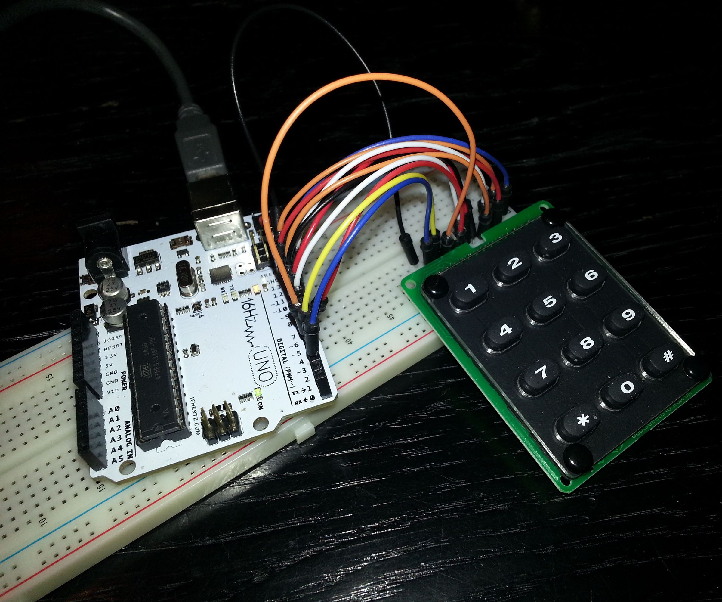

For simplicity, I plug the display straight into the board. The inline pins make this possible. Pins 13 and 12 of the display are the cathodes for the individual dots of the colon. I don't know why they are individually addressable so please comment if you do. I bent pin 13 of the display to connect with pin 12 so that they both go into pin 13 of the Arduino(see image).
Because this is a green LED display, it can handle the voltage(~5v) straight from my board. Be warned that your board may be different and put out a higher voltage thus harming your display. It is always good practice to use pull-down resistors on the cathodes of the display. DO NOT plug a red display straight into the board! It will burn out!
