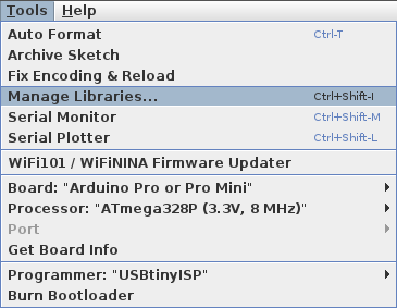

Step 6: Installing U8G2 Library
u8g2 is a library for interfacing graphical LCDs. If you don't have it, just open Library Manager in your Arduino IDE and search for u8g2.
