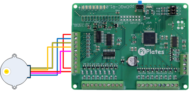

Step 2: Connections
The motor is labeled to operate at 12VDC but to make this easy, we’re going to start by driving it at 5V. Use the enclosed diagram to make your connections.
The connections all go to the DOUT terminal block and are as follows:
  • Motor RED wire: Terminal 10
  • Motor BLUE wire: Terminal 2
  • Motor PINK wire: terminal 5
  • Motor ORANGE wire: terminal 4
  • Motor YELLOW wire: terminal 3
  • Connect a wire from terminal 1 to terminal 9 – this is IMPORTANT since it shunts the inductive kick generated when a coil is turned off.
Using an ohmmeter, we measured about 100 ohms between the red center tap wire and the blue wire. If we use the 5VDC from the ppDAQC and assume that the “on” voltage of the open collector driver is 1 volt then we can calculate that each driver will have to sink about (5-1)/100 = 40mA. So, no special power supplies should be required for this experiment.

Step 4: Save and Play!
Save your program as UnipolarTest.py and then run it from the command line with the following statement:
sudo python UnipolarTest.py
If everything is correct, you should see your motor shaft rotate counterclockwise for about 16 seconds and then rotate clockwise for 16 seconds. This sequence will repeat until you press <CNTL-C>. While it’s running, try grabbing the shaft. and note that while it is a geared down motor it doesn’t provide a lot of torque at 5VDC. As an experiment, we disconnected the red wires from terminals 9 and 10 and connected them to a 12VDC power supply. Needless to say, the motor torque was substantially higher.
