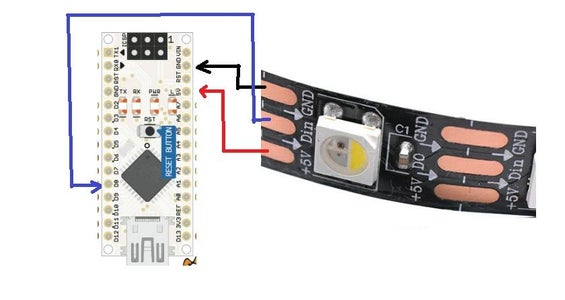

Arduino Nano/Uno (ATmega328p)
1 WS2812 or WS2816 LED
Jumper wires
Optional: 470Ω resistor on the data line for signal stability

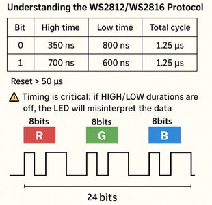

Step 1: Understanding the WS2812/WS2816 Protocol
  1. T0H = high time for a “0”
  2. T1H = high time for a “1”
  3. Reset = low > 50 µs to latch data into LED
⚠️ Timing is critical: if HIGH/LOW durations are off, the LED will misinterpret the data.

Step 4: WS2816 Bit Timing Principle
WS2816 reads a bit based on the HIGH pulse duration:
  1. ~0.7 µs HIGH → bit “1”
  2. ~0.35 µs HIGH → bit “0”
The LOW period completes the bit and ensures a total bit period of ~1.25 µs, which is required by WS2816.
Step 5: Example: Sending a “1” Bit
| Action | Pin | Delay (r16) | Approx. Time |
| Set HIGH | PB0 | 14 | 0.7 µs |
| Set LOW | PB0 | 12 | 0.6 µs |
  1. Total time per bit ≈ 1.3 µs, which is within WS2816’s spec (1.05 – 1.45 µs)
Repeating this 24 times sends one LED in full white.
