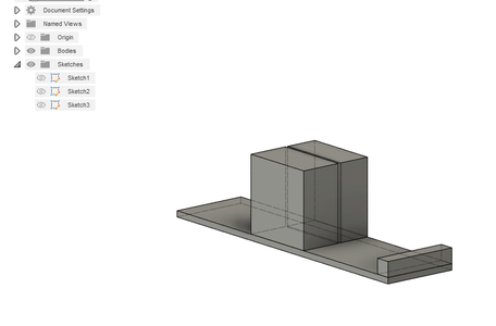

- Fusion360 to design the best things ;)
- DroNest Paper Plane Deployer (3D printed) - https://www.thingiverse.com/thing:6245453

Step 1: 3D Printing the DroNest Attachment
3D Print the DroNest Attachment for your drone, i printed mine in Green Glow in the dark PLA
it is designed for a fpv racing kwad but can me attached to a normal Quadcopter with zip ties or tape.
Download DroNest Attachment here! - https://www.thingiverse.com/thing:6245453
