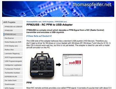

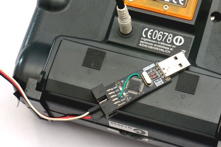

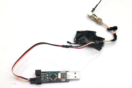

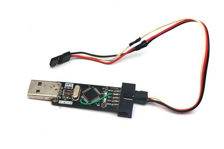

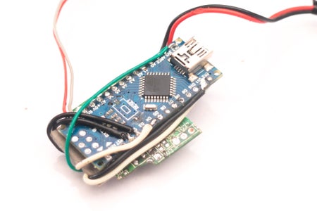

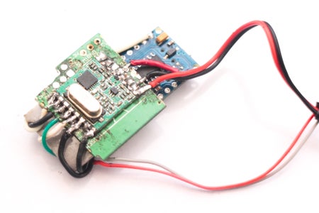

Buy USBASP, make new wiring for it based on this page http://thomaspfeifer.net/ppm2usb_adapter_en.htm then flash it with custom Hex (just follow instruction from that website). Im using PPM with OpenLRS 433mhz
Step 2: Prepare Your Transmitter and Receiver (PPM)

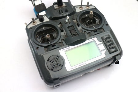

You can use any PPM TX and RX with this setup, and you can also use Jack Trainer behind your Turnigy 9x transmitter. TX and RX example like 2,4Ghz JR Module from frsky but now i'm using DIY OpenLRSng built from Arduino Nano and RFM22B board.
Using trainer port with jack is also possible. In OpenTX Setup you have to set the ppm to 'PPMSIM' to make it work. There is some tutorial here to flash usbasp ppm with port trainer https://www.instructables.com/id/Hacking-a-USBasp-dongle-into-a-PPM2USB-RC-SIM-dong

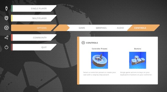

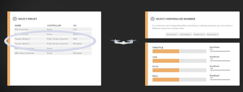

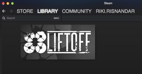

Install Lift Off games fpv drone racing from Steam. Then run the games, go to OPTIONS > CONTROLS > Controller Preset
and choose "Taranis 2 for OSX", the button assign will totally wrong but we will set our OpenTX transmitter to fully compatible with this games. Follow this steps:

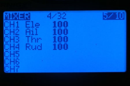

Make new profile in OpenTX
Assign CH1 to Elevator (ELE)
Assign CH2 to Aileron (AIL)
Assign CH3 to Throttle (THR)
Assign CH4 to Rudder (RUD)
You should see our transmitter is working correctly now
