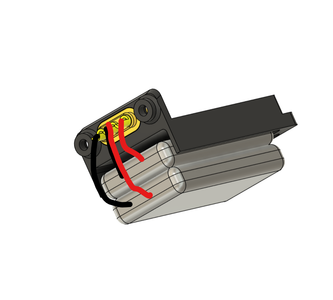

Step 5: Assembly Battery

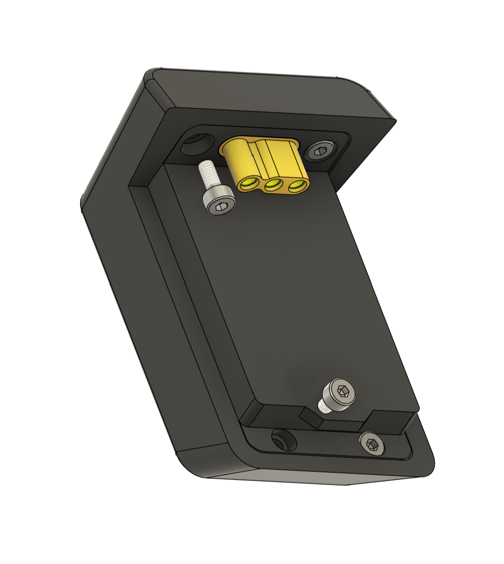

  1. take the "battery cover" and insert the MR30 connector in the slot in the 3D print. This should be the socket connector.
  2. Take two batteries. On the first battery take the red wire and solder it to pin 1.
  3. take the black wire from battery 1 and the red wire from battery 2 and solder it to pin 2. Be careful not to short the batteries
  4. Take the black wire from the second battery and solder it to pin 3 being careful not to short any of the pins
  5. Take the battery and cover and insert it into the "battery body"
  6. Take the M2 x 5mm screws and screw them into the 4 holes in the battery

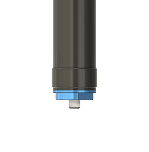

  1. Remove cartridge from the post - see oneup service manual
  2. Secure "post_bottom_rev11" to the base of the cartridge (where the schader valve is) with the stock nut
  3. tighten the post bottom into the post body

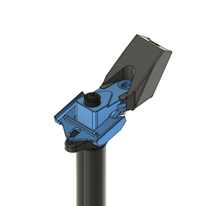

  4. slide the stanchion down to place the actuation module on top of the cartridge
  5. Use two M3 x 12mm long set screws and slide them in the holes at the base of the actuation module to secure the module to the cartridge
  6. use the 3D printed conical washer and a M6 x 10mm bolt to secure the stanchion of the post to the actuation module
  7. Use the stock bolts and nuts for the saddle clamp of your one up seat post
  8. place the saddle clamp bottom in the cradle on the of the actuation module
  9. Take the Saddle clamp top and place it over the saddle rails make sure the stock clamp nuts are in the new "saddle clamp top"
  10. combine the saddle clamp to install your saddle on the seat post
