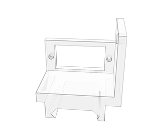

Knowing that we were using the Iris+ model drone and after a little wondering through Thingiverse we found glenchung's Iris+ Range Finder Mount model. glenchung's range finder ingeniously snapped onto the drone arm without any hardware or modifications. After a few little modifications in Sketchup we had added a microservo and a catch plate. The printed parts were pretty snug so we never even added screws to the servos. Just a little solid core wire to the servo arm and into the hole in the catch plate. The radio transmitter was programmed to control the open and close positions. The settings were determined by trial and error.
With one Claw printed and installed we arranged for a test flight and proof-of-concept with FWA. It was successful and tons of fun! The test used fake eggs for easy modifications but actual eggs could be used with a short length of electrical tape that made a loop on top of the egg. The tape held just fine for short flights. With a successful test we printed three more Claws. One for each arm.

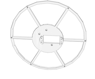

The concept was to use five or six egg containers mounted on a frame with a rotating bottom. The bottom would have one cut out just big enough to drop an egg. The initial servo position would be halfway between two containers thus not allowing either egg to drop. This required a servo with a range close to 360(deg) but those are hard to find. We settled for a continuous motion servo that Nick would move slowly until an egg fell and then stop. (We learned about Winch/Sail Servo motors after it was too late.)

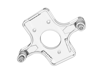

The frame design called for two separate 3D printed brackets bolted together with space between them for a heavily modified servo arm to spin. The top bracket held the servo motor and paper cups for egg containers. The bottom bracket was mounted to the top bracket with M4 bolts. There were 3, M4 nuts placed between the brackets as spacers. The servo arm was modified from hugokernel's Parametric Servo Arms using Sketchup to be more like a servo plate it a cut out and 3D printed.
The cup and frame contraption was mounted to the underside of the Iris+ using the camera gimbal mounting threads and modifying Firdinand128's 3DR IRIS mount. The bracket from Firdinand was rearranged to accept 3, M6 threaded rods that attached to the top bracket of the revolving dropper.
Files and a Dremel were used liberally to fine tune the 3D printed parts so that everything lined up and spun freely. There was also plenty of Loctite used to keep the hardware from shaking loose.
(Thanks to Firdinand128 for the 3DR IRIS mounting bracket for DYS 3 axis Gimbel: http://www.thingiverse.com/thing:367015 and to hogokernel for the Parametric Servo Arms: http://www.thingiverse.com/thing:28566)
