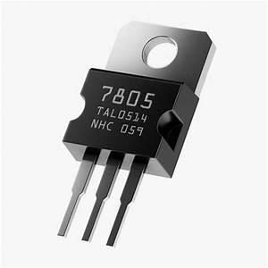

6.) 7805 Voltage regulator IC

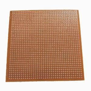

9.) Zero PCB

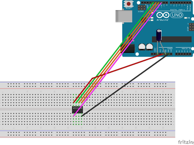

2.) Now make the connection according to this circuit diagram
3.) Before uploading the code you have to upload Arduino ISP example code in your Arduino board.
4.) From tools Select attiny85 from the board then select clock speed to 8Mhz and then select programmer as ISP.
5.) Now upload the main program to the attiny85 IC through the Arduino board.
