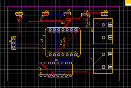

For this project, I decided to design a PCB and have it assembled. I’ve never done it before and wanted to explore this. I’ve seen a lot of other creators at Instructables and Youtube make their own PCB so I thought this will be a good project to give it a go.
I used Easyeda for designing the circuit and PCB. There might be better alternatives out there, but I’ve seen a lot of youtubers use this and it seemed quite easy to learn. I will mention some tips and tricks as well as some good practices of PCB design I leant during my research in this tutorial.
I placed the Xiao Esp32-S3 in the middle and the L293D beside it to the left. It is a good practice to first place the bigger components and then add the smaller components later during design (the opposite applies while assembling a PCB!).
On the right are the five hall sensors. The digital outputs of the hall sensors are connected to pins D1 through D5 on the microcontroller. They are also pulled up through 10k resistors each. This way, when a magnet comes close to a sensor, the output of that hall sensor is pulled low.
The analog output of the CO2 sensor is connected to A0 of the microcontroller. Enable 1 of the L293D is connected to D8 and inputs 1 and 2 are connected to D6 and D7 respectively. The two motor outputs of the IC and the VCC are connected to two connecting blocks. The second motor inputs and outputs can be ignored since we are going to only drive one motor.
Before moving forward, it’s a good idea to check the nets to make sure all wires are connected at both ends and there are no bare terminals (except for the ones that are not required)

First, I clicked on the "Design" menu and selected "Convert Schematic to PCB." EasyEDA then generated a new PCB file with all the components from my schematic. It's important to note that at this stage, the components are not yet arranged properly.
Next, I began arranging the components on the PCB. I started with the larger components, like the Xiao and the L293D. Connectors need to be placed near the edges of the board for easy access. I made sure to leave enough space between components for routing traces and to allow for easy soldering later on.
Once I was satisfied with the component placement, I started routing the traces. I began with the power and ground connections, making them wider than signal traces to handle higher currents. For sensitive analog signals, I used shorter, more direct routes to minimize noise pickup.
After I had placed all the components on the PCB, I decided to use the autoroute feature. I have never done routing before, so this feature is a Godsend! I clicked on the "Autoroute" button in the PCB toolbar. I chose to route all nets. (I later re-did this by skipping the GND nets. Reason explained later.) I then set the routing layers to use both top and bottom layers for a double-sided PCB. It’ll take a few seconds to create the routes after you hit “Run”.
After the autorouting was complete, I carefully reviewed the results. While autorouting can be a time-saver, it's important to note that it may not always produce the most optimal layout. Especially, it is recommended to have all angles at 45 degrees or lower. No 90 degree bends!

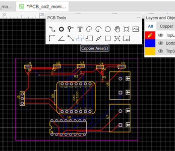

We’re not done yet. Where are the ground connections?! Well, we are going to add a copper layer for it. It is good to improve signal integrity and reduce electromagnetic interference.

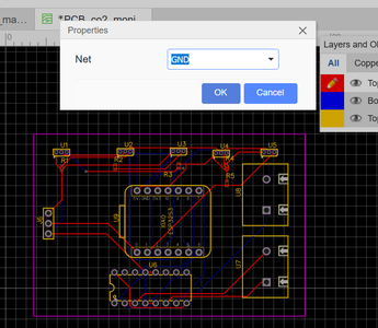

First, I clicked on the "Layers" panel on the right side of the PCB editor. I then right-clicked on the bottom layer (assuming it was a two-layer board) and selected "Add Copper Area."
In the dialog box that appeared, I set the net name to "GND" to ensure this copper area would be connected to the ground net. I also adjusted the clearance value to 0.3mm (this is a good clearance value!)
Next, I drew a rectangle covering the entire board area. Once I finished drawing, the copper area appeared on the bottom layer.
To connect all ground connections to this new copper layer, I used the "Rebuild All" button in the copper area properties. This automatically connects all GND nets to the copper area.

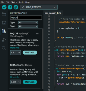

The MQ135 air quality sensor module was used for CO2 detection, and an important component in its functionality is the load resistor, RL. This resistor adjusts its resistance value in response to varying gas concentrations, which is essential for accurate readings. According to the MQ-135 datasheet, the load resistor can have a value ranging from 10KΩ to 47KΩ.
For optimal performance, the datasheet recommends calibrating the sensor using 100ppm NH3 or 50ppm alcohol concentrations in the air, suggesting a load resistance (RL) of approximately 20KΩ. However, if you trace the PCB, you’ll find a 1KΩ (102) load resistor in place. To accurately measure CO2 concentration values, it’s necessary to replace this 1KΩ resistor with a 20KΩ resistor. So, I removed the existing 1kΩ resistor and soldered two 10KΩ resistors in series.

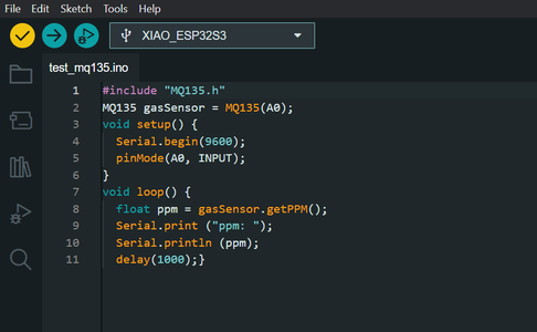

Step 10: Testing the CO2 Sensor
Make sure to preheat the sensor for 24 to 48 hours before proceeding. Preheating is basically leaving it plugged in to a 5v supply for the built in coil to heat up and remove any oxides formed.
Since we modified the resistance, we will have to make a few updates to the built in MQ135 library as well. First, download the MQ135 library in arduino IDE. Then, use the code attached in this step (get_r0.ino) to determine the R0 value. Now once you got the Ro values, Go to Documents > Arduino > libraries > MQ135-masterfolder and open the MQ135.h file and change the RLOAD & RZERO values. Rload is basically 20 (20kΩ).
Finally, upload the code (test_MQ135.ino) to your board, and you should see the PPM readings!
A small disclaimer. The MQ135 is not a dedicated CO2 sensor. It is sensitive to a range of gases including ammonia (NH3), nitrogen oxides (NOx), alcohol, benzene, smoke, and carbon dioxide (CO2). The sensor works by changing its resistance in response to the concentration of target gases in the air.
While I have tried my best to make it as accurate as possible with the code, it is no way close to the accuracy of some more expensive CO2 sensors like the MG812 or the SCD40. But the goal here was to keep the cost low to make it a compelling option over commercial smart home CO2 sensors. Also, we are categorizing CO2 ppm levels into five ranges, so the sensor doesn't need to be highly accurate. As long as we get relative information about high, mid, and low levels, we're good to go. And the MQ135 works perfectly fine for this application.

Step 12: Programming the Esp32
This section is intentionally small. I know the code is quite complex and this Instructable is already too long. If anyone is interested, please drop a comment, and I’ll add a step at the end with a detailed code walkthrough.
For this step, all you need to do is install the necessary libraries and upload the code attached (co2_sensor_1.ino).
Here is a good article that mentions the necessary libraries and how to install them: https://wiki.seeedstudio.com/XIAO_ESP32C3_Getting_Started/

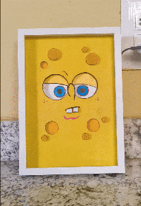

Now it’s time to assemble the SpongeBob artwork. Looking from behind, the main face board goes first, the eyelid section goes on top of it, then the eye section, then the motor is attached. And above all, the circuit is placed.
The connections on the circuit is pretty easy. Everything is labelled. I added a bare USB-C cable to the Xiao and connected to the 5v terminal (This could be done while designing the PCB, but I forgot :P).
Finally, place it inside the IKEA frame and it’s ready!
Step 14: To Conclude...
The artwork looks amazing to be honest. The 3D effect due to the thick sunboard is definitely a plus. Now, you can know when SpongeBob (and hence you) get’s drowsy and open your windows to let the CO2 out! Isn’t that super cool? You and your artwork having the same amount of concentration at work haha.
I placed the CO2 sensor behind to hide it from view. If you do this too, make sure the frame is not placed in the corner of the room where there is no air circulation. Otherwise your SpongeBob might always be drowsy!
The eyelids do wobble a bit while moving, but that is not an issue at all. Since they only move when there is a significant difference in the CO2 levels, you will barely see them move. However it does make some noise while moving. Mainly because of my old geared motor grinding. I think a tiny N20 motor would be a better option.
You may have noticed something odd. I've used an Esp32 which is a Wi-Fi microcontroller, but this project doesn't use Wi-Fi. Well, the idea is to add some more code to enable tracking the CO2 ppm history in the room and send the data to the phone. This feature is in my to-do list and will be added soon!
