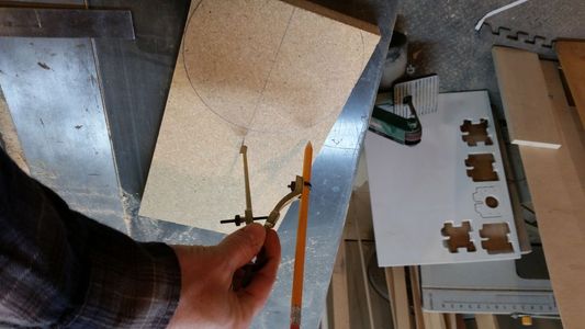

Step 1: Create the Pattern!
Take your piece of wood and align it 6" wide and 11" tall. (Moser Labs Quick Tip: Put a mark on the center of the board to help align the holes)
With a ruler, draw a line up the center of the board to show the center of the board. Make sure it's along the center of the board and not angled to a side.
Draw a dot at 2" from the bottom; this will be the center point of the base (or butt in Snowman language)
Draw another dot at 5 1/2" from the base; this will be the middle (or abs in Snowman)
Draw yet another dot at 9" from the base; this is the top (or brainey containey region in Snowman)
With these three marks, you are ready to doodle down some circles!
Using your compass, draw out a 6" circle (use your ruler and from the metal pivot part set your pencil at 3" - since a compass uses radius and not diameter....) at the lowest dot (the butt area).
At the second dot up (the abs), draw a 5" diameter circle.
At the 3rd dot (the brainey containey region), draw a 4" circle.
The three circles should overlap, and should form a snowman! (not sure why the one photo is upside down... I wasn't able to edit it in Pixlr app)
