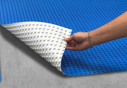

For the final stage of the renovation, I turned to flooring. I went with LVP (Luxury Vinyl Plank) because it’s waterproof and won’t be ruined if the basement ever floods again. Underneath, I laid down a dimpled underlayment to let air circulate, which helps any trapped moisture evaporate and keeps mold from forming.
Installation was straightforward: first, roll out the underlayment and tape all the seams. Starting from the back wall, click the planks together, staggering the seams, and cut the last pieces to fit with a small expansion gap along the walls. Then repeat row by row, making sure no plank is shorter than 8 inches at the ends as this keeps the floor strong and prevents weak spots. Once everything was locked in place, I finished it off with solid wood baseboards I had already painted.
