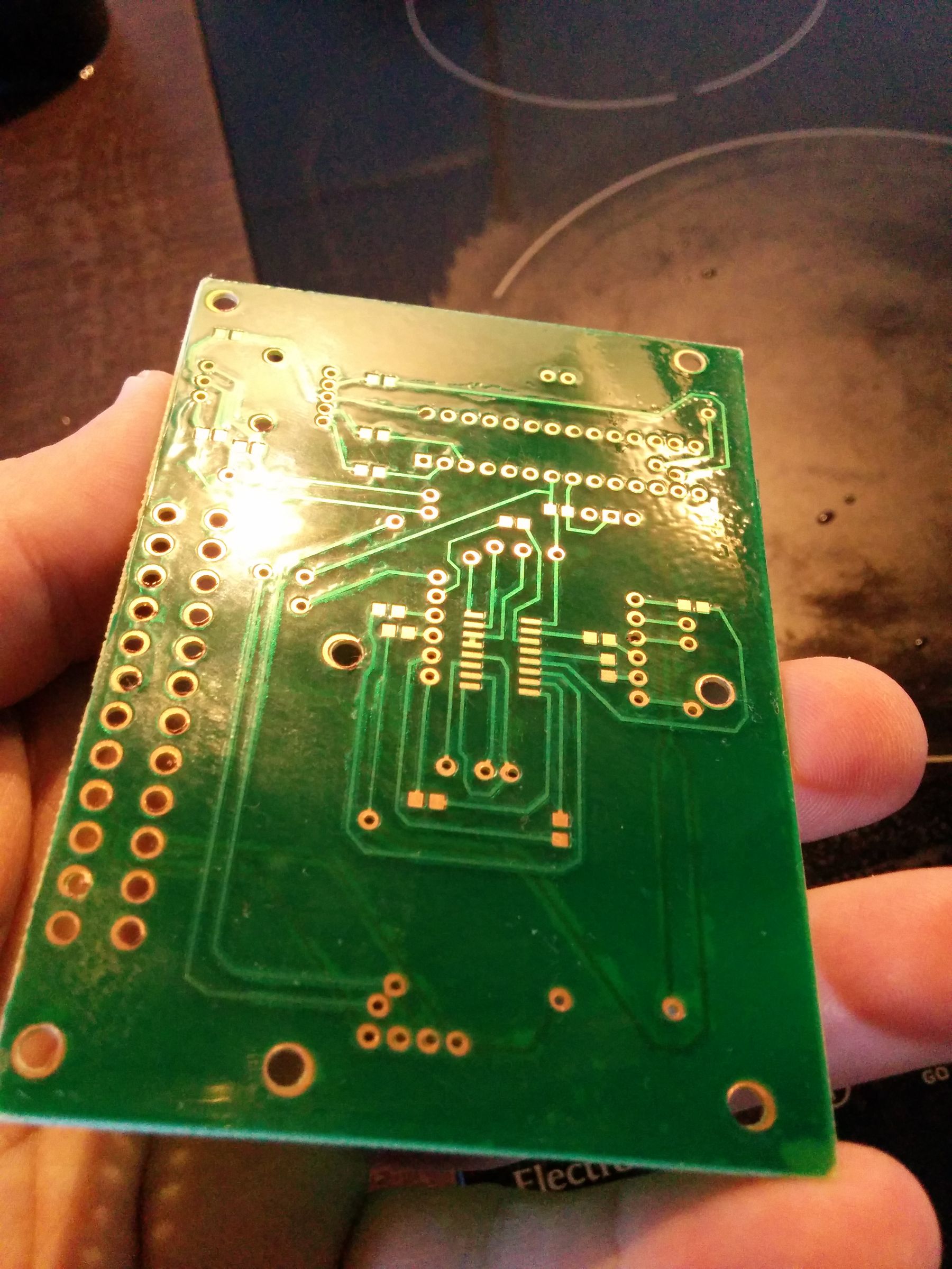

Step 2: Laminating
The procedure is simple.
First we start with your already etched and cleaned board. No grease or any kind of contaminant on the board.
Cut a piece of dry film a little bigger than your board.
The film comes with two transparent protective films one on each side.
One side is glossy and the other is dull. With the help of two pieces of tape, figure 2, remove the transparent protective film on the dull side.
Adhere the edge of the film to the edge of the board and then run it through the laminator 3 or 4 times or iron it until sticks good. Avoid air bubbles and wrinkles they don't look good.
Let it cool for 1 minute.
Step 3: Exposure
Cover the board with the artwork matching vias and pads.
Expose the board to the Uv light for about 1 minute.
Take it out and leave it rest for 5 minutes.
Step 4: Development
After 5 minutes remove the second protective film with the help of a tape.
Prepare a solution of 10 grams of sodium carbonate on one liter of water. Actually you are going to use less so you can do 5 grams on half liter of water or less.
Sink the board in the solution and gently start scrubbing with the brush until all pads and vias are exposed.
Increase the rubbing pressure for those vias and pads that are a little difficult to remove.
Rinse with water and remove the left overs that are hanging out on the board edges.
Step 5: Curing
Wipe the board with a rag and let it dry.
Expose it again to the UV light for at least 30 minutes for complete cure of the solder mask.
And that's it. You have a perfect board with solder mask like the professionals.
Just stuff your board with the components and your circuit board is ready!!!

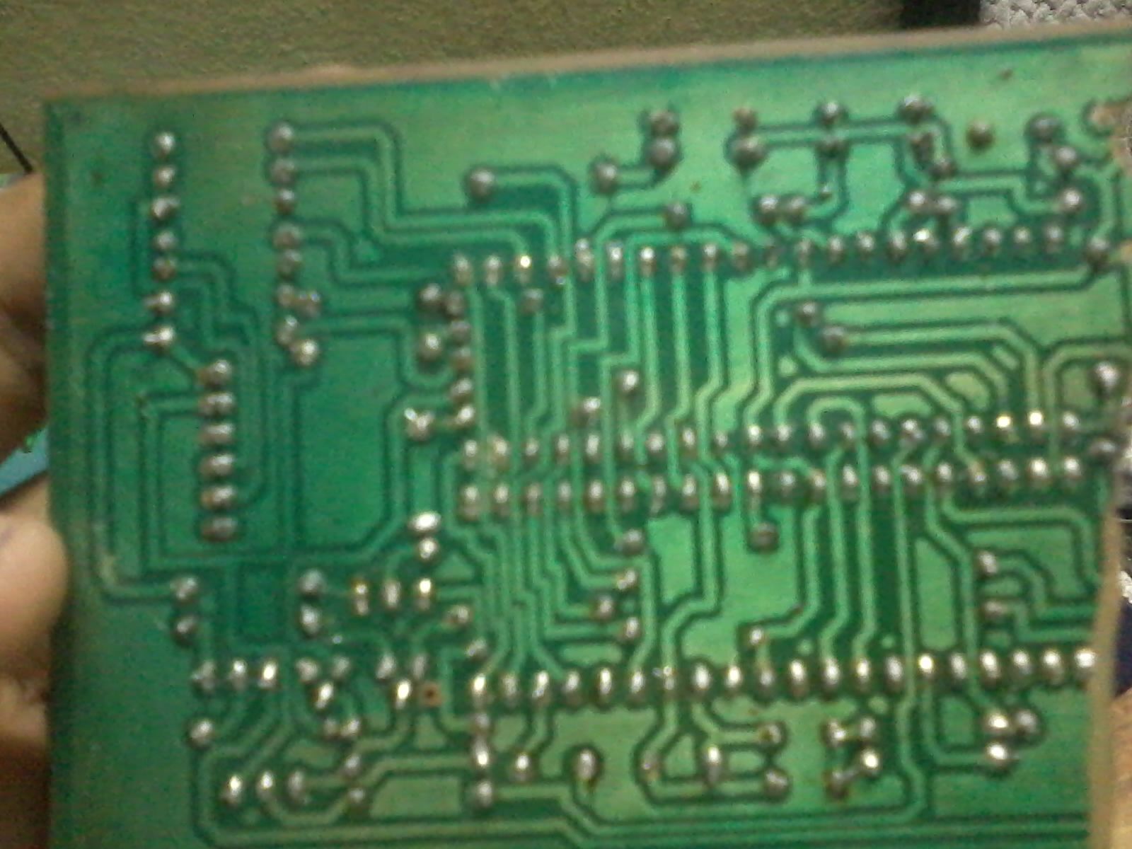

This is image of my pcb which i made at my home
The desihn is made in cadsoft eagle professional.The pcb is made with toner transfer qnd then the solder mask and silk screen is applied through screen printing.I used these stuffs for solder masking and silk screen.The final pcb looks very professional and i an very happy with these results.The screen printing i know is a very laborious process but i can't find other stuffs in my city like uv crucable ink or something like that of a stuffing agent.So i have to go through the process which i find best in my city.I applied the anti solder ink to both the sides of my pcb to improve it's looking.The silk screen is done with a PVC white ink through screen printing.
