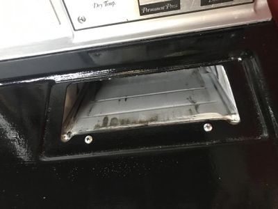

Step 1: Take Out the Lint Screen
Take out the lint screen, and remove the two screws underneath.
Step 2: Open the Top
The top pops up with a little prying with a screwdriver. Use a bungee or rope to prop it open.

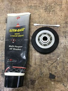

Step 5: Check the Rollers
One of mine would barely turn. This is what caused the old belt to break.
Step 6: Take Off the Seized Roller.
There is a little plastic clip that holds the roller on its shaft. Pry it off with a screwdriver, and the wheel will slide off.
Step 7: Clean and Grease the Roller and Shaft
It took a little scrubbing to get it clean. Then I used lithium grease to lube it.
Step 8: Put the Roller Back On
Slide it on. Make sure it turns freely. Then put the plastic clip back on.

Step 11: Spray Paint
Set up some saw horses. Then spray your parts. You obviously have to do this in stages, one color at a time. But spray paint dries pretty quickly. On a breezy day I was able to re-coat or change colors after 20 minutes. I didn't want to take the top off the dryer, so I painted it with a brush and some black enamel.
