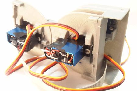

Step 3:
We need:
- 2 x MG92B Servomotor
- 4 x 520 Ohms Resistor
The second thing to do is to adapt the MG92B Servomotors to turn the full 180 Degrees. The method we used was to add a couple resistors to each servo control circuit:
- Take apart the back cover of the servomotor (4 screws).
- Carefully separate the control circuit from the inside. The potentiometer is located under the circuit (it may be covered by a black film). Once you can access the 3 pins of the potentiometer,you have to unsolder the first and the third cable (not the center one). Then, you have to solder a 520Ohms resistor to each of these two pins, and then solder the cable to the resistor. You can find tutorials on how to modify servomotors (search: Modify servo 180 degree), but it’s important you use the 520 Ohms resistors (in the pictures we used one 680 and one 2200 Ohms resistors in parallel to get the 520 Ohms).
- The control circuit does not fit the casing anymore, so we are going to stick it to the side of the metal case (see pictures). Protect the circuit from short-circuits with some tape on both sides.
- Repeat the procedure for the other servomotor

In this step we are going to fix the motors to the printed parts. The motor should fit correctly. We can use the screws that come with the motor, but we will have to cut them to the right length.
