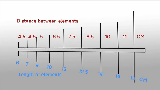

Log periodic antenna from skidoo variation.
Gkat versuib of the log peridic annna
