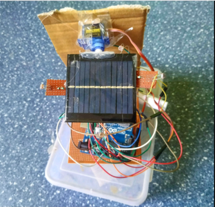

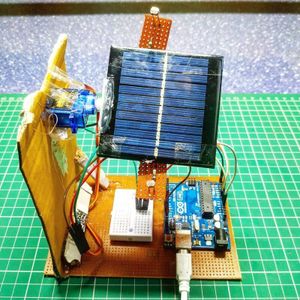

Hey Folks, Welcome back to another interesting Project based on Arduino. This project is highly demanding among engineering students and hobbyist, so enjoy and do try to DIY it. Today we're going to make a dual-axis solar tracker using Arduino UNO and few other passive components. This can easily be built as all the components are easily available in the local market.
We'll use some components like Servo motor, Solar Panel which are main components for this project. As you all know, Arduino UNO is a most popular microcontroller which is used for most of the projects. As it has 10-bit ADC, it is very helpful in reading and writing Analog values. So we’re going to use LDR for calculating the intensity of Light falling on the 4 LDR's to calculate the area where most of the light is falling to make the Solar Panel rotate in the desired direction using servo motors.
Note: As this project is for demonstration purpose, so I'll shall not guarantee the fullest potential of the LDR's and Solar Panel to come out from this DIY. So you may think twice before making a choice for better quality components. Also, the power generated from this project may also depend on intensity of light and rotation of the servo motors.

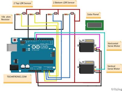

Step 1: Material Required
  • Arduino Uno
  • 4 LDR
  • 4- 10K Ohm Resistor
  • 2- Servo Motor
  • Solar Panel
  • Jumper wire
  • Breadboard
Step 2: Circuit Diagram
