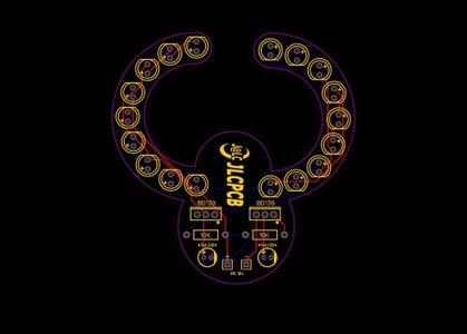

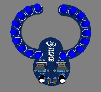

Step 2: LED Flasher Circuit Design
Here the led flasher circuit, we design for you, it is a very simple and cheap led flasher circuit. We don’t add power supply circuit, with this led flasher circuit. For power supply circuit, you can use 12v battery or DC-12v adapter circuit. The schematic of LED flasher circuit design along with the PCB layout can be seen below.

Step 9: Soldering & Cleaning Amplifier Circuit
It’s the time to soldering and cut-off all extra leg of electronics component. Now we solder all component leg carefully and to make sure we need to check all of them for several times. We also remember that, there should not be any kind of short circuit connection. For perfect inquiry, we should use liquid PCB cleaner to wash PCBs.
