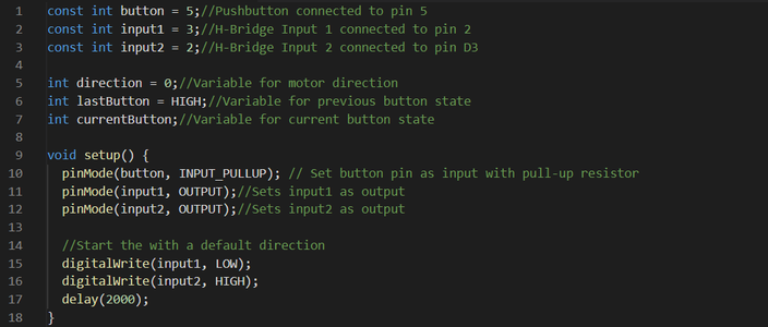

Step 5: Coding Component
Here is step by step guide to the coding component of the project, used to switch direction.
  1. Declaring all the pins connected to the Arduino, the pushbutton and the bridge inputs
  2. Adding three variables: Direction, Last button state and Current button state
  3. Declaring the three pins as either input or output and giving the motor a default direction to spin
  4. Current button state is set to whatever signal is read from the pushbutton by the Arduino
  5. Since the button initially will not be pressed, current state and last state will differ, causing the if statement to activate
  6. We switch motor direction by using the not or ! operator, and the direction is now a numeric value that is not 0
  7. Another if-else statement now controls the direction of the motors by using the motor direction value as a condition. If the direction was changed, then the power supplied to either terminal of the motor is switched
  8. Lastly, last button state is set to the current button state for the loop to cycle again properly.
