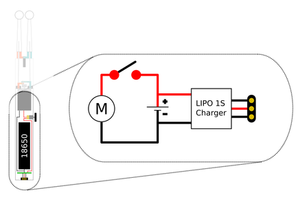

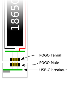

Step 1: Charger and Toothbrush Electronics
Lets start with the base of the electric toothbrush. The base does not actually contain the charger PCB (for reasons explained in the next point) and is only composed of the male POGO connector and the USB-C breakout board
Now lets move on to the actual electric toothbrush, the circuit is quite simple, it just a switch turning ON and OFF the motor (left of the battery in the circuit) and the charger on the other side of the circuit. The reason why the charger PCB is in the toothbrush and not in the base is that the charger prevents shorts that could happen if the 18650 battery was directly wired to the POGO connector and piece of metal where to short the POGO connector pins hence directly the battery

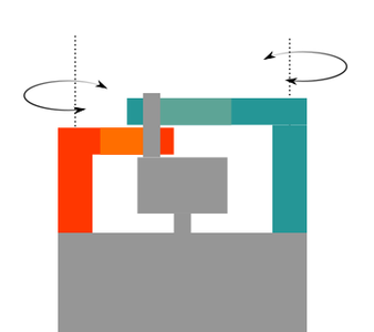

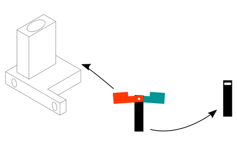

Step 2: Mechanism From Rotation to Oscillation
In order to control the brushes, we need to transform the movement of rotation of the motor to an oscillating rotational movement, the mechanism is described on the picture and on the GIF. Indeed, I measured that the brushes I am using need +-20° of rotation but not more. The 2 output axis (green and orange) are mounted using one screw and a ball bearing and the flexible shafts are glued in the orange and green output axis

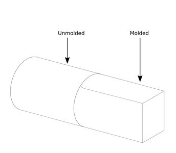

Step 3: The Shafts
The shafts need to be flexible because the second mechanism will bend them to adjust the spread of the 2 brush heads and the flexible shaft allow for continuous rotation event while bending (the bend is kept small as the heads do not need to be very spread). The shaft are made of PLA 3D printer 1.75mm filament which are round but, to engage with the toothbrushes, then need to be squared off. To do so requires to heat the filament (I am using a lighter) and press the softened filament in a square “mold”

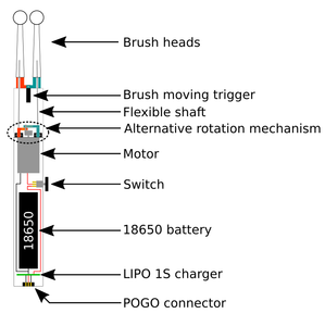

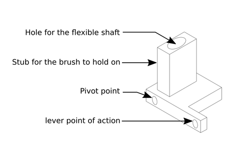

Step 4: Head Spreading Mechanism
This mechanism serves to spread the heads and adjust them to your liking, it is composed of a lever that you move up and down in order to rotate slightly the spread of the heads. The movement is very small (the lever moves ups and down by less than 5mm full range) but since the toothbrushes are quite long (and my jaw not that wide), you get all the tuning range you want out of that little mechanism. The plates onto which the heads are inserted have both the task of guiding the flexible shaft all the way up to the brush but also to allow the movement side to side of each brush. There pivot is held in place by a crimping connector ~2mm in diameter that is glued
