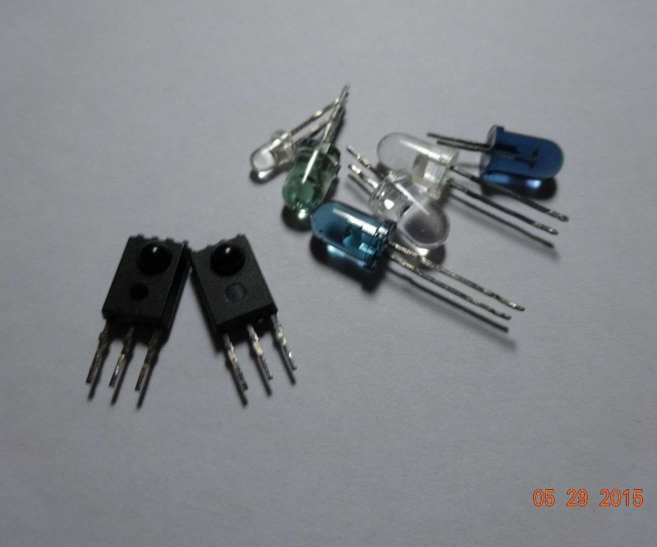

Step 1: Gather the Parts Needed.
Parts list:
  1. 2N3904 transistors x2
  2. 10µf caps x2
  3. Red LEDs x2
  4. 470Ω resistors x2
  5. 100kΩ resistors x2
  6. Assorted jumpers
  7. A breadboard
  8. 9V battery
  9. 9V battery clip
