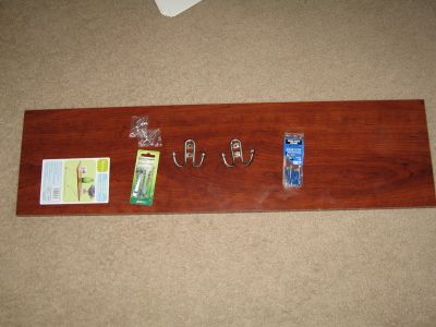

Materials:
Piece of wood to mount your monitors to
Two hooks
Drywall Anchors
Tools:
Drill
Hammer
The materials cost a little under $15 at Lowe's.

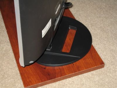

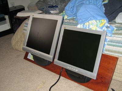

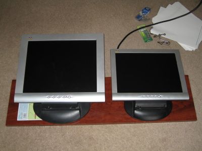

Step 1: Position the Monitors
Lay your board on the floor and set your monitors on it. Then position them where you want them mounted. Mark their positions. I laid the hooks on top of the monitor base to get an idea of where I wanted the hooks.

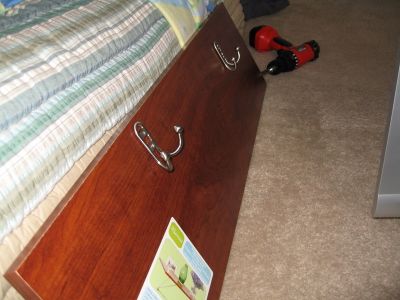

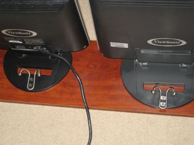

Step 2: Attach the Hooks.
Now, simply attach the hooks to the wood using the provided hardware.
Depending on the thickness of your wood, the screws used to attach the hooks may be poking out the back. To correct this, I just hammered the sharp screw points over to the side.
Next, nail two of the picture mounts to the back of the board. Make SURE they are level with each other. I chose to mount them in the same line as the hooks, so the weight would be centered over each mount.

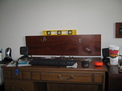

Step 3: Install Anchors

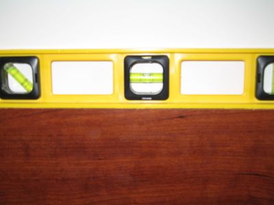

The next step is to install anchors into your drywall. Be sure to make measurements so that the wood will be centered where you want it and that you space the anchors the right distance apart for the mounts.
It is very important that these two screws are level with one another.
For best results, install these screws into studs. I do not have a stud-finder and didn't feel like putting a bunch of holes in my wall until I found one. If you have the correct drywall anchors, then you won't have any problems.

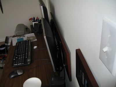

Step 4: Attach Wood to Wall.
Just as the title says, now just hang your wood on the wall.
I found it easier to hang the monitors after the wood was already on the wall.

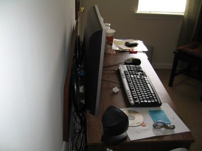

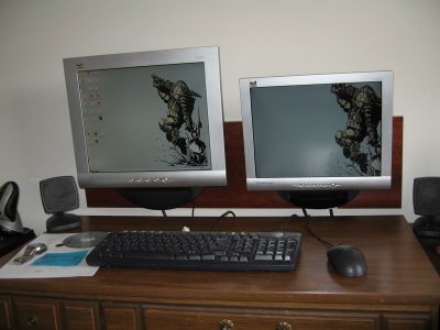

Step 5: Hook Up Equipment
Hook your monitors back up and hang them on the hooks. It's going to be a little tricky since the cords are going to want to come out the same slit, but it's doable.
And you're finished!
Now I have so much more room on my desk.
