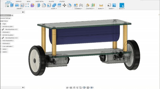

Step 1: Mechanical Design for Robot's Base PCB
I first prepared a simple double-wheeled robot in Fusion 360, the whole model was made around the Micro Gear Motor.
I prepared a Base Board of size 95mm x 36.2mm, which was later utilized in the PCB design.
The motor is added to the base by using two motor mounts that we 3D print and later attach with PCB standoffs to the base body.

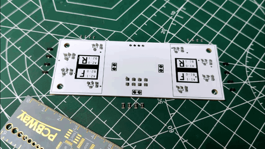

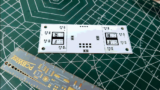

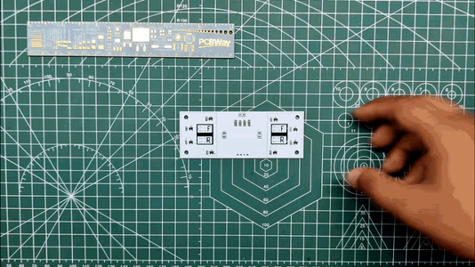

After finalizing the schematic, PCB was prepared by following the outline provided by the mechanical design of the robot.
Step 3: PCBWAY
After preparing the PCB and exporting the Gerber data, we sent it to PCBWAY for samples and placed an order for a white solder mask with a black silkscreen.
I received PCBs within a week, and they were excellent, as expected.
White PCBs look great with black silkscreen in general.
I love the quality of PCBs made by PCBWAY. There are other manufacturers available, but their service is always on another level.
check out PCBWay service for getting great PCB service at less cost.

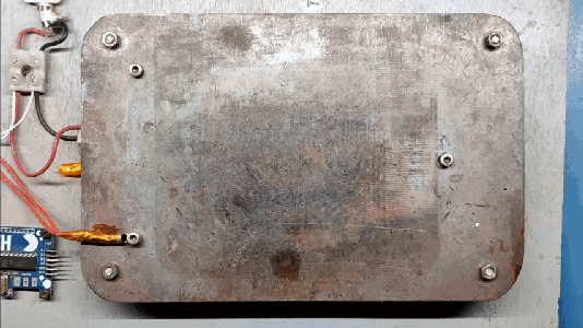

Step 7: Hotplate Reflow Process
After the "pick and place process," we carefully lifted the whole circuit board and placed it on my new Mini Hotplate.
https://www.instructables.com/PCB-Hotplate-Mini-Edition/
The hotplate heats the PCB from below up to the solder paste melting temperature. As a result, the solder paste melts and components get solder on their pads.

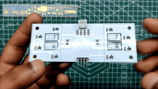

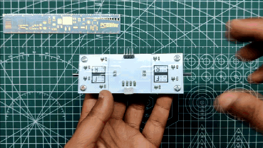

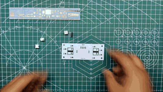

Step 8: THT Components

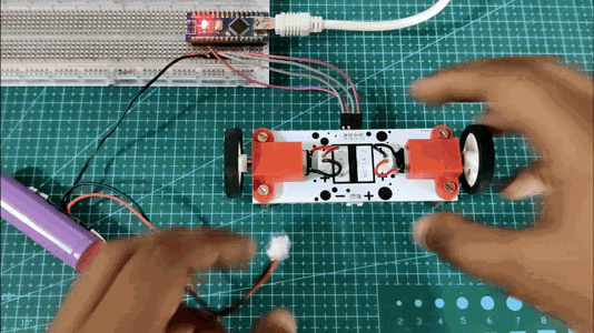

Next, we add header pins to this board: vertical male header pins for connecting this setup with an Arduino board for testing, JST connectors for connecting two motors to FETS, and one for adding a 3.7V Li-ion cell.

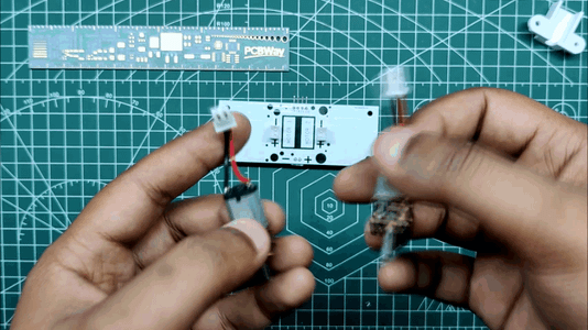

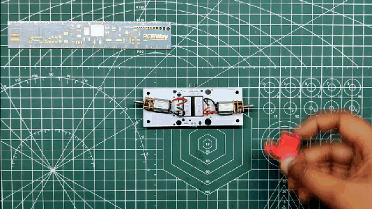

Step 9: Adding Motors
After adding THT components to the board, we connect both motors with the JST connectors.
I already soldered male JST wire harnesses to both motors, so we can easily add them to the base PCB without doing any soldering work. this makes assembly a lot easy.

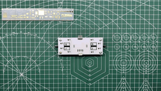

Step 10: Motor Holder
Next, to hold motors in their place, we add 3D Printed Motor Holders with help of four M3 Screws, these screws will later be replaced by PCB standoffs for adding a second layer to this base. the second layer will contain the Microcontroller setup which is yet to be finalized.

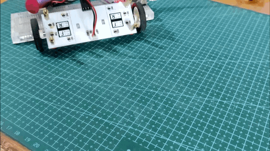

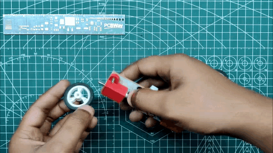

Step 11: Adding Wheels
I have purchased small wheels for micro motors that were used in a previous project which was this-
https://www.instructables.com/Micro-Fighter-BOT-With-Bluetooth/
I repurposed those wheels and used them in this design.
These are regular plastic rims that have a rubber wheel which is great for gripping the surface and running smoothly without oversteering that happens a lot if the wheel is made from completely plastic material.

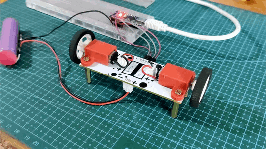

Step 12: Arduino Setup
As for the current setup, we need to add an external microcontroller for testing the board.
I used an Arduino nano for controlling the gates of MOSFETs.
D2, D3, D4, and D5 I/O pins were connected with the FETs gate along with an additional GND Pin which is connected with the GND of Arduino.
Power to the Motor driver was provided by a single Li-ion cell which was connected to the Baseboard through a JST wire harness.

We upload the above sketch into the Arduino Nano, and the H-bridge works.

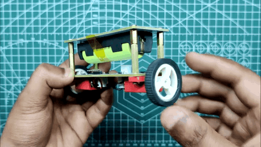

Step 14: What's Next?
The second part or level of this project is to make a microcontroller layer that will have an MCU connected on the top side and a Li-ion cell holder on the bottom side.
There will also be an MPU6050 sensor for obtaining accelerometer readings so that this robot can stand still on two wheels.
I already made a similar self-balancing robot in the past and will be using slightly modified code from that project in this bot.
