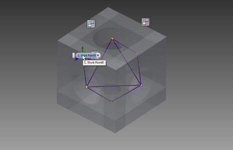

Each face of our cube has a center point, conveniently highlighted in yellow (because we Projected the origin in our original face sketch). Each is a corner of the cube's dual polyhedron: an octahedron. To construct this dual we just need to connect those points: lines between them are the octahedron edges. Annoyingly, you can't do this in an Inventor Assembly; we need to get back to a Part file before we can sketch in 3D. Because the documentation on this seemingly simple task is out of date, this took me a long time to figure out; but it's pretty easy, plus you get your new octahedron separated out in its own part file.
Here's how to do it in Inventor 2015: add a new empty part to your assembly from the Assemble->Product->Add Part menu. Double-click on your new part, this will gray out the cube because you are editing your new Part. Start a 3D sketch from the Sketch menu. Add edge lines between all the vertex points (face centers), the line tool will snap to each point and your line will turn constrained blue as shown. Only connect edges, so each vertex is connected to exactly four of its near neighbors: don't connect opposite corners through the center of the octahedron. Once again rotating your view helps to see where the neighbors are.
Step 8: Convert the Octahedron 3D Sketch to a Solid
Once you've added all the edges, it's time to convert them into a solid. Finish the 3D sketch, then convert each triangular face into a patch by selecting the Patch tool in the 3D Model tab, and selecting the three edges of a face. Unselect the "Automatic Edge Chain" checkbox here. You will need to rotate around your model to get all the faces, as it's hard to see which faces have been completed because the patches are transparent. (There's likely a way to change this visibility but I haven't found it).
Once all the faces have been Patched, you can Stitch them all into a solid using the Stitch tool in the 3D Model tab. If you missed a face, it will complain: no worries, just make sure all the faces have a Patch. Then you can go ahead and save your new octahedron part, and go back to your cube Assembly.
