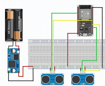

Step 1: Building the Circuit
Hardware Assembly Instructions:
Let's start by assembling our hardware components! We'll connect two HC-SR04 ultrasonic sensors to our ESP32:
  1. Sensor 1:
  2. TRIG → GPIO 04
  3. ECHO → GPIO 02
  4. Sensor 2:
  5. TRIG → GPIO 05
  6. ECHO → GPIO 34
The LM2596 buck converter will regulate power from our 3.7V lithium battery to a stable 5V/3.3V for the ESP32.
Pro Tip:
  1. Use a breadboard for prototyping before making permanent connections.

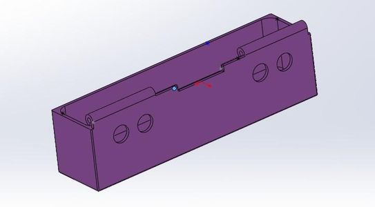

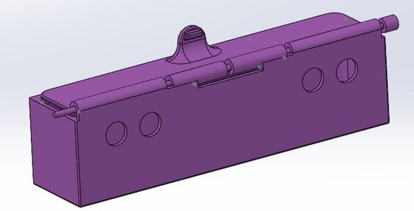

Step 5: 3D Design
  1. Main Box
  2. Holds ESP32 and sensors
  3. Has special holes for the pivot stick
  4. Designed for easy wire management
  5. Cover Plate
  6. Simple flat piece
  7. Has matching holes for the pivot stick
  8. Clicks or screws in place
  9. Pivot Stick (Long Rod)
  10. Long rod shape (like a chopstick)
  11. Fits through holes in both other pieces
  12. Lets the main box rotate while cover stays fixed
