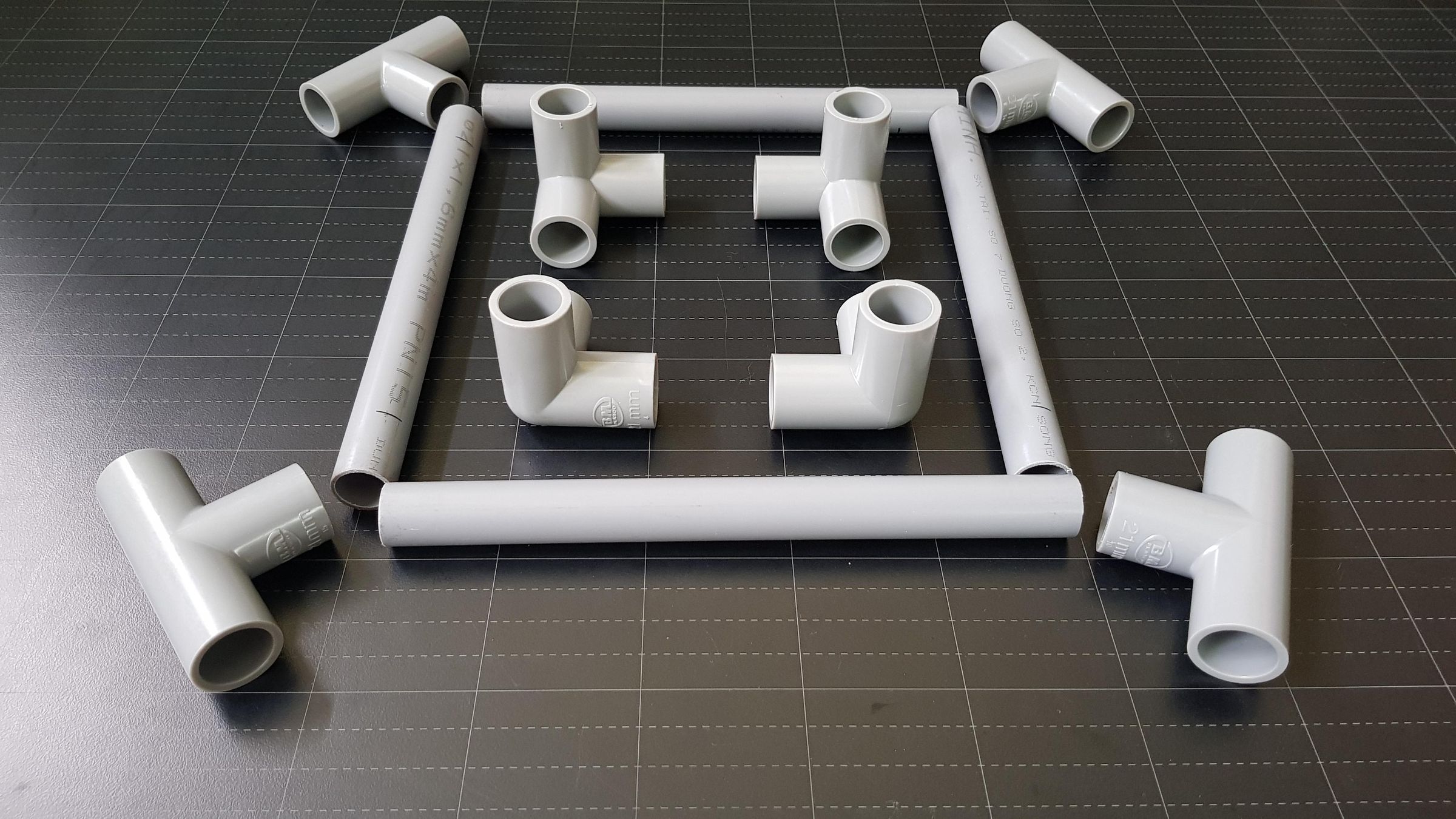

b. PVC pipes and fittings:
⦾ 14pcs x PVC Pipe Tee Ø21mm.
⦾ 16pcs x PVC Three Way Tee Ø21mm.
⦾ 4 meter x PVC Pipe Ø21mm.

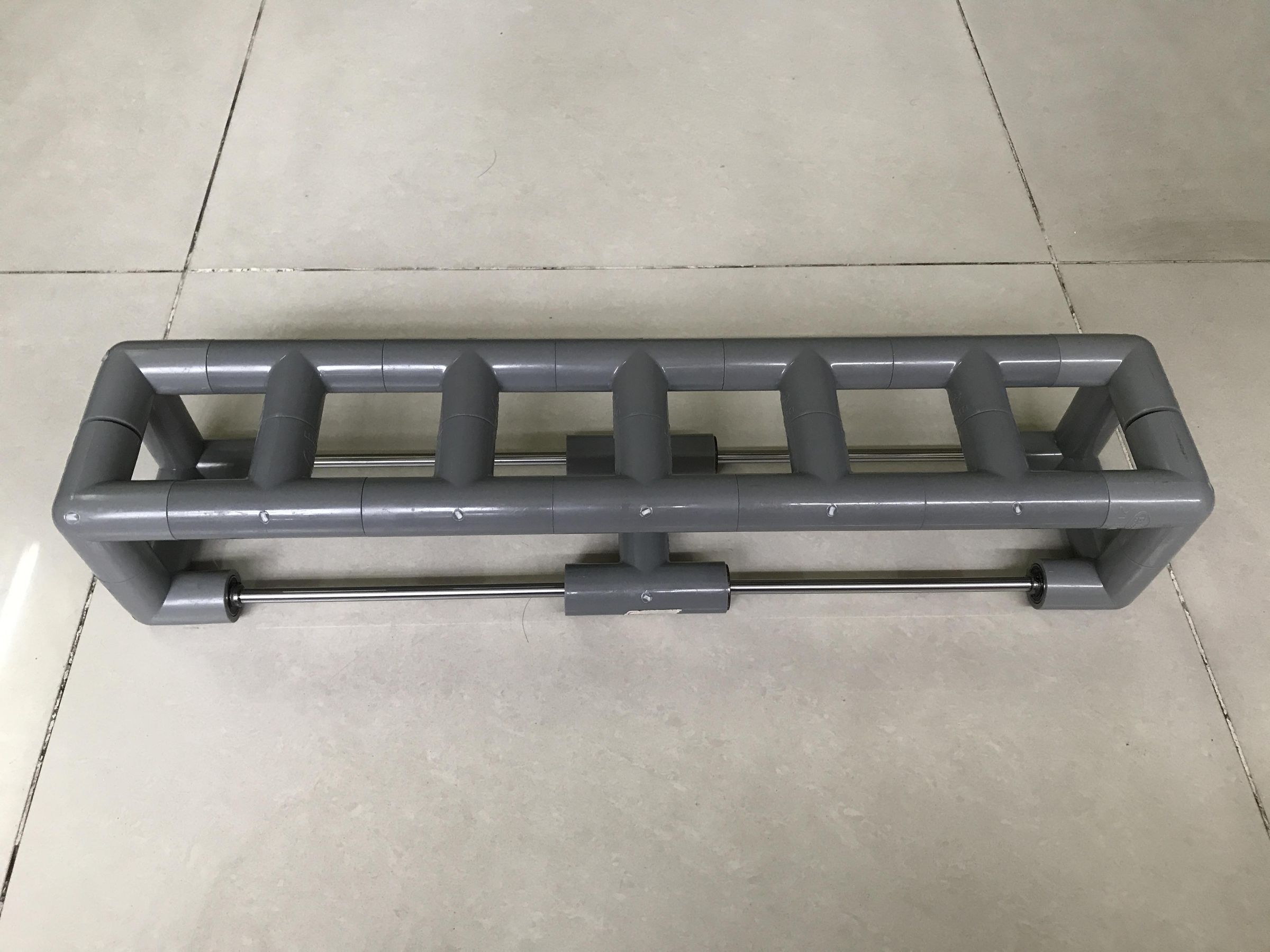

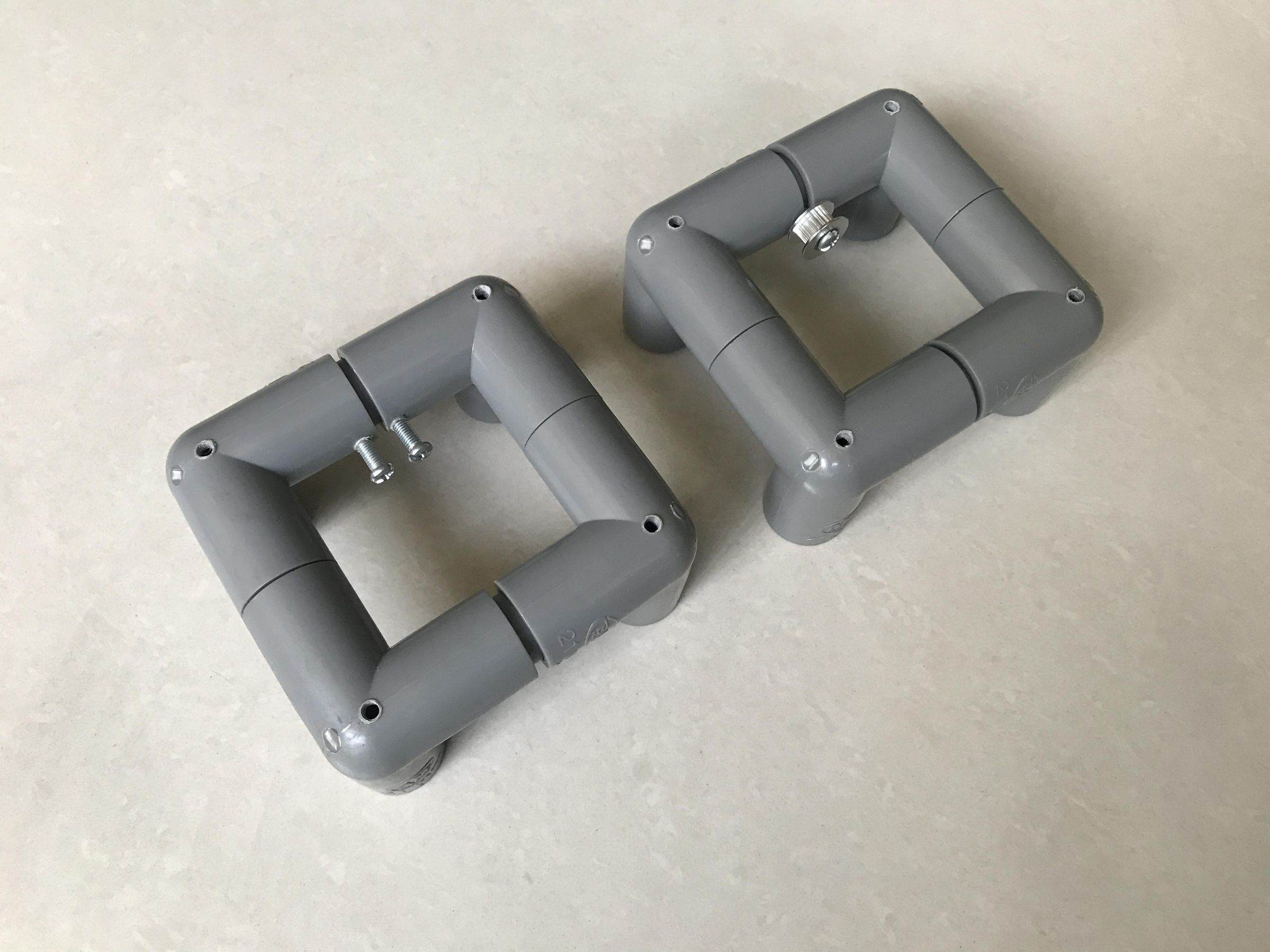

Step 3: Fixed Frame - Y Axis

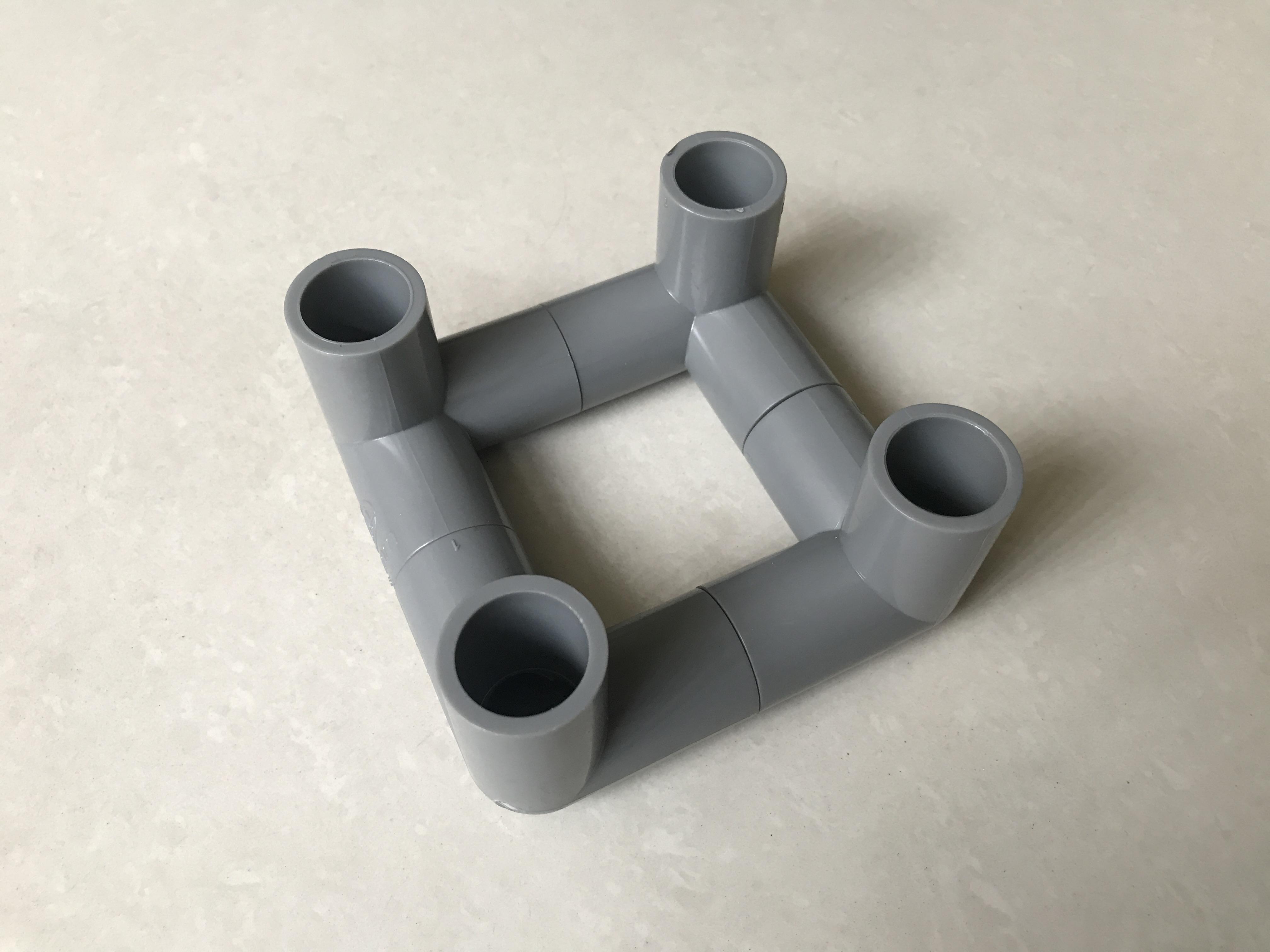

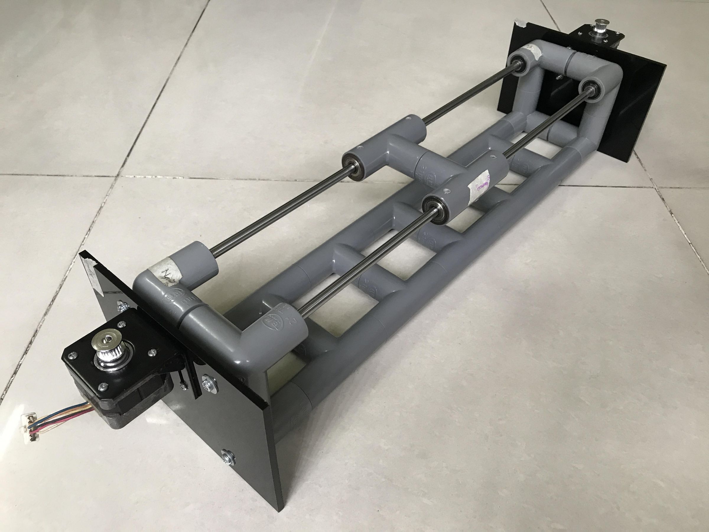

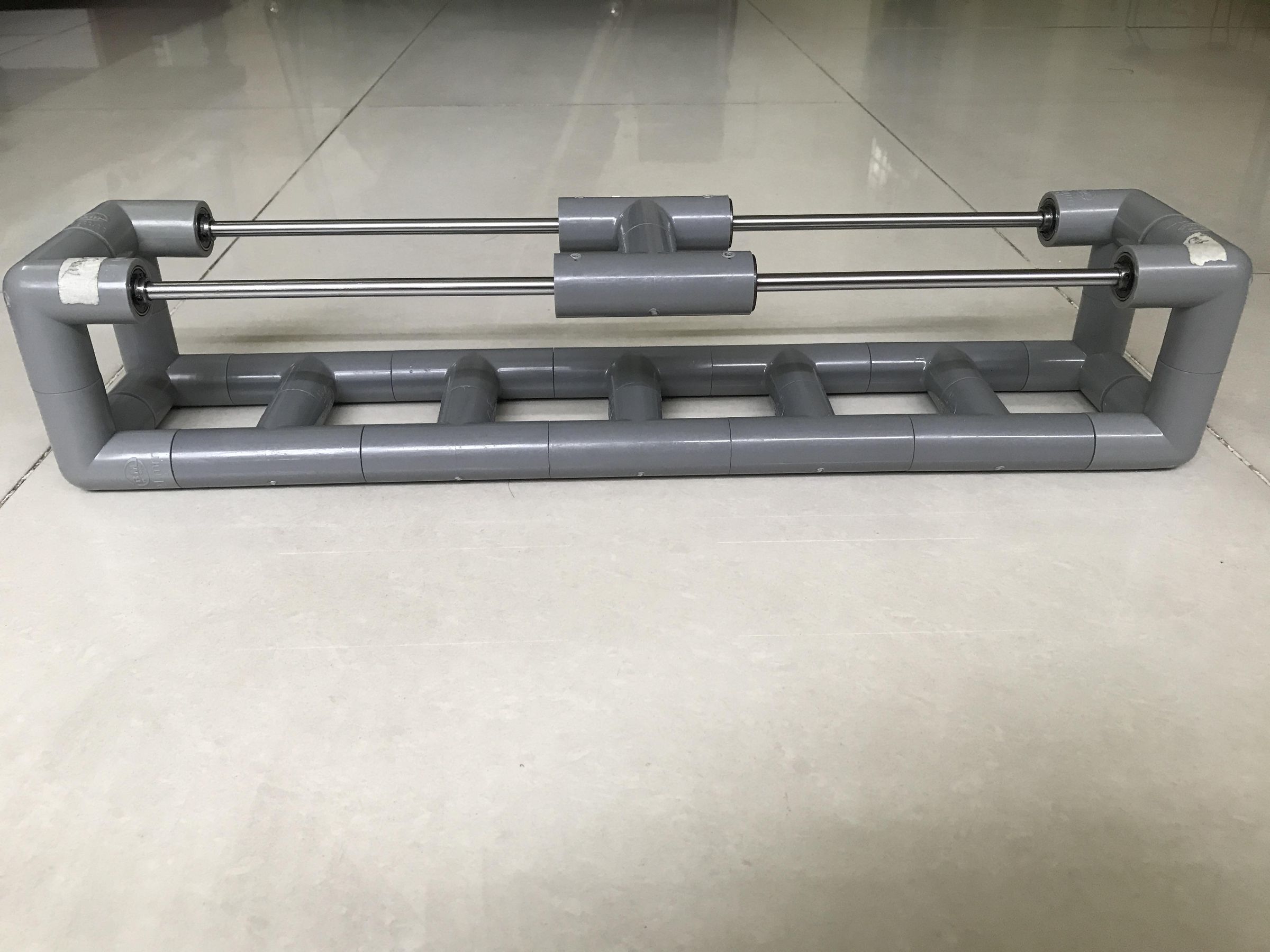

Firstly, I joined 4 pcs x PVC three-way tees Ø21mm together. I made two sets like that (called Y supports) for 2 ends of the Y axis. Later, two stepper motors X and Y would be mounted on them.

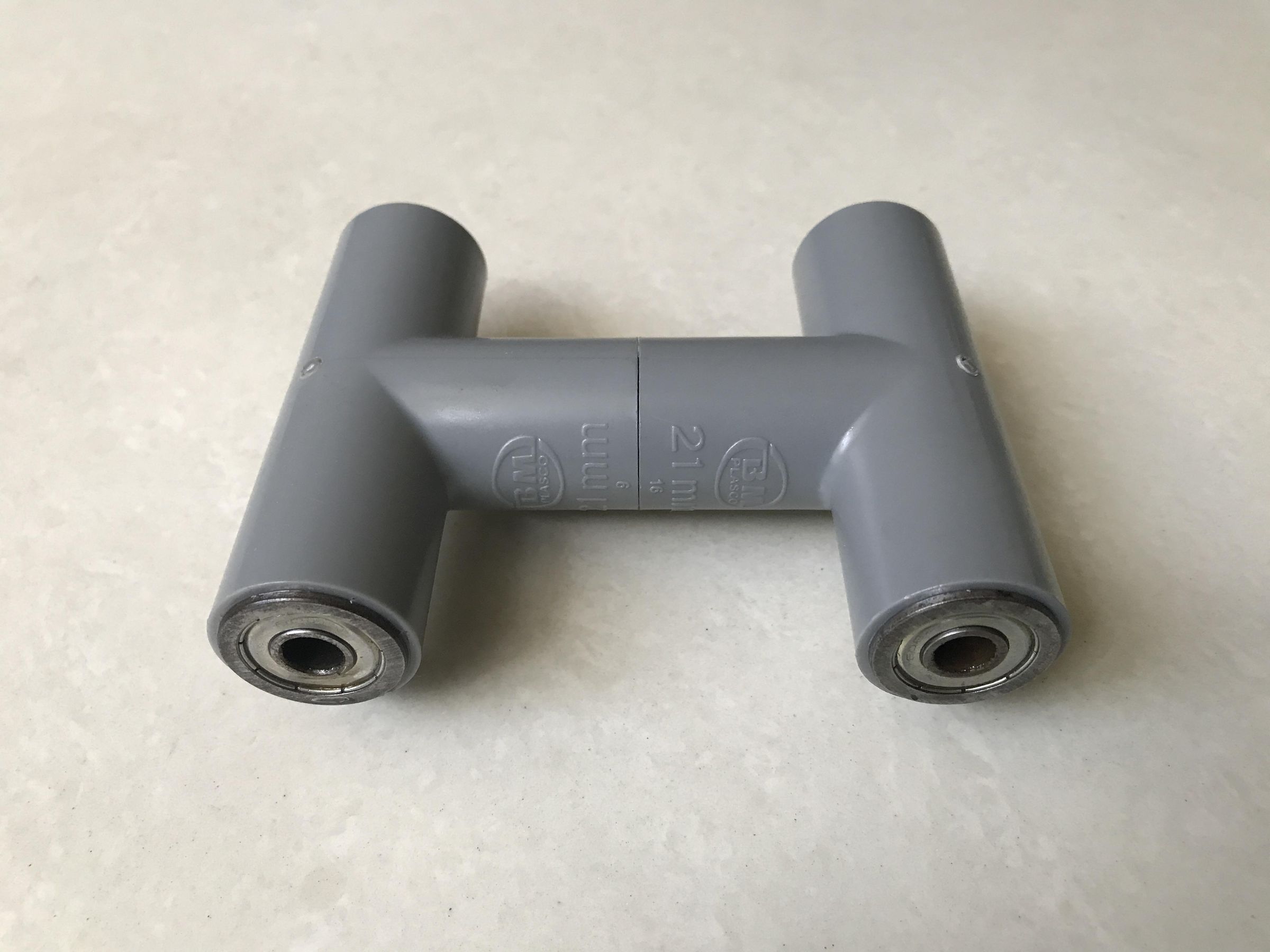

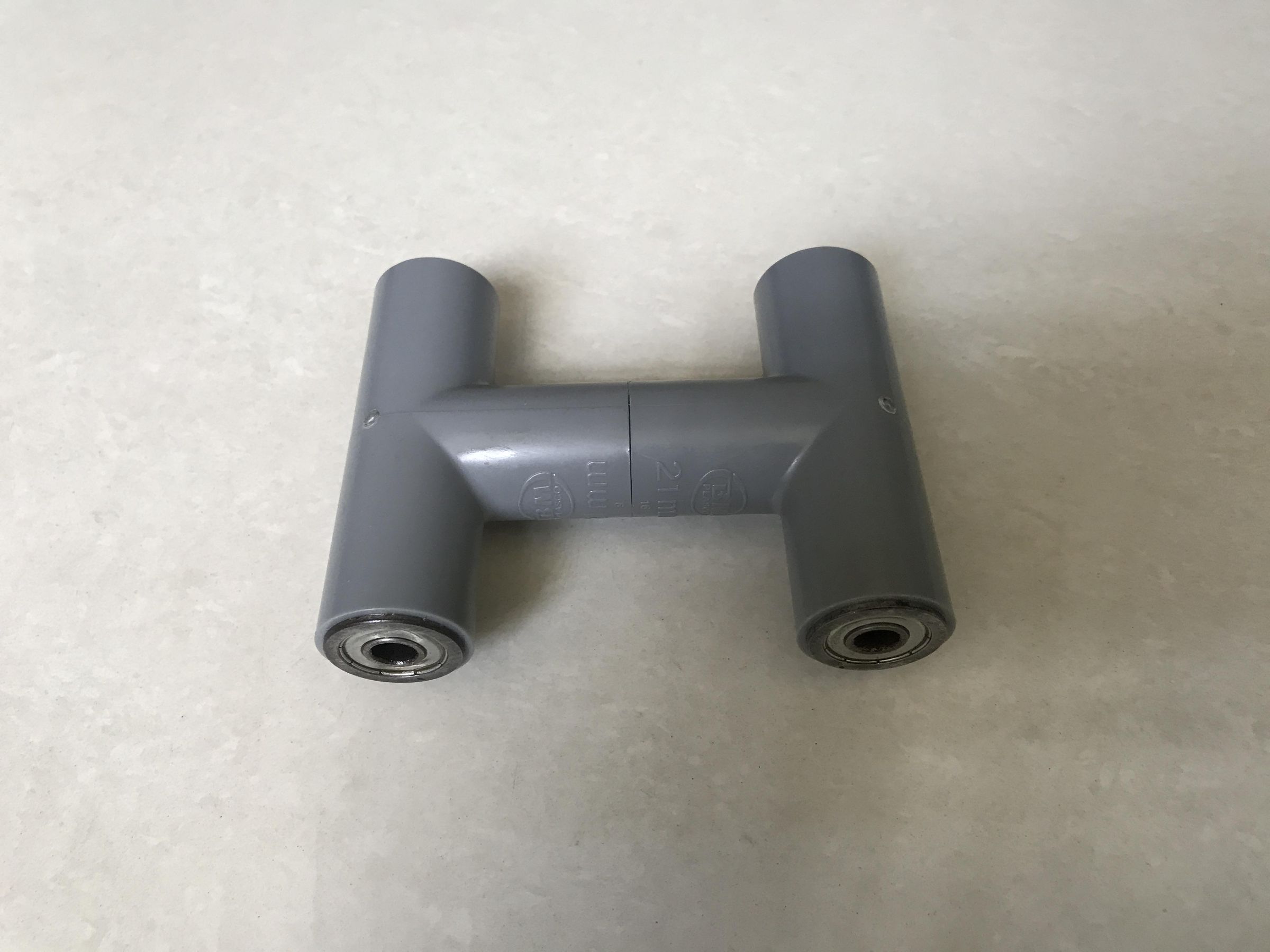

To build Y slider, I connected 2 pcs x PVC tees Ø21mm together and inserted ball bearings into 4 ends of this assembly.

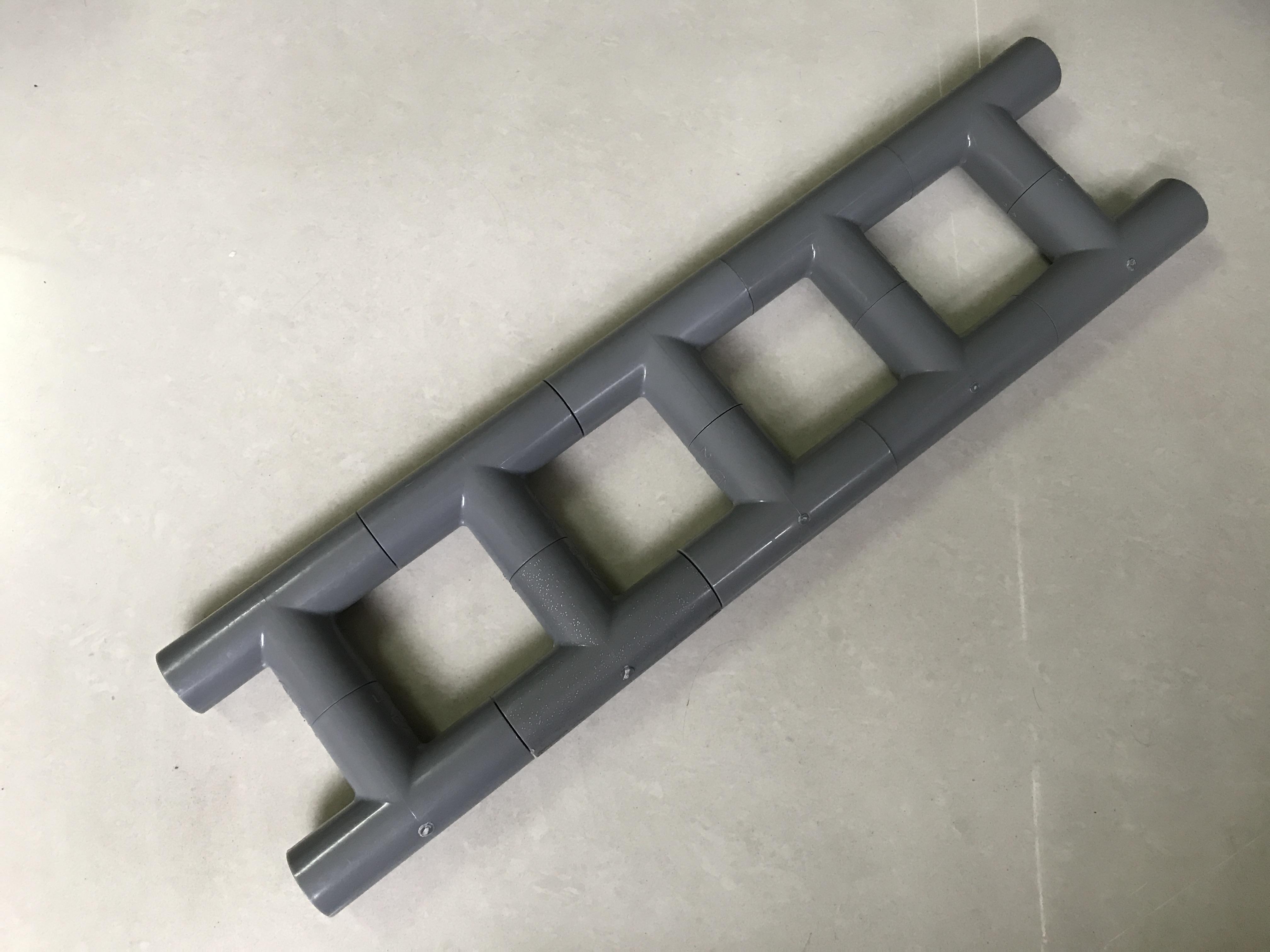

Then I jointed 10pcs x PVC tee Ø21mm together. It was not only used to connect two Y supports, but also used as a footbase for my CNC DrawBot.
There're 4 open holes for each Y support. I inserted locked bearings into 2 open holes of each assembly. I threaded 2pcs x T8 shafts, length 500mm through Y slider and they were fixed by two Y supports at open holes with locked bearings. To keep the frame strong enough, the remaining two open holes of the Y supports are connected to 10-tees support assembly above.
The bottom view of Y structure.

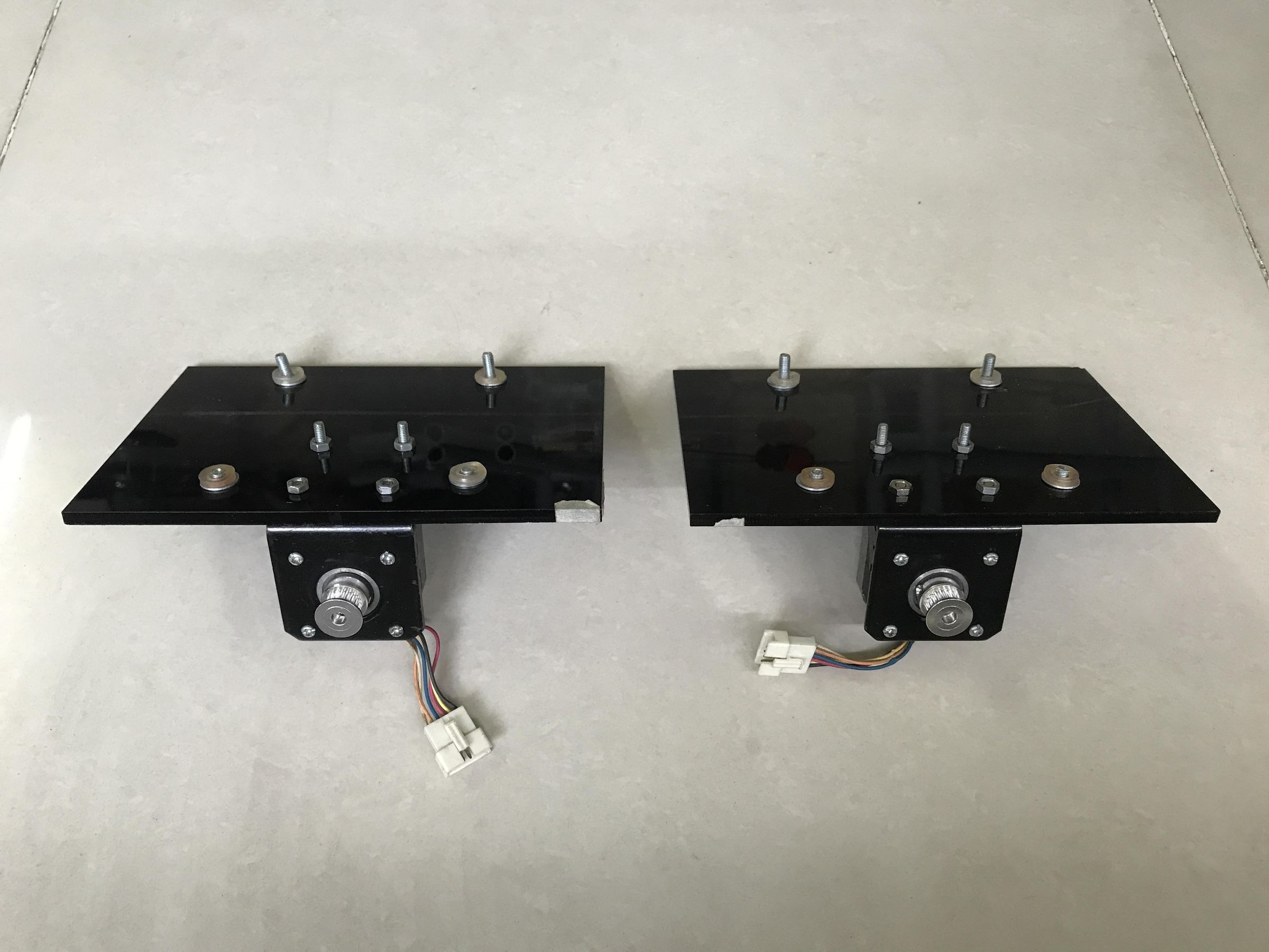

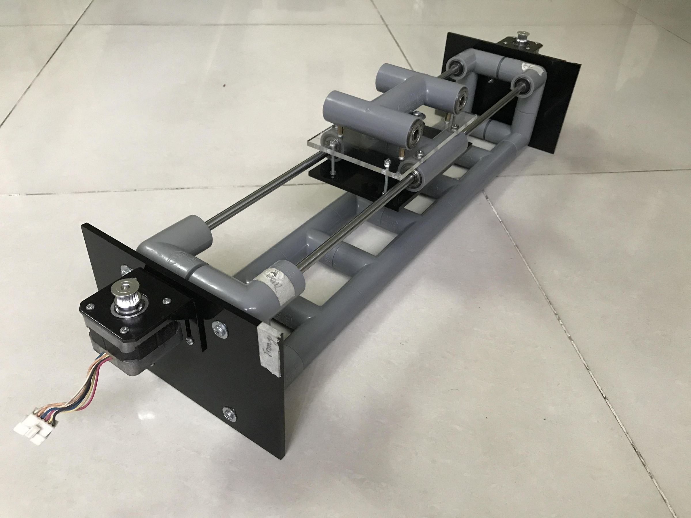

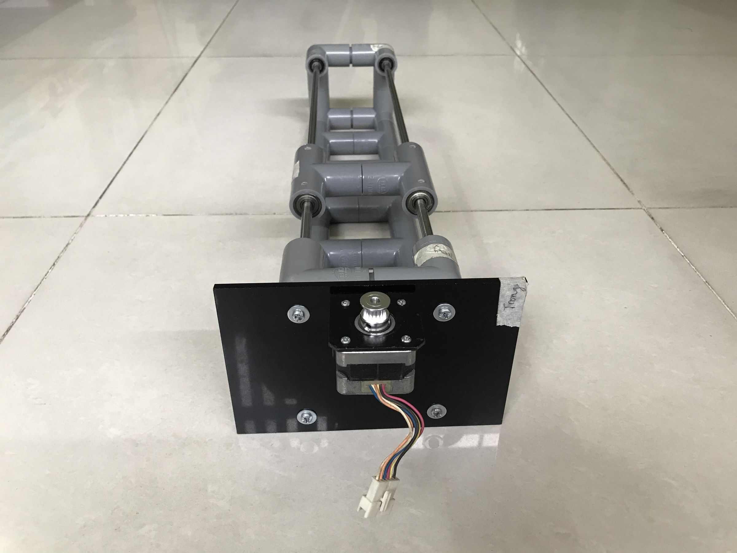

Step 4: Mounting X & Y Stepper Motors

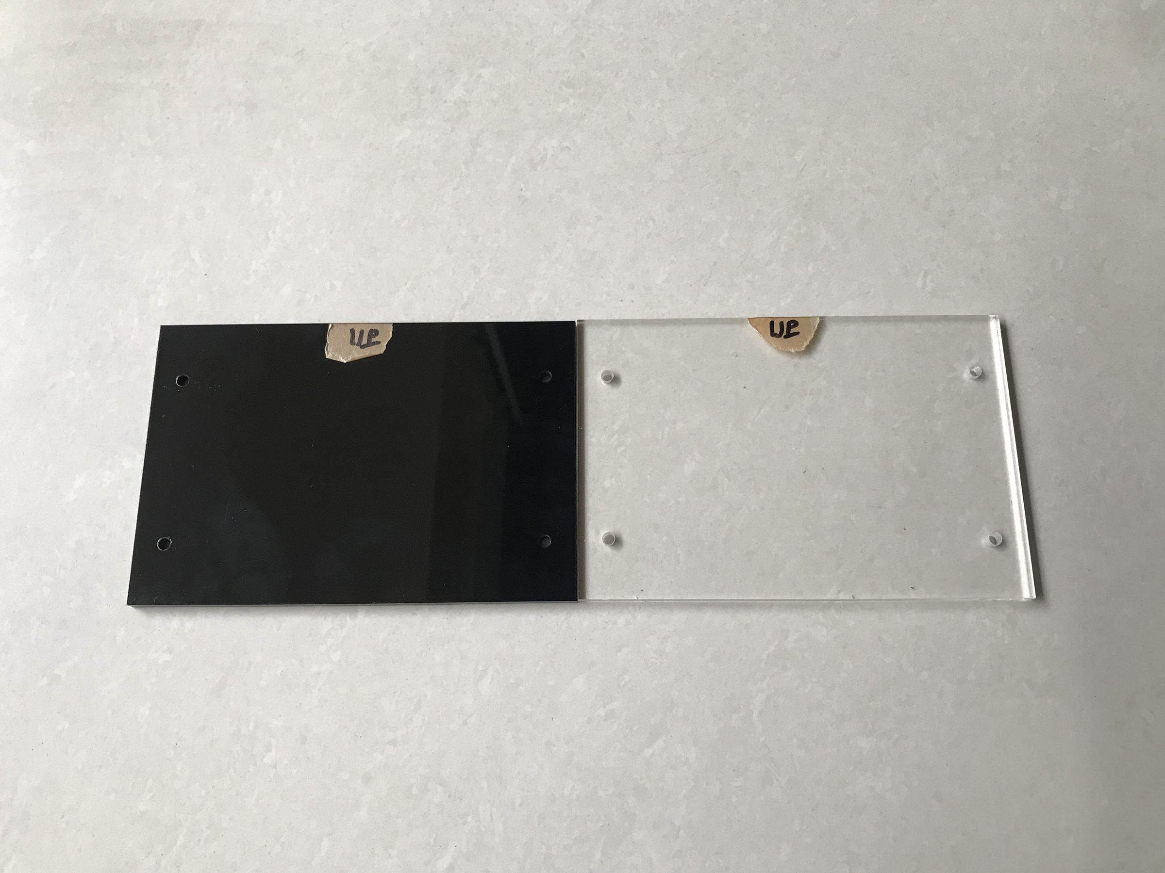

I cut 2 acrylic sheets, dimension L180 x W120 x T5mm and drilled 8 holes. Four holes were used to mount stepper motors by L supports and the other for connecting to Y supports.
I drilled 4 holes in each Y supports corresponding to 4 holes on the acrylic motor supports above.
The first acrylic support was mounted to Y axis frame at one side.
And the second acrylic support was done in a same way at opposite side. The bottom level of PVC frame and acrylic sheets should be the same, making sure that both rested on a flat floor.
These acrylic sheets keep the DrawBot from falling down when the X axis moves far away from the DrawBot's centerline. They also fix the Y pipe supports, pulleys and shafts do not move when the DrawBot is in operating.

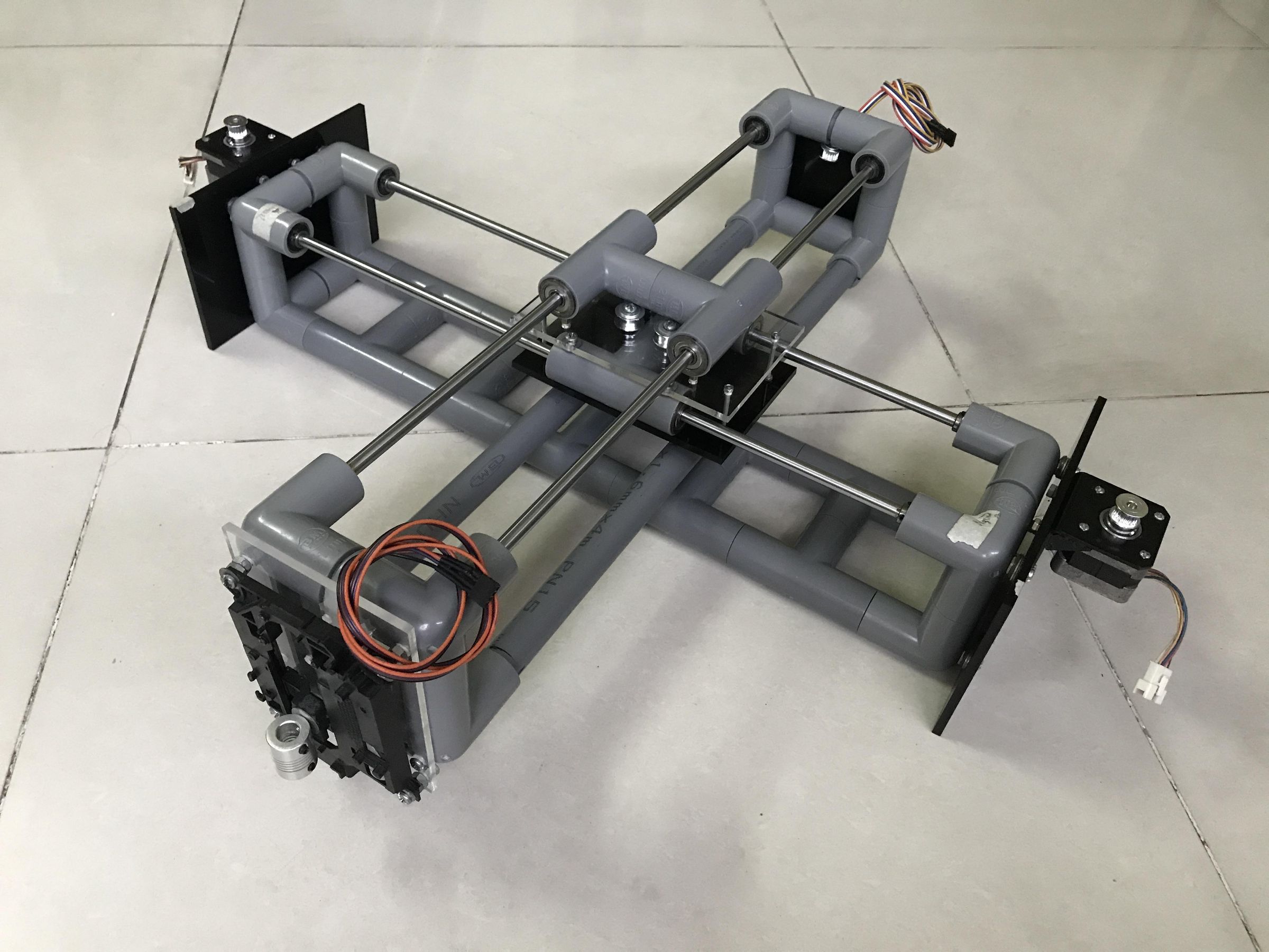

Step 5: Moveble Frame - X Axis

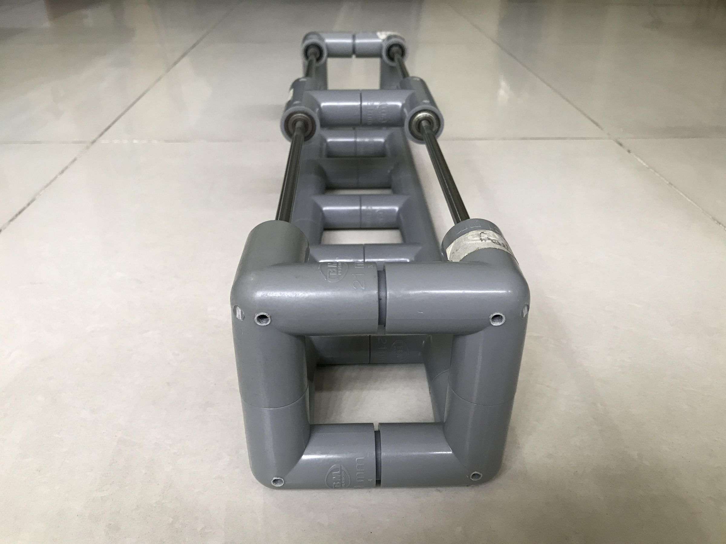

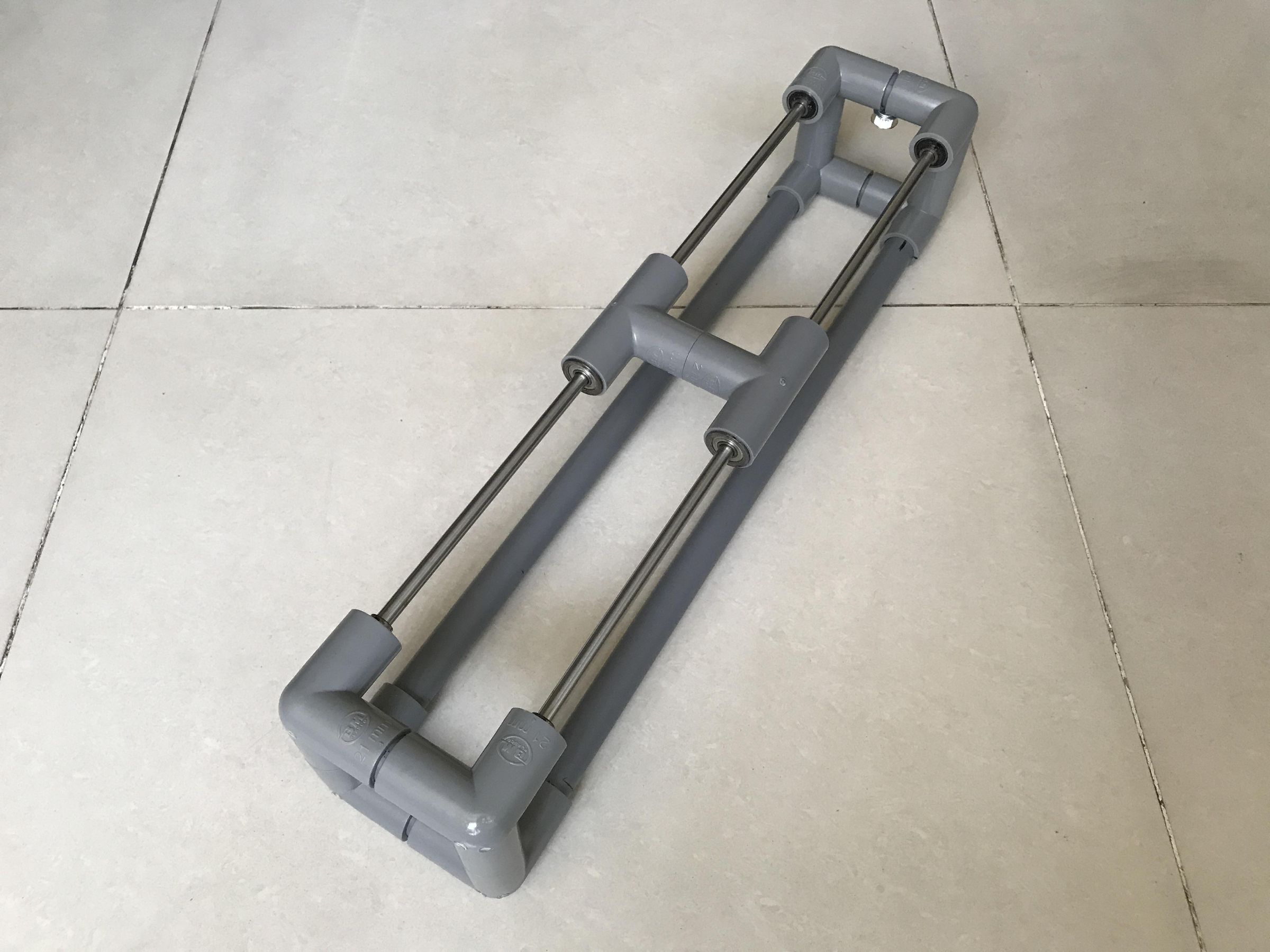

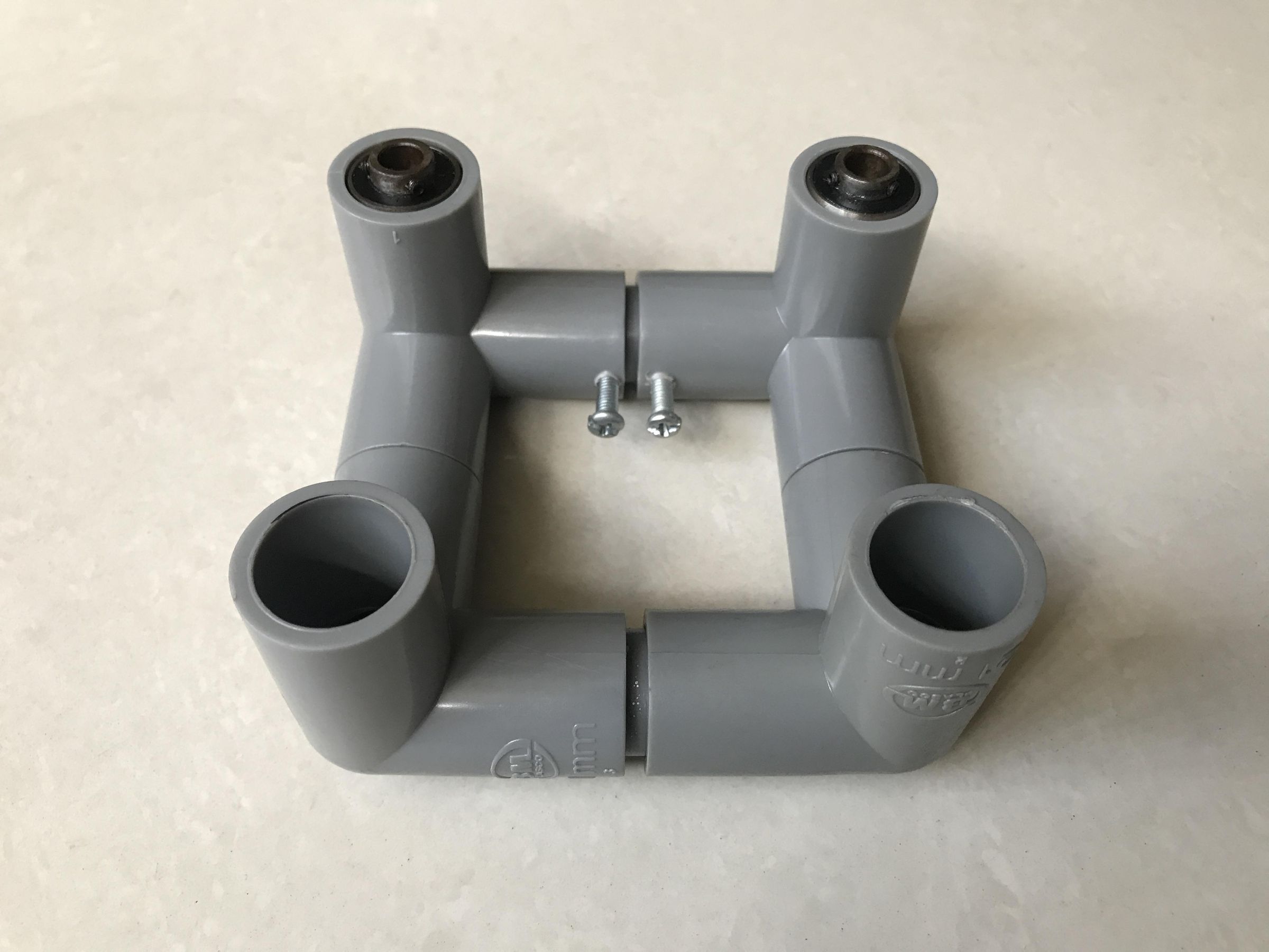

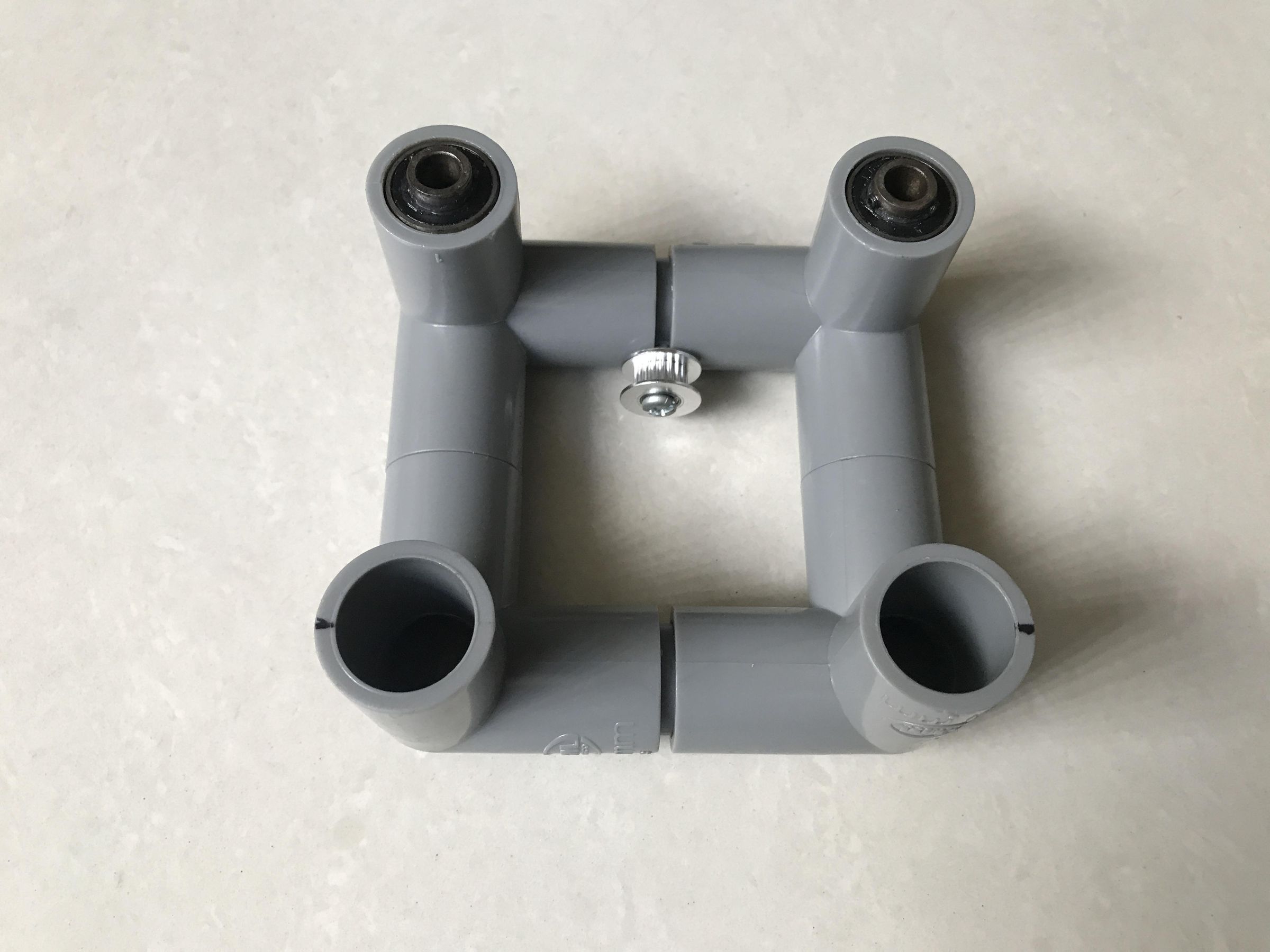

Same as Y axis, I made two sets of X supports which were built from 4 pcs x PVC three-way tees Ø21mm. Detail’s as follow:
⦾ The first X support: inserted lock bearings at 2 open holes, and installed one idler timing pulley 20 teeth as below picture:
⦾ The second X support: inserted lock bearings at 2 open holes, and installed two bolts M4 – L20mm. The distance between them was equal to the diameter of idler timing pulley 20 teeth - about 12mm. They were used to fix the belt system.
X slider was contructed from 2 pcs x PVC tees and ball bearings were inserted into 4 ends of this slider.

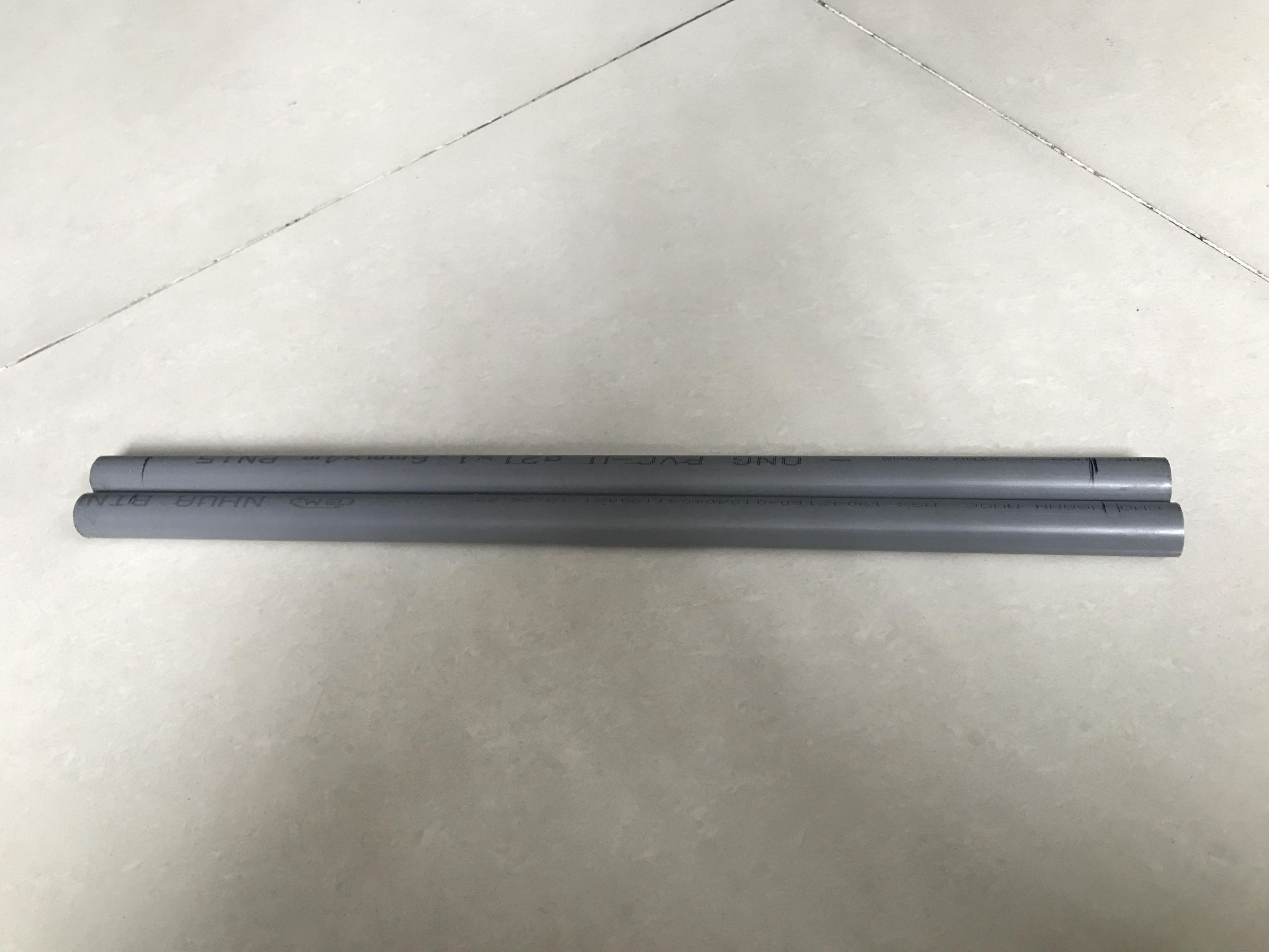

Then I cut 2pcs x PVC pipes Ø21mm, length about 500mm.
I threaded 2pcs x T8 shafts, length 500mm into X slider and they were fixed by two X supports at open holes with lock bearings. To reinforce the X frame, the remaining two open holes of X supports were connected to 2 pipes Ø21mm above.

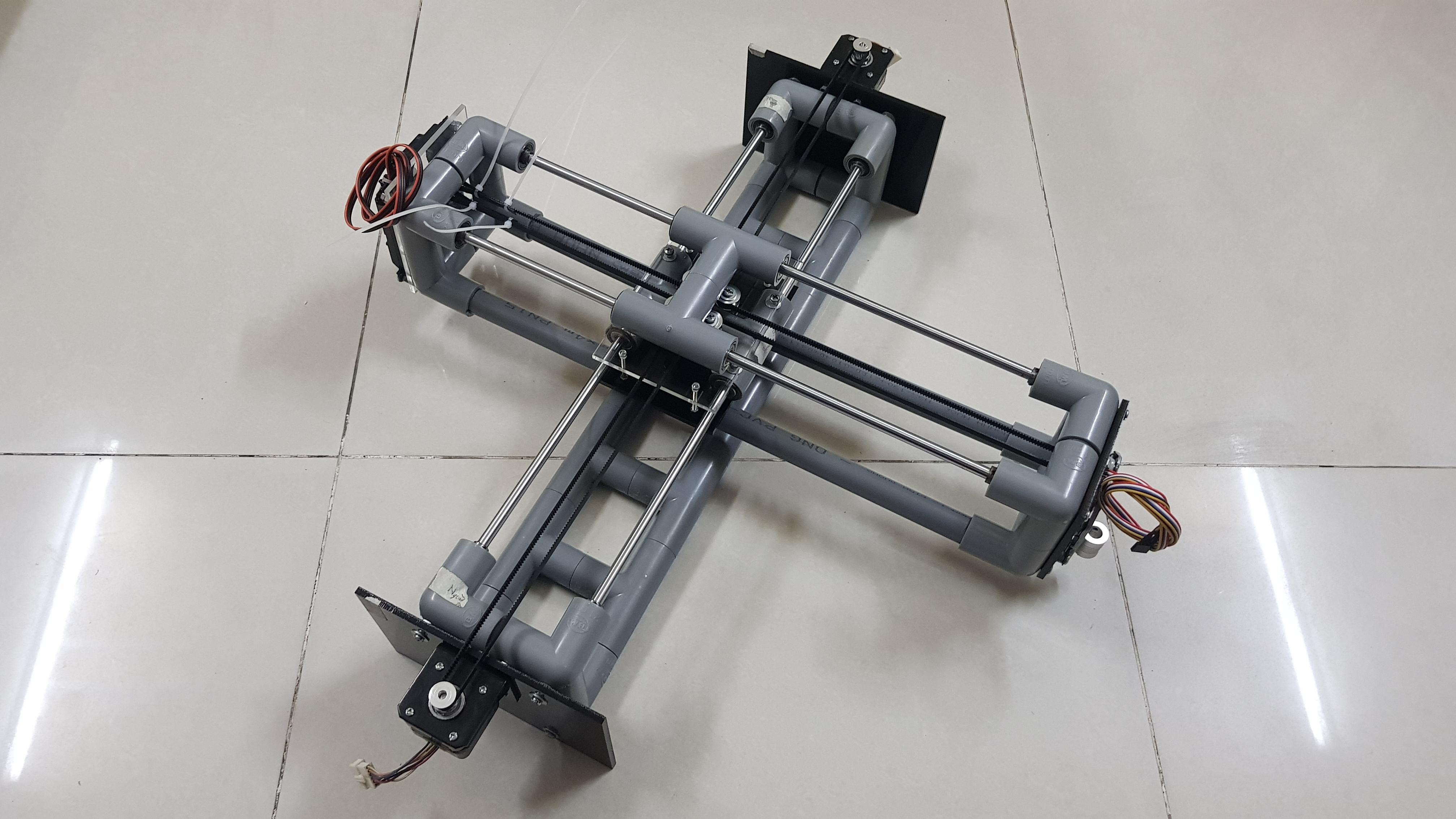

Now I had 2 main seperated parts of a DrawBot.

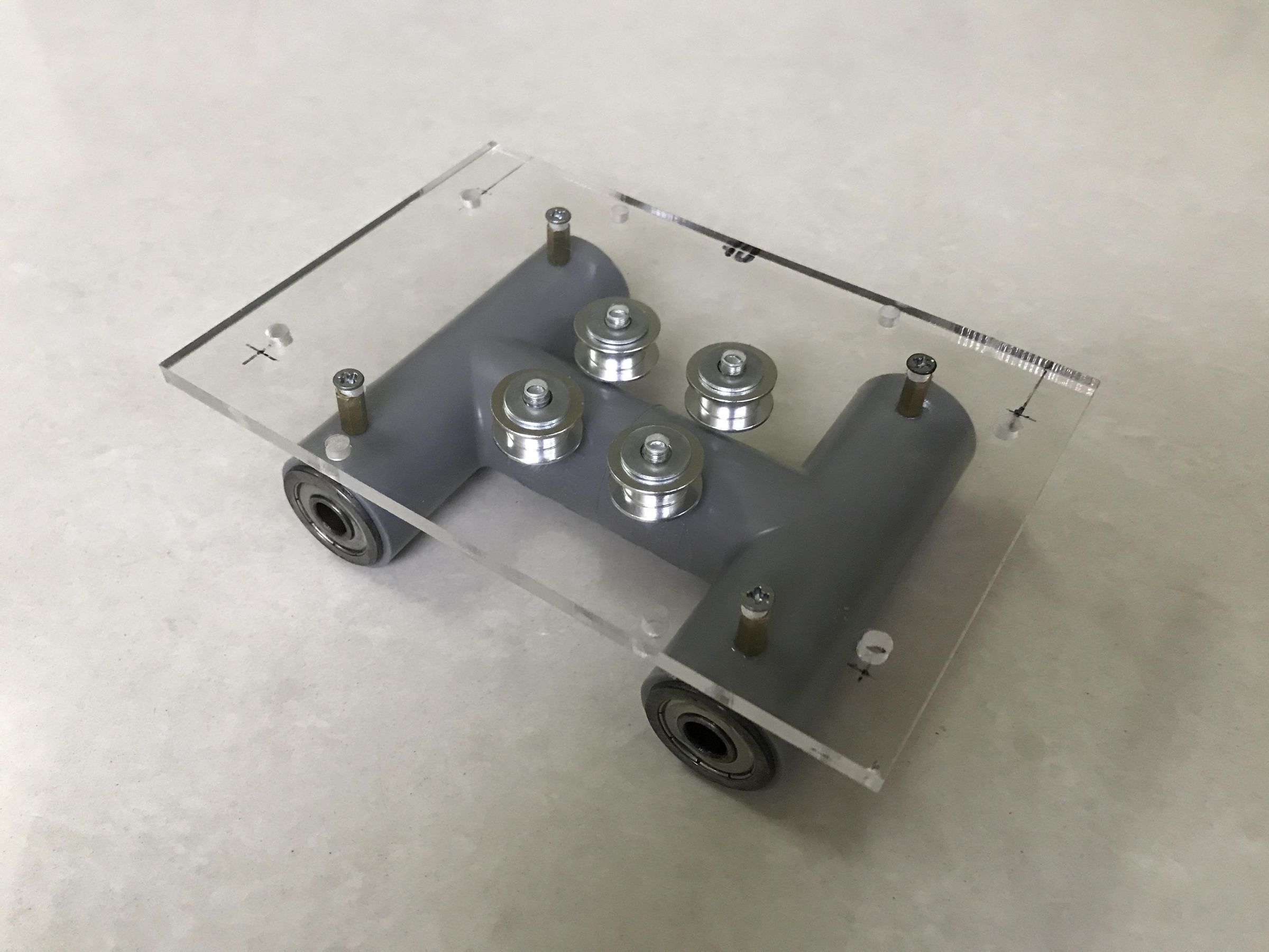

Step 6: Belt Support

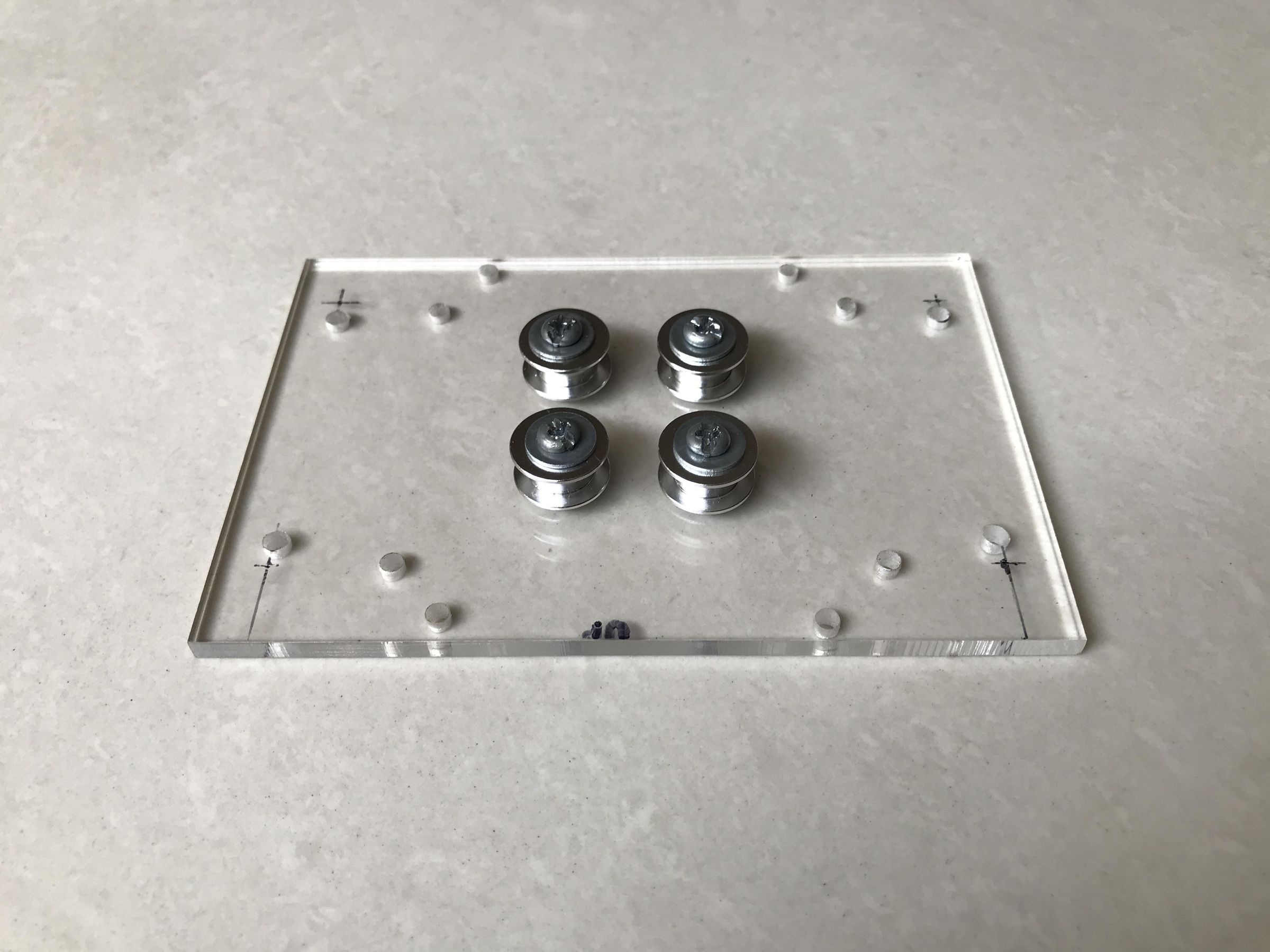

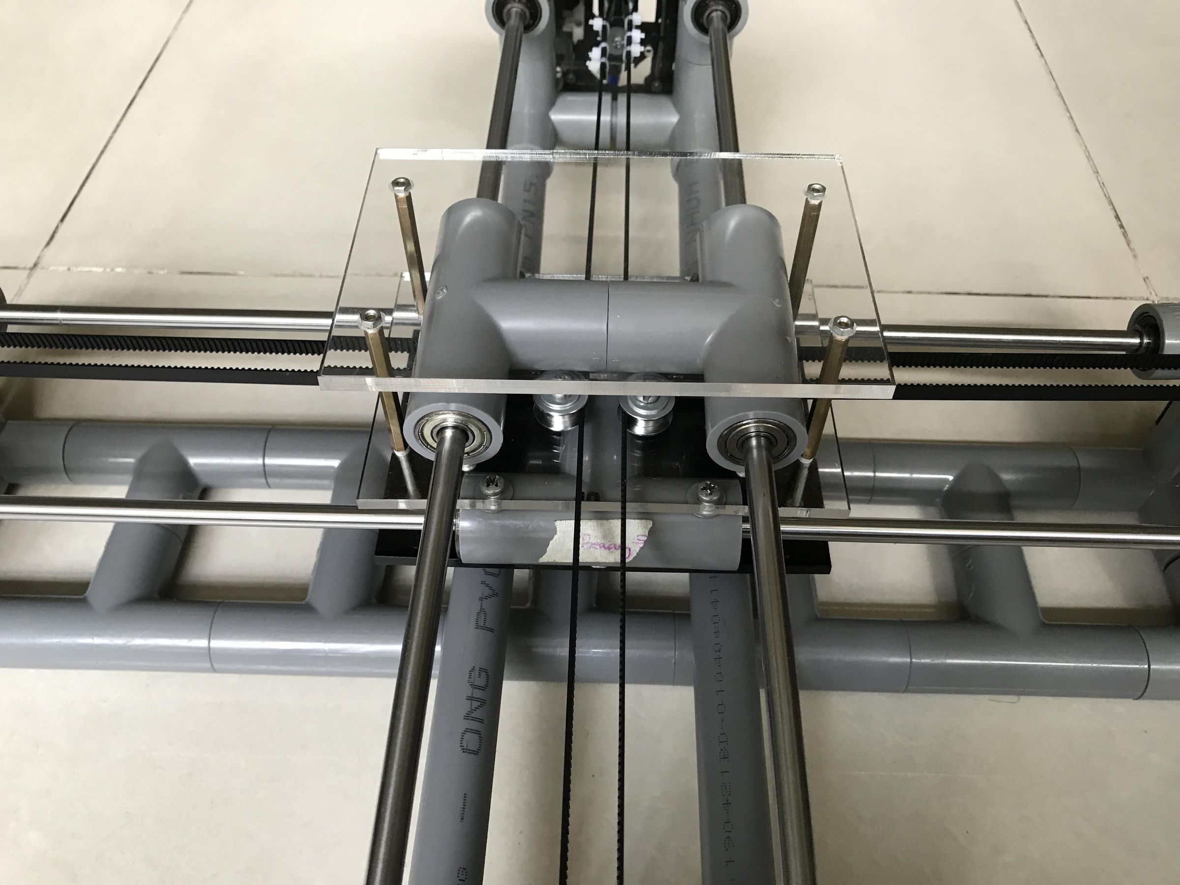

I cut an acrylic sheet, dimension L120mm x W120 x T5mm, drilled and installed 4 toothless idler pulleys in the center. The distances between them were still 12mm.
I disassembled X & Y sliders from their PVC frames, then did following works:

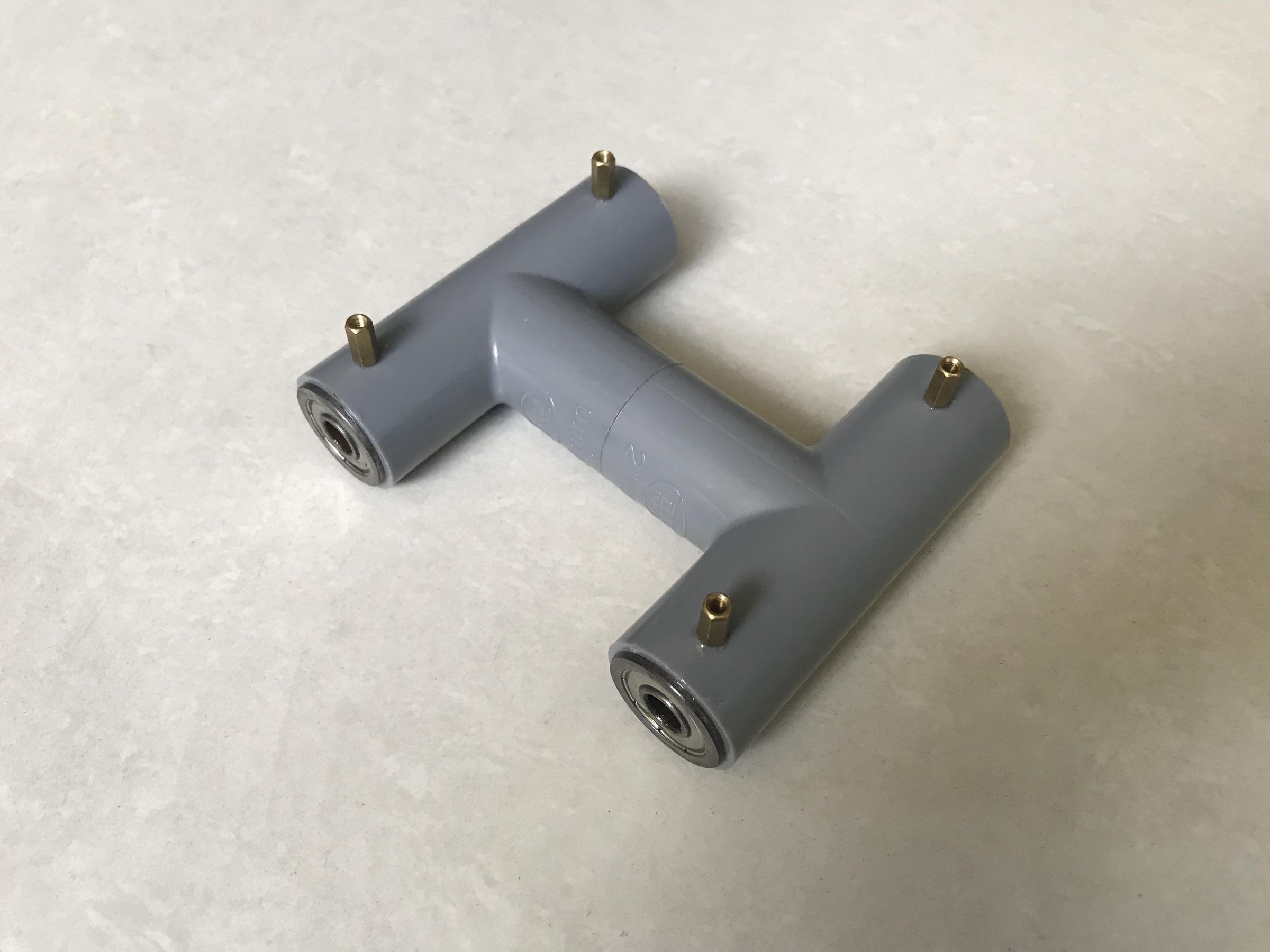

⦾ X slider: drilled 4 holes at bottom and connected 4 copper brass pillar L-10mm on these holes.
⦾ Y slider: drilled 4 holes on top.
Connect X slider to acrylic belt support through 4 copper brass pillars.
Cut 2 more acrylic sheets which had same size with acrylic support above (dimension L120 x W120 x T5mm)
⦾ Black one: reinforce the slider system and it was install at Y slider bottom.
⦾ Clear one: mount Arduino Uno and GRBL shield.
Acrylic belt support was mounted to Y frame.
Thread 2pcs x T8 shafts, length 500mm into X slider.

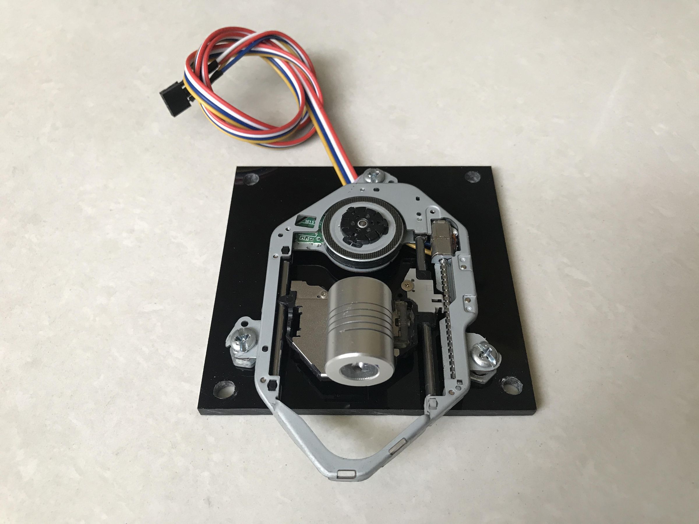

Step 7: Double Z Axis

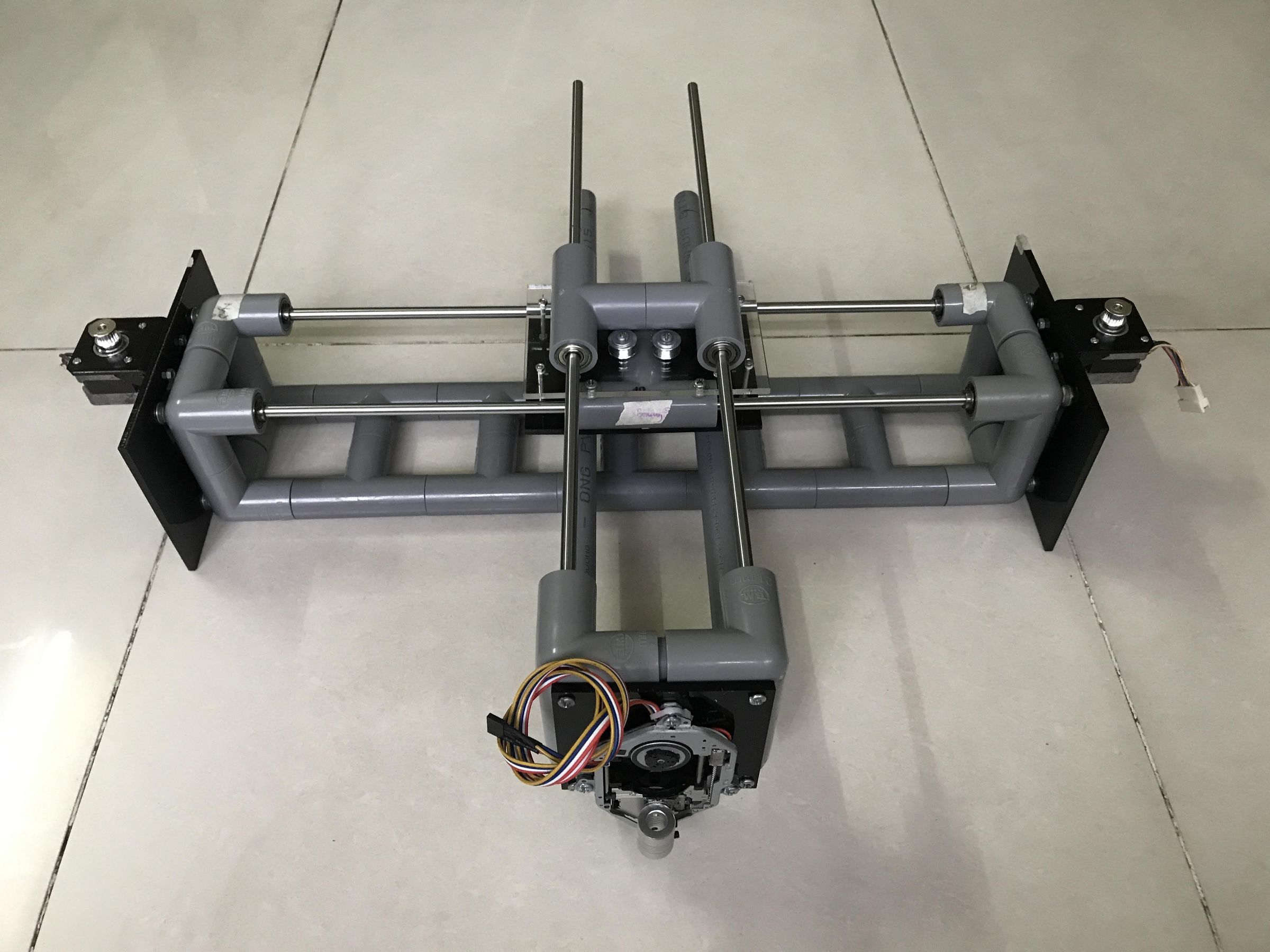

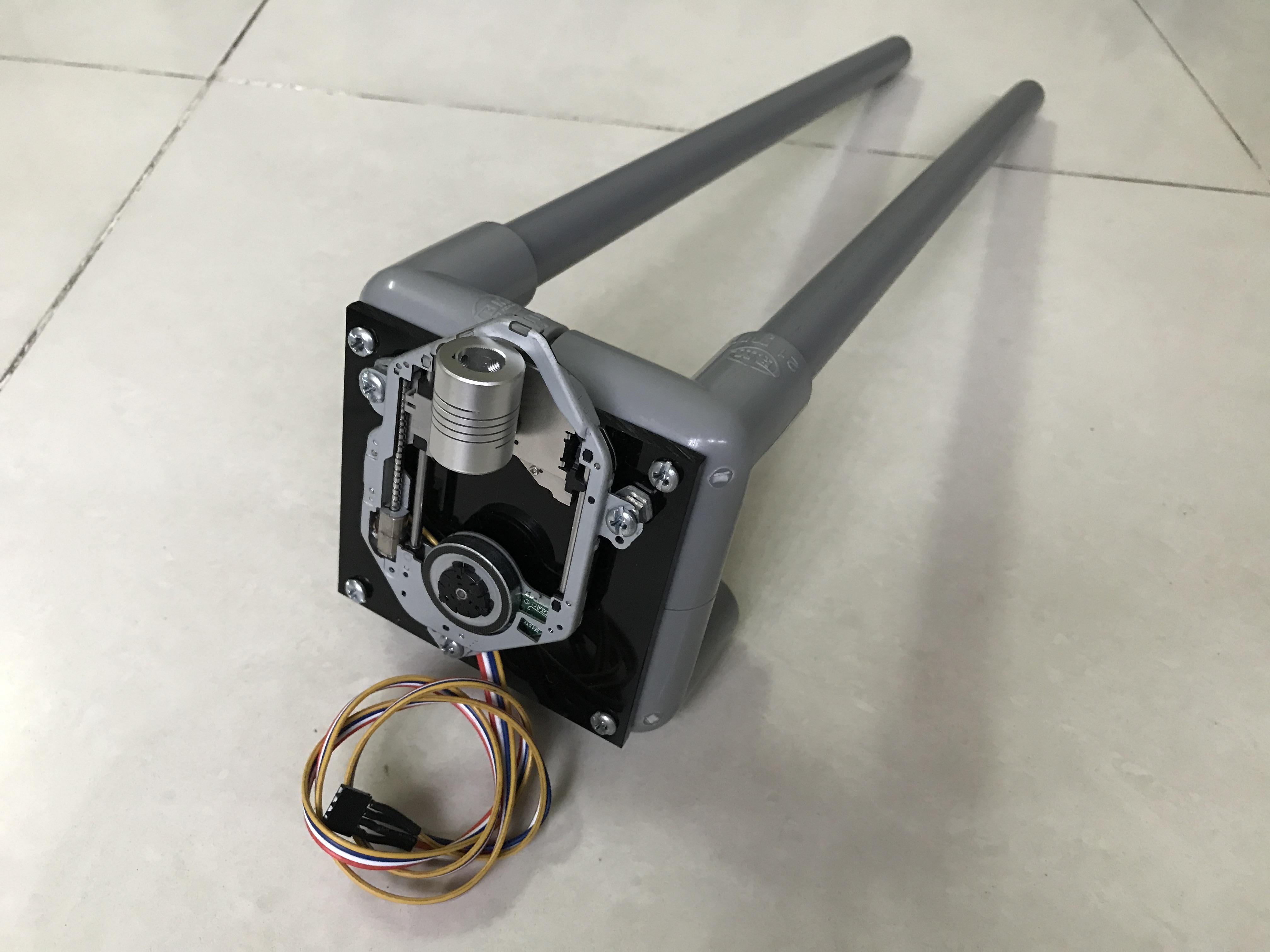

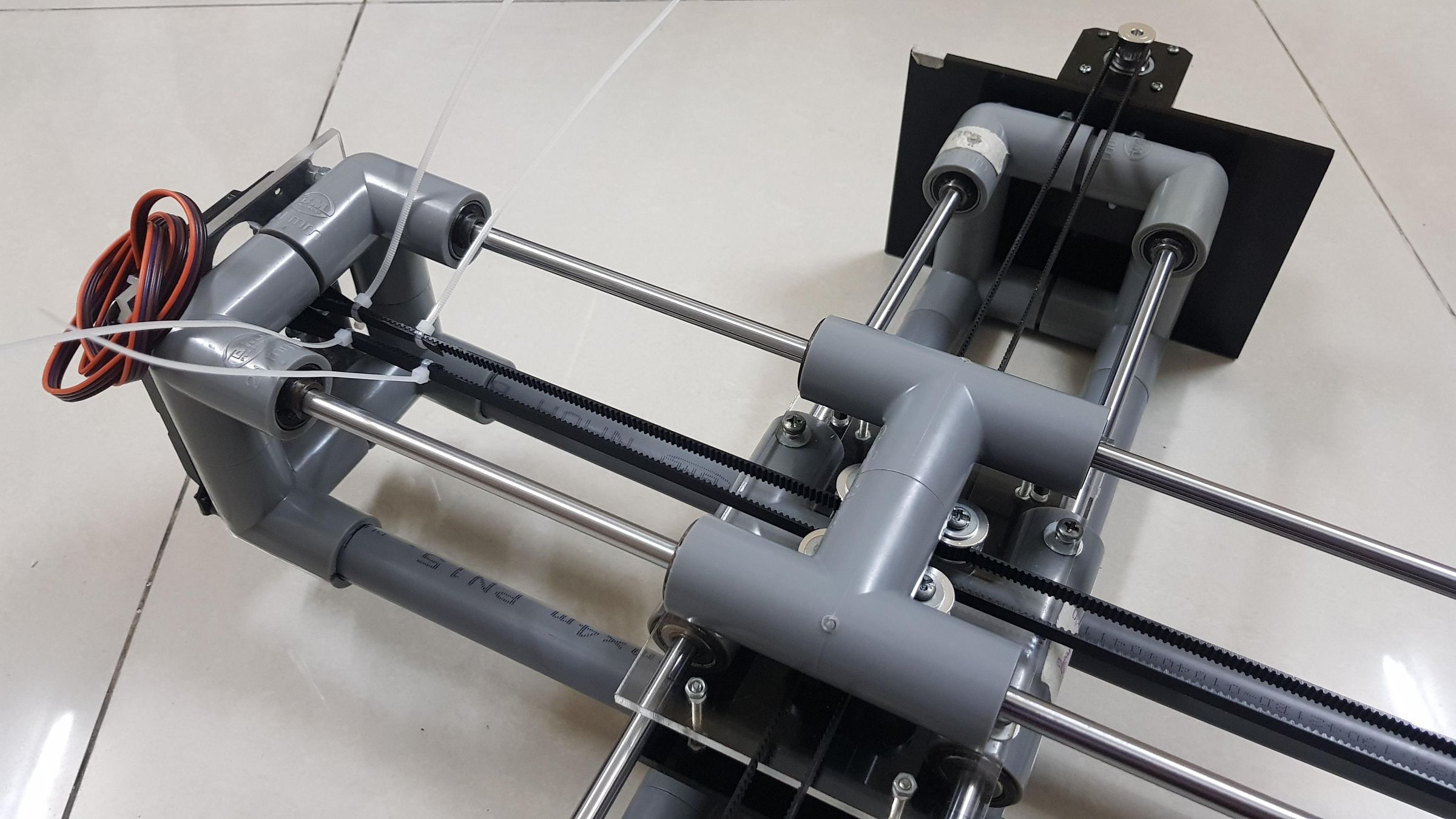

I cut 2 acrylic sheets, dimension L120 x W100 x T5mm, drilled holes to mount 2pcs x CD/DVD frame and installed 2 aluminium flexible coupling 10 x 10mm for clamping the pens.
I disassembled X supports from X frame and drilled 4 holes on the each support.
Mount CD/DVD acrylic frame on X support.
Install it to DrawBot PVC frame.
Mount the second CD/DVD frame on the other side.

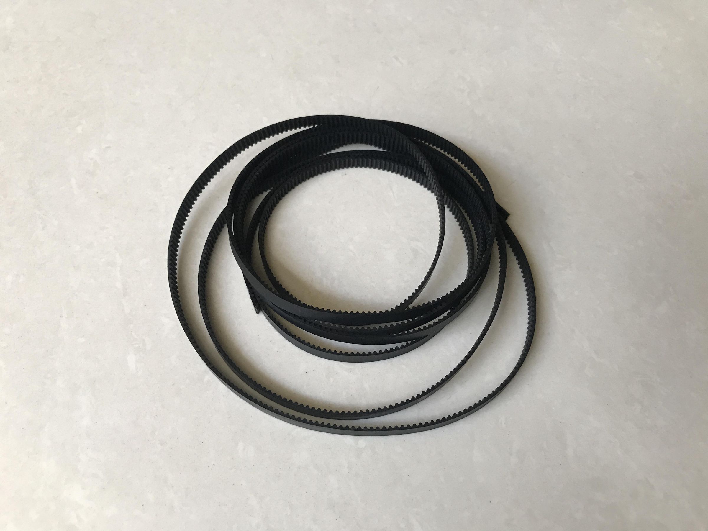

I measured and cut 2.5m GT2 6mm timing belt.
Thread the timing belt through stepper motor pulleys, idler pulleys.
I tightened the timing belt as much as I could and locked two ends by cable ties.

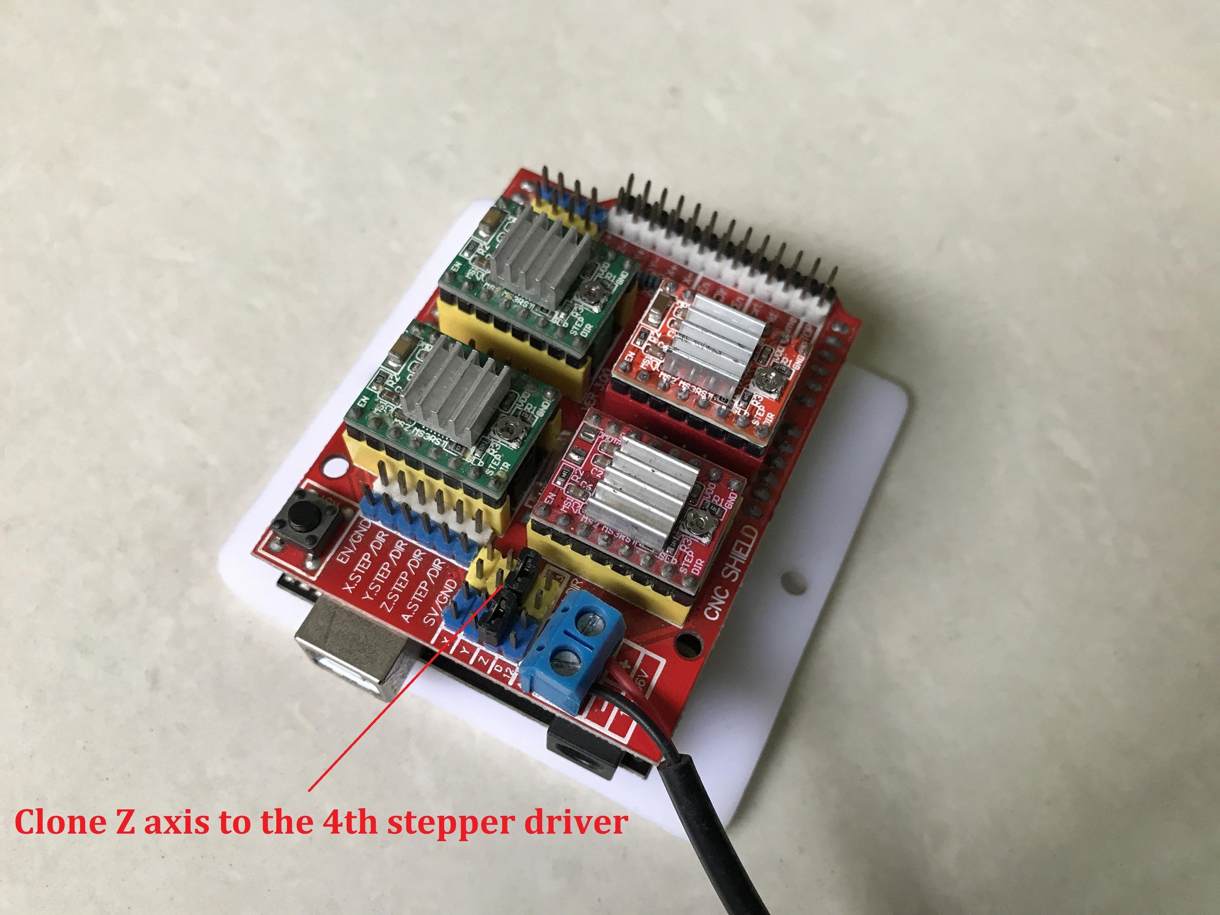

My project used 4 stepper motors and A4988 drivers. Because Z axis operated with 2 CD/DVD stepper motors, I had to add 2 jumpers as below picture to configure the 4th axis. In this case, Z-Axis was cloned to the 4th stepper driver A4988 which is marked as "A" on the CNC shield.
We should pay attention to measure & set the current limit of stepper motors by adjusting the trimmer potentiometers on the A4988 drivers, especially for CD/DVD stepper motors – compact size.

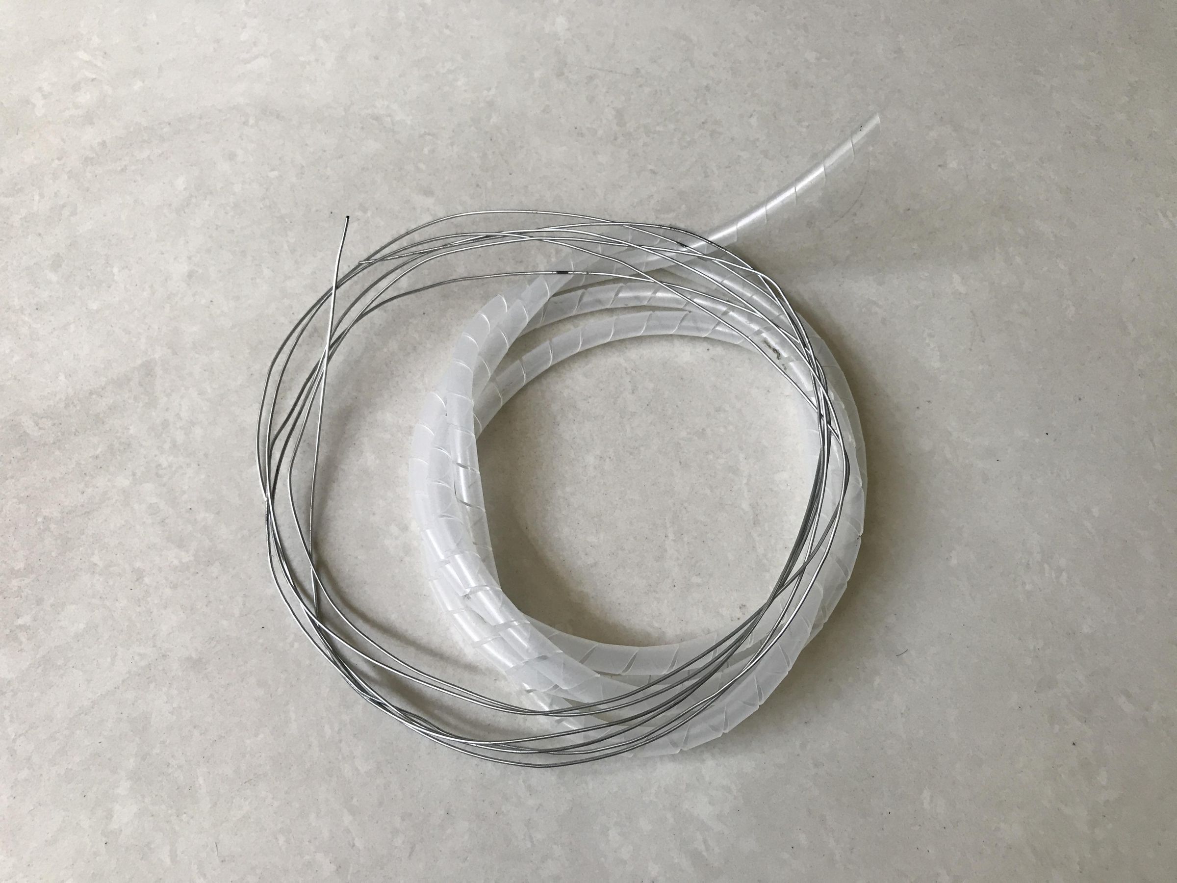

Because DrawBot PVC frame was all hollow, I could easily drill few holes and threaded the cables inside PVC pipes. But I didn't like this way, so I left the cables exposed and Arduino Uno was placed on the moving part (belt support).
To keep the cables well organized and tangle-free, I used some small sized zinc wires that came along the stepper motor cables and they were covered by cable spiral wraps.
The zinc wire was strong enough to hold the cable in a standing position and also flexible enough to be bent or stretched when my DrawBot was working.

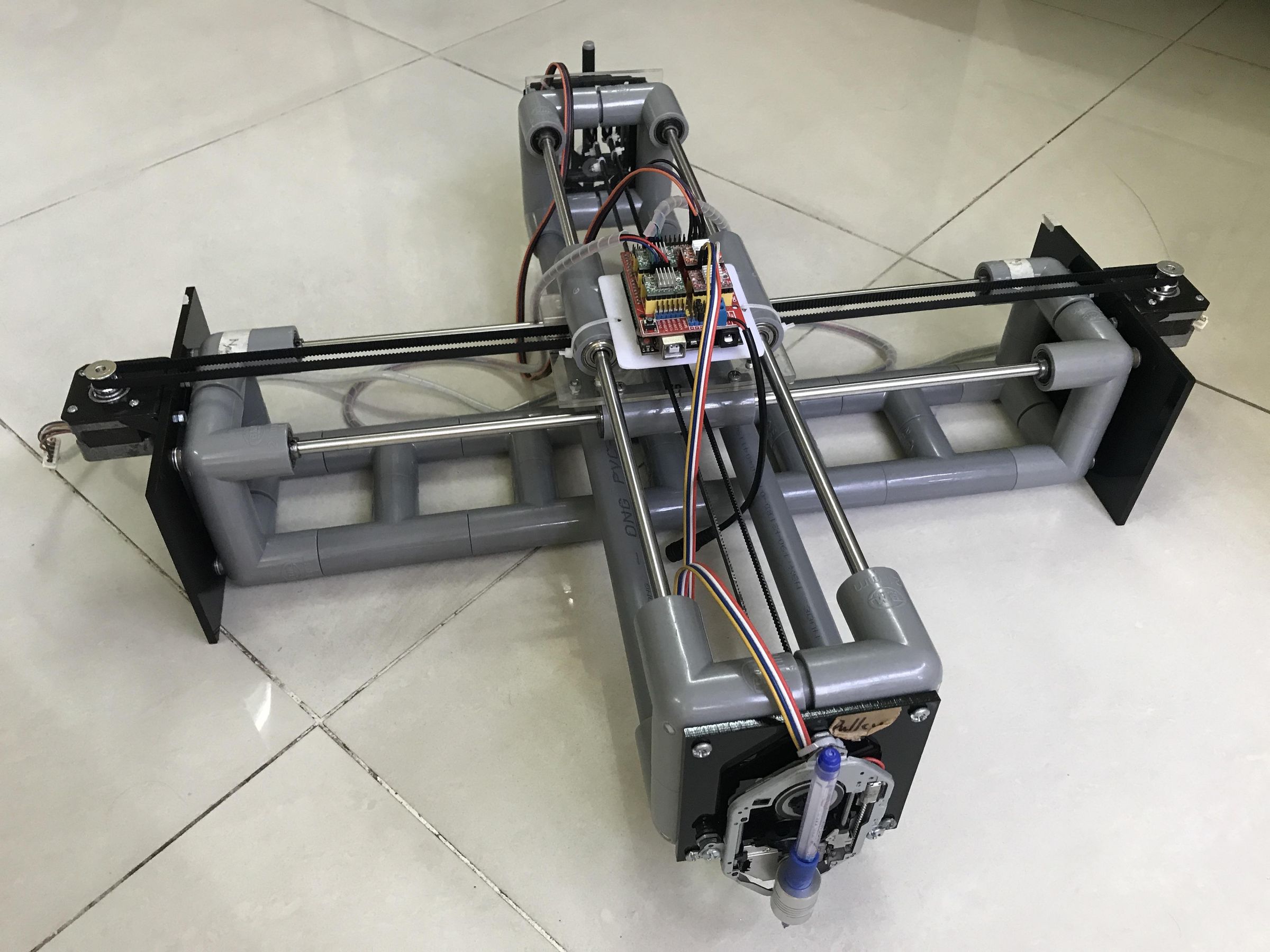

Step 14: Testing After Completion
I used two red and blue ballpoint pens to draw some pictures and texts. As you can see, the drawing quality is quite good.
