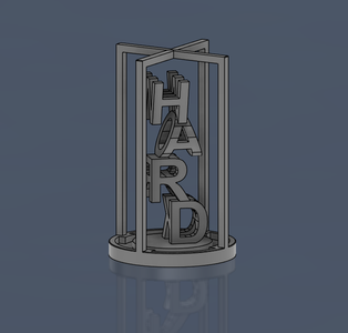

The finished result should look like the second visual. As you can see, when we orbit around the object, it now displays different words when viewed from different angles.
Step 5: Stacking the Letters
To design the lamp, we need to make sure that the letters aren't just floating in mid-air. To move the letters, select the body and use the 'Move/Copy tool (press M) to stack the letters on top of each other. You also need to make sure that there are some points of contact between the letters (as you can see, I made sure the top of my A/O was under the leg of the H/W).
Tip: Click on one of the faces of the cube in the top right corner (Viewcube) to work in a straight orientation. When you move your letters, it ensures that you are only moving them on a horizontal or vertical plane.
This is the part where you can play around with the design and orientation to make it unique. For mine, I kind of embed the W with the O to make things work for me. Also, I went with a zig-zag orientation for 'HARD' to make it more interesting.

To bring in the dual text, either move it or the stand with the 'Move/Copy' tool. I made sure to rotate the lamp base so that the beams aren't covering up the letters when viewed straight on. Finally, use the 'Combine' tool to join the two together.
For some finishing touches, you can use the 'Fillet' tool by pressing 'F' to round off some edges. For myself, I want to keep the sharper look so I only rounded the base and the corners of the arc a tiny bit.
