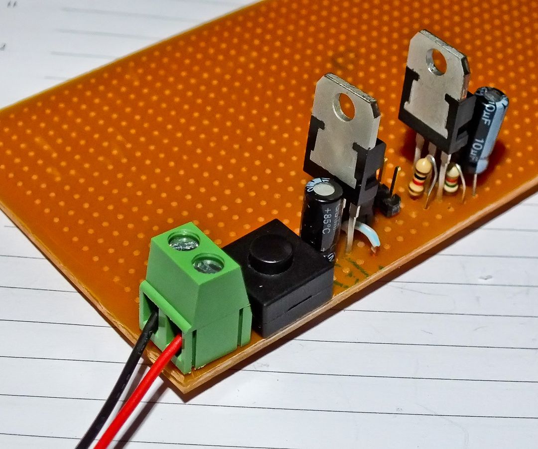

Step 3: Power Rail
In this segment I have created two
sets of power rails on either ends of the strip board, mimicking a project
board. Each rail has 5V, 3.3V and ground lines.

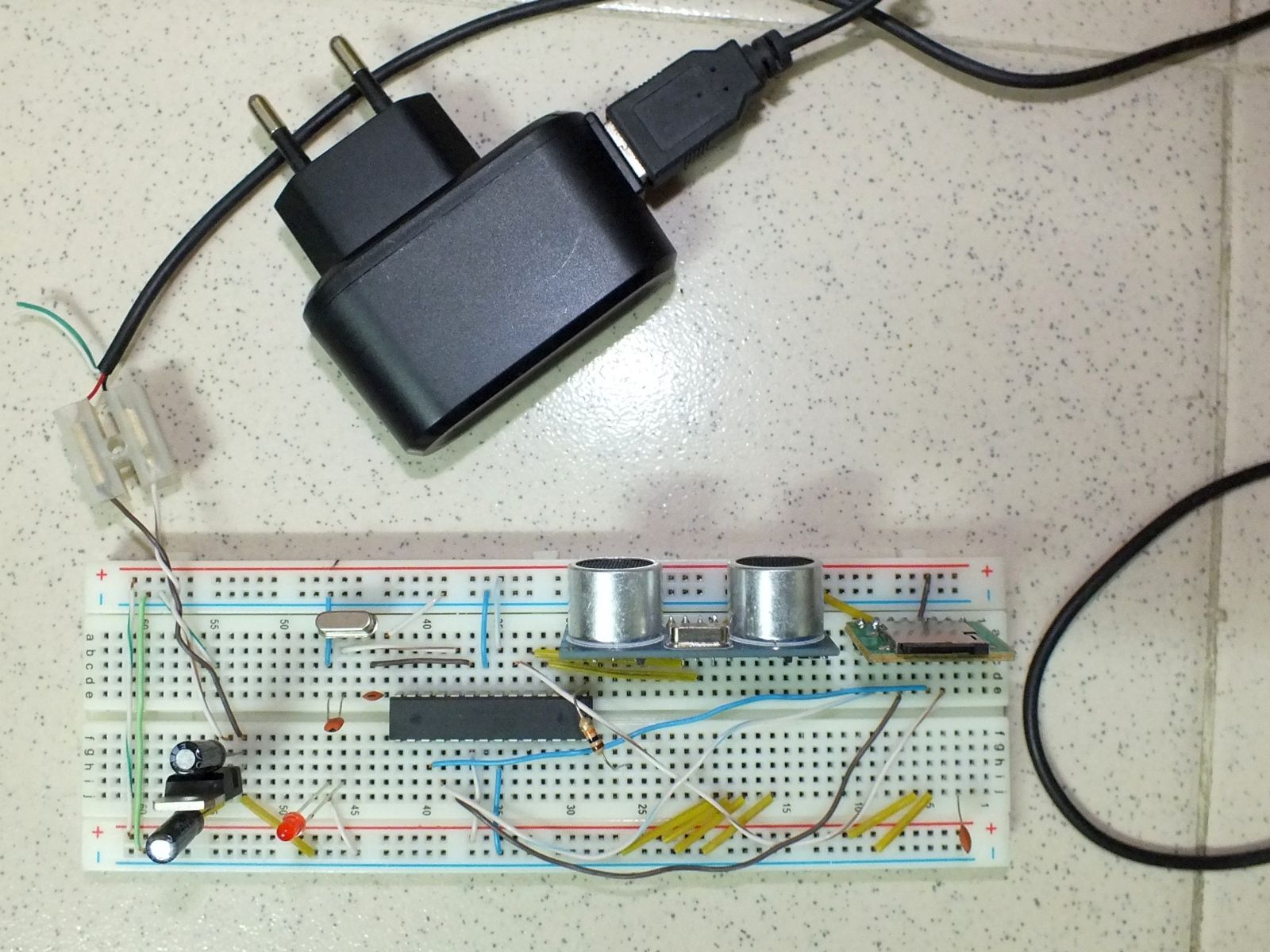

Step 4: Microcontroller
This segment shows placement and powering of a bare-bone ATmega328 microcontroller. I am 'minimalist' in this project,
so I am not using crystal-capacitor or resonator as an external clock source.
That means I am clocking the chip at 8MHz using its internal clock, and using an
appropriate bootloader.

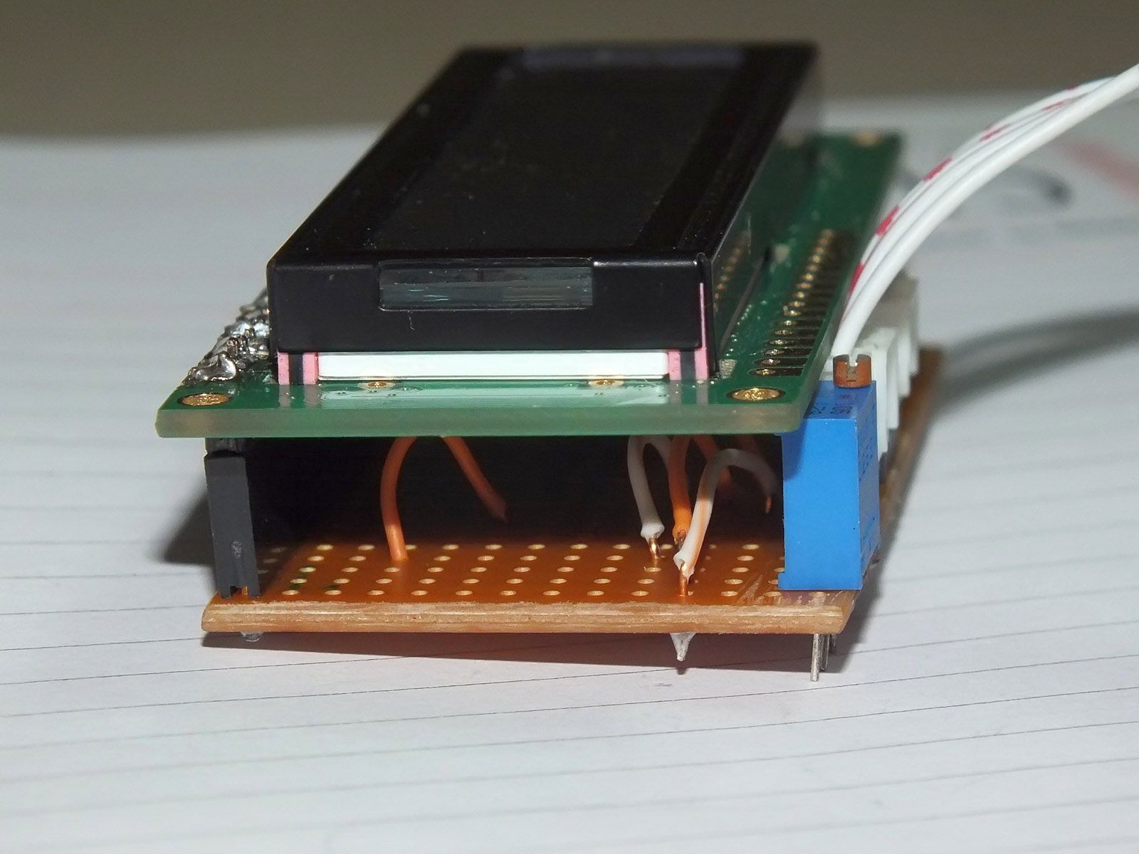

Step 5: Ports - Exposing Pins
In this segment I have exposed many pins from the ATmega chip using male and female header segments (choice of
male or female is determined by the types of cables at my disposal that I would
use). Please note some of the pins that I have exposed as ports.
1. ISP port: ATmega pins 16, 17 & 18 (digital pin 11, 12 & 13) in combination with pin 0 (Reset) will be used to download sketches using a proper Arduino. Digital pins 11, 12 & 13 will be connected to Arduino's 11, 12 & 13 respectively, and the RESET will be connected to Arduino's digital pin 10. Since I am using a 8MHz ATmega configuration, I don't need a capacitor at the RESET pin (I don't know why, but I do use this often). This port allows me to program my board without removing the IC.
2. At the top left, I have exposed two analog pins (A4 & A5), and a 5V power. I can use this port for attaching LM35 temperature sensor, DHT11 Humidity & temperature sensor, or 18BS20 digital temperature sensor. In fact I can attach anything which needs only one data pin and 5V power. One analog pin will be designated as GND, a 'software ground' if you like. To achieve 'software ground' I will write the following code in the sketch-
3. At the top right side is an 8 pin header for attaching a MicroSD breakout board. This breakout board does not have any additional circuit, it just exposed the 8 pins of the MicroSD card through 8 breadboard friendly pins (see photograph). Since ATmega is powered at 3.3V, SD card will get only this much voltage at any time, and I assume, I don't need a logic level shifter.
4. A 4 pin port at the upper-middle and another at the lower-right will be used to connect LCD character display. These two ports are compatible with my earlier design - LCD character display breakout (please see this Instructable for details). To use LCD display using these ports I will include the following lines of code-
5. A 4 pin port at the lower left
side for some other sensors, for example, GPS, Ping etc. here I made a special
provision of selectable voltage through a jumper setting. Please see the last
picture in this section.
6. Next to RESET pin Tx/Rx pins exposed for connecting to serial in/out.
