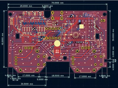

Step 3: Designing the PCB Layout
I used KiCad 7.0 for designing the PCB, which is a two-layer board as shown in the attached final layout picture. To make sure there is no interference with the case, I printed the board shape using a 3D printer and placed the main components on it for checking, as shown in the attached photos. For component placement, I printed the layout onto paper.

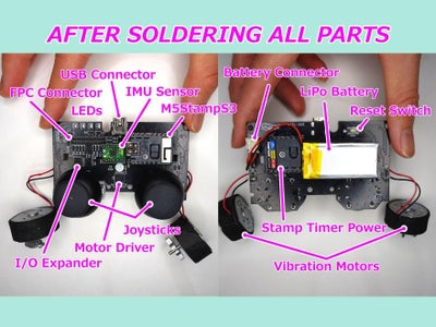

Step 5: Soldering Parts on the PCB
If you have solder paste and hot plate (or an oven for reflow soldering), this step might be easier. However, since I didn’t have these tools, I used solder wire, a soldering iron, a heat gun and soldering flux. Here’s how I approached it, though other methods might also work well.

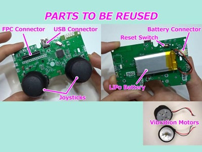

  1. Prepare Reused Parts: Before soldering, remove some components from the original board for reuse. The reused parts are shown in the attached picture. A heat gun can make this process easier.
  2. Soldering the M5StampS3:
  3. Apply soldering flux to both the pads on the M5StampS3 and the pads for it on the PCB.

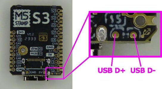

  4. Using a soldering iron, apply solder only to the USB data pads and two additional pads for positioning, as shown in the attached picture.
  5. Place the M5StampS3 on the PCB and heat it with a heat gun until the solder melts. You can check if the solder has melted by looking the USB data pads. Align the M5StampS3 before the solder hardens using tweezers.
  6. After it is fixed, use a soldering iron to solder all the M5StampS3 pads.
  7. Soldering Other Components:
  8. Solder the Stamp Timer Power and the reset switch with a soldering iron.
  9. Solder the FPC connector with a soldering iron.
  10. Solder the USB mini-B and the battery connector with a soldering iron.
  11. (Optional) Solder IMU module with a soldering iron.
  12. Solder the joysticks and the motor wires with a soldering iron. Motor wires can be soldered during the 5th process in the Step 6: Assembly section.
  13. Attach the LiPo Battery: Use double-sided tape to attach the LiPo battery to the PCB and connect the battery connector.

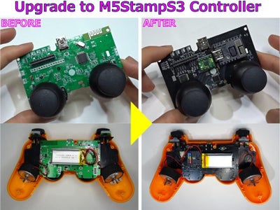

Step 6: Assembling the Controller
Basically, reassemble the case in the reverse order of how you opened it.
  1. Insert the FPC to the FPC connector.
  2. Set the plastic plate behind the FPC.
  3. Install the two rubbers for the R1, R2, L1 and L2 buttons.
  4. Place buttons and button rubbers into the front case.
  5. Install the electrical parts to the front case. Make sure the rubbers for the L1 and R1 buttons are correctly positioned under the L1 button.
  6. Attach the R2 and L2 buttons to the back cover with the springs.
  7. Close the back cover onto the front case. Before completely closing, use tweezers to hook the springs for R2 and L2 onto the plastic plate behind the FPC.
  8. Finally, fastened the cover with the five screws.
