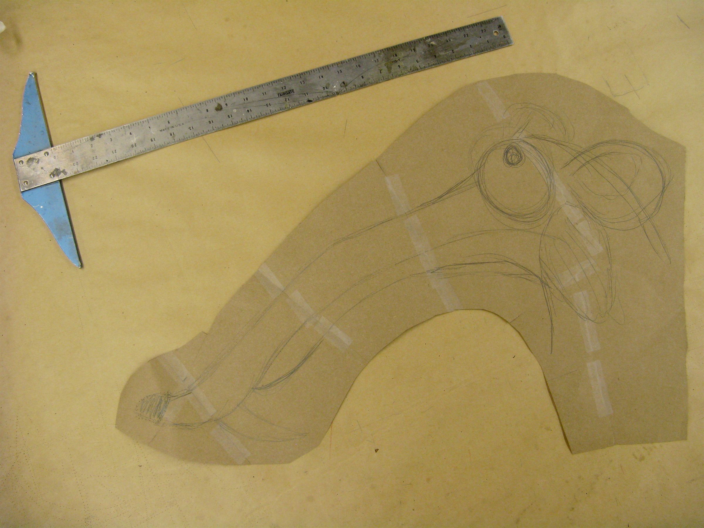

Trim the bottom to shape over the shoe.
Use the ruler to draw line down the side seam. Carefully cut through the t-shirt/tape on the line, this will be where the zipper is placed.
Once off the leg, trim top and bottom to neaten and wrap all edges with duct tape. Trim away any excess t-shirt from the inside that will be flopping around.
