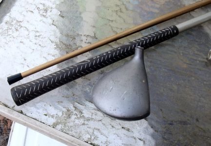

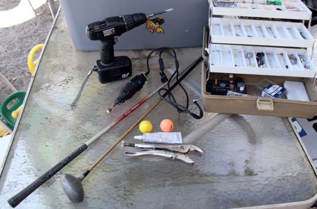

often found around golf courses and middle class neighborhoods duffer sticks turn up in the trash fairly regularly, occasionally you'll find a dufferstick with a useless metallic growth on one end that needs to be removed, often they will have upto a dozen other sticks with various mutated ends in a tall cylindrical container with bumps on the side that protects the duffer fruit,  the round fruit of the duffer comes in a lot of colors from basic white to glow in the dark, it's difficult to predict what color you'll find.
 You will also need a dremel or other cut off and sanding tool, a dril with appropriate sized bit and some form of adhesive

If you have found a clean duffer stick you're ahead of the game, if you have to remove a malignent growth from one end use a cut off wheel or metal cutting blade in a jigsaw

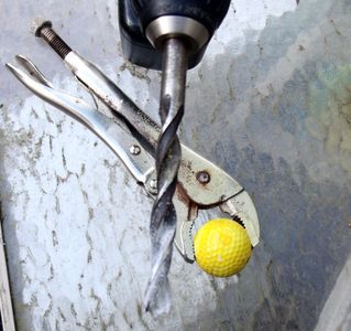

if you have a vise USE it, I don't have one so I clamped the duffer fruit in a pair of visegrips and drilled a hole about halfway thru the hard fruit

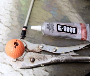

I filled the hole in the orbs with an adhesive then stuck the duffer stick in and tapped it on the ground to be sure it was well seated, then wiped off any excess glue that leaked out
