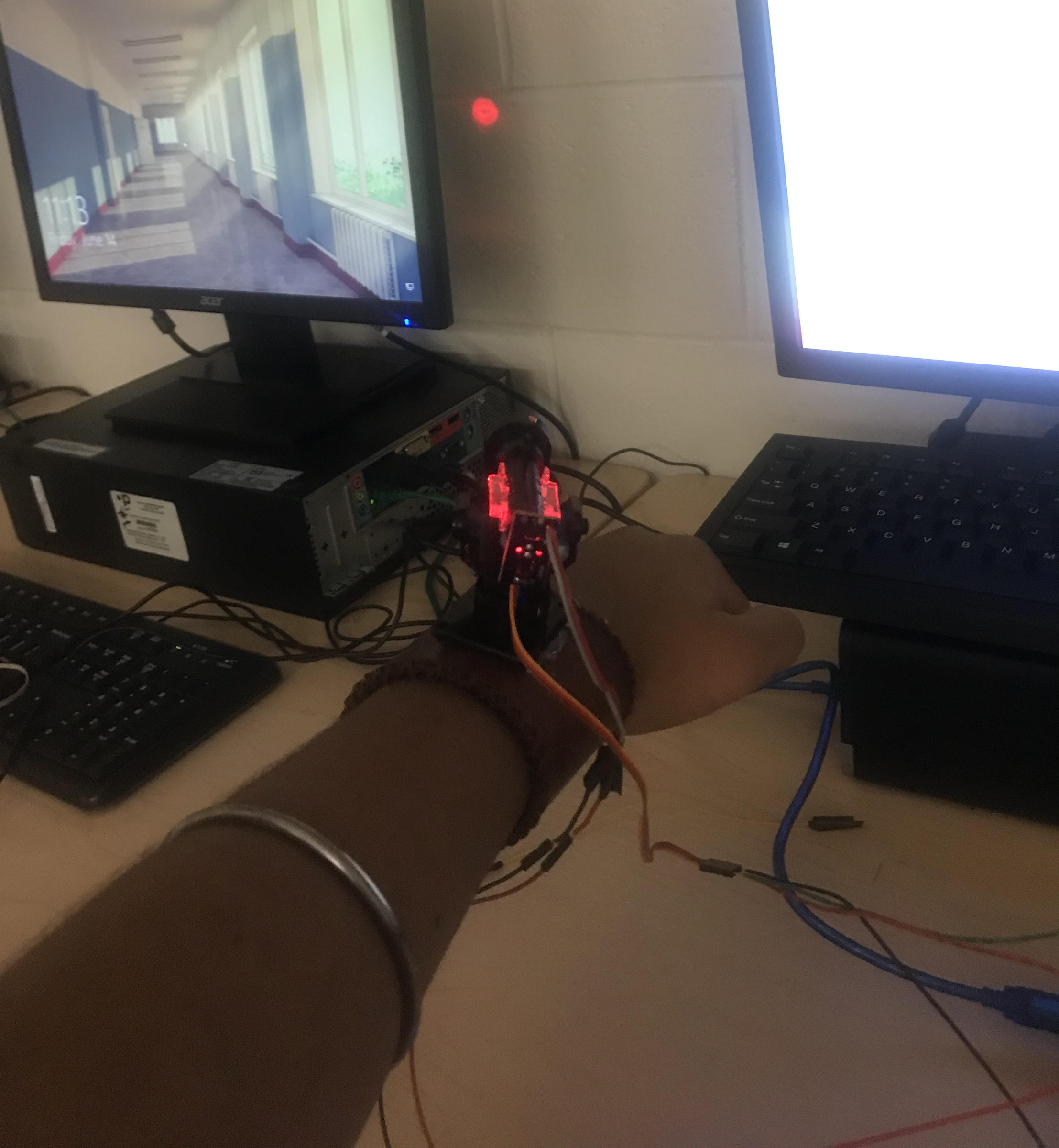

Step 1: Building the Arm
For me, building the physical arm was by far the most challenging and time-consuming part of this project — especially since I had little prior experience. That’s why my biggest recommendation is to look at several design models, consider your budget, and take stock of the materials you already have on hand.
In my case, I chose to 3D print the gripper portion of the arm and used plastic bars I found at the dollar store for the structure. I then cut these pieces to my desired lengths.
One crucial thing to keep in mind is weight. If you're using 9g servos like I did, you’ll quickly run into limitations when it comes to lifting heavier parts. The combined weight of the gripper, fasteners, and arm segments can exceed what these small servos can handle. In fact, I had to remove one servo entirely and shorten the length of my arm just to make it work — which is why there’s a missing servo in my code.

Step 8: Enjoy
Now that your robotic arm is built and coded, it’s time to have some fun! You can experiment with adding new functions or “cases” in the code to make Dum-E perform specific motions, or simply enjoy it as a cool desk toy — the choice is yours.
