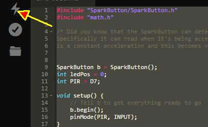

Step 4: Load the Sketch
You can find the latest revision of the code here.

#include "SparkButton/SparkButton.h"
#include "math.h"
SparkButton b = SparkButton();
int ledPos = 0;
int PIR = D7;
void setup() {
    // Tell b to get everything ready to go
    b.begin();
    pinMode(PIR, INPUT);
void loop(){
    if (b.buttonOn(2) || !digitalRead(PIR)) {  //alert mode on button press or PIR activation
//        for(int i=1; i<13; i++) {
//            b.ledOn(i, 127,0,0);
//            delay(10);
        b.allLedsOn(127,0,0);
//            b.ledOff(i);
//            delay(10);
        delay(80);
        b.allLedsOff();
        delay(80);
    else { //standby mode
        ledPos += 1;
        ledPos %= 12;  //modulo
           b.ledOn(ledPos, 0, 20, 20);
        // Now turn that LED on
        // Wait a mo'
        delay(160);
        // Turn the LEDs off
        b.ledOff(ledPos);
