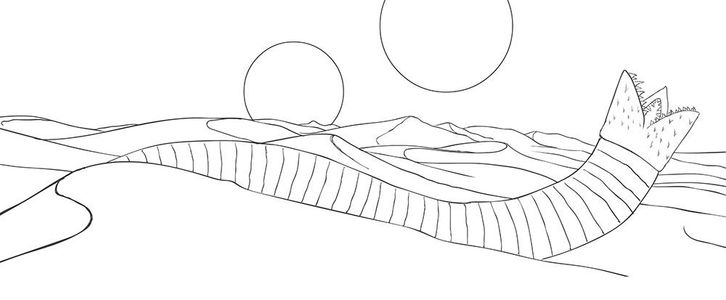

Step 1: Making the Design
Design your carving in the program of your choosing or on paper. I used Adobe Animate with a Wacom drawing tablet to draw the design (since I was planning to animate it). Photoshop or Illustrator would also work well. Another option is to just draw it by hand on paper.
Step 2: Transfer the Design to the Wood
Transfer the design onto your piece of wood. I printed mine out on several sheets and taped them together.
Important: place a couple pieces of tape on the top of the design, so when you are transferring it there is no movement. The top pieces of tape also act like a hinge, so you can check on the design as you're transferring it.
Place a large piece of carbon paper under the design and trace all of the lines, occasionally lifting up the paper to check on the progress.
