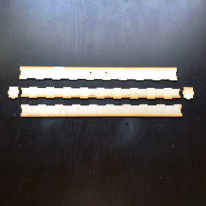

The first step is to cut the pieces out. Again I used a laser cutter but a table saw and/or jig saw will also work. The big advantage of the laser is it easily allows me to cut box joints or slots and tabs into the edges of the box. This makes putting the pieces together easier.
After cutting the pieces out, I stained the wood to make it darker. You can stain the wood before or after cutting.
Next glue the pieces together to make the outer box and the inside drawer. You can see in the photos how the drawer joints, tab together to make the drawer. The outer box is the same. I used a regular wood glue and some gorilla glue to glue the edges together. The attached pdf has an illustration of how the pieces go together.
