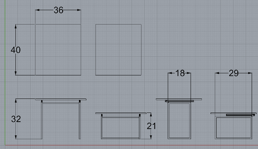

In this step I researched the ergonomics of coffee tables and desks on the internet and by taking lots of measurements before starting to work out the design in CAD.
Pictures:
1. I took these measurements and modeled the table in Rhinoceros, a CAD Program. After the model was complete I projected it flat to make a 2D image which functioned as my rough blueprints.

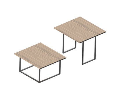

2. I rendered the digital model quickly in Keyshot to get an idea of what it would look like when completed.

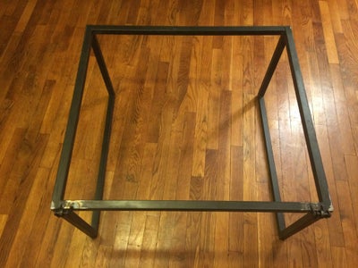

1. The table started as 1"x1" square tubing, I bought around 35 feet of tubing and used the excess for other projects.
2. Then I marked my cuts and cut them with an angle grinder.
3. I ground down the edges down so they won't cut me and so any large burrs are smoothed out so the pieces can mate flush.
4. I lined the pieces up with a right angle clamp, this is a Pony #9166 and it's awesome. I've also use the right angle welding magnets but this works a little better for me.
5. Weld the whole frame up and paint it black. I lost some pictures when I dropped my phone in a puddle but you get the idea. I used the pony clamp and a large square to make sure everything is inline.
6. The mounting tabs for the bearing pivot were tricky. You can see it took multiple tries to get them into the right position to slide easily.

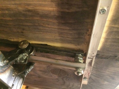

This step shows how I made the mechanism that the table pivots on. I wasn't so sure on how to model or measure this in CAD to simulate how it would work so I attacked the problem by prototyping in the workshop. The system liked to bind up and took several iterations to get it to glide smoothly and reliably.
Pictures:
1. Put the bearing and bolt into the tabs on the frame. I repurposed some old rollerblade hardware to make this portion.
2. I found some C-Channel and drilled a hole on each end so I could attach it to the board.
3. To shim the channel to the correct height I used 4 bolts so the bearing had enough room to roll. Dirty but effective as my hardware store didn't have the right size spacers I needed. Tighten down one side but leave the other side open so it can slide in on the bearing.
4. Slide the open side of the channel over the bearing and add the nuts to the other sides bolt.
5. Tighten everything down and make sure it rolls smoothly. Use lock washers or some other locking hardware to ensure it remains tight and doesn't get out of tolerance.
