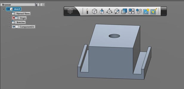

I took a set of calipers (these are really important if you are going to make parts) and measured the important dimensions; then put them on paper.
Step 5:
I went from paper to a 3d part in Autodesk 3d software (free--runs on Windows only). It takes about 10 minutes to design a part like this if you have the dimensions (and that's for a self taught user like me).
