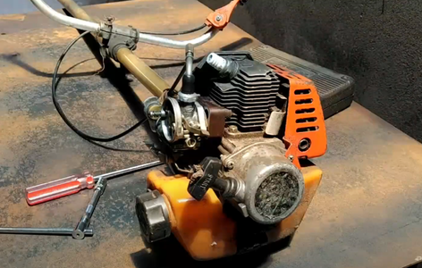

Step 2: Disassemble the Engine
This is a two stroke engine. You can also use 4 stroke engine with some additional steps. When disassembling, some bolts will not loose easily. I used a tool that can turn the bolt a litte bit by hammering on the tool. Carefull when hammering on it because engine made out from cast iron which could crack. When removing the magnet pulley remover need to be used. I used L bar with 3 holes. 2 bolts fixed into the holes used to attach centrifugal clutch and middle bolt used to push the crankshaft. Removing recoil starter will be easy while magnet is in place.

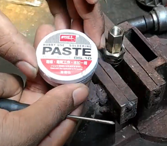

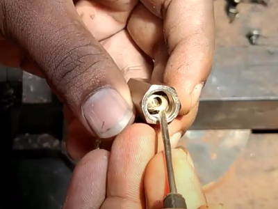

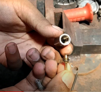

One way valve need to attach close to engine head otherwise efficiency will be reduced because piston just compress and decompress lot of same air volume without passing through the valve. I soldered a sparke plug metal body to one way valve or you can diectly make a thread using lathe machine on to valve body. You can remove the ceramic body and electrode which is inside of ceramic by cutting off the rivet and push the ceramic. Spark plug must be some hardned steel and one way valve is nickel coated brass part. I sanded the nickel coating of the are which i was going to solder. Sources say you can solder dissimilar metals if you use correct flux. This is not a special flux i used because that is what had in the electrical shop but it works without any issue. Remove the rubber ring in the valve body befor soldering. You can turn the inside nut to remove it.
Note- If you have hard time turning the motor using battery power you can cut the spring to reduce the length or less lensioned spring can be used. It will make easier to pass air through

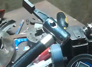

Step 10: Air Connection
This pressure gauge i bought from aliexpress and it can give fairly accurate readings. Most cheap analog gauges not not even provide close readings. Used 1/8NPT connections for all brass parts and 10mm pneumatic hose. Hose clamps used for hose. This air chuck is from an old compresure. You can buy these from online or locally. This does not have deflate button. It is better if you can get a chuck with deflate ability.

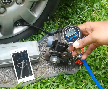

Step 11: Testing
Connect crocodile clamps onto battery terminals and start the car. I didin't fully deflated tire. Only reduced to 8psi. When inflating gauge gives higher reading than actual this might be due to pressure pulse from the comprassor. Recommended pressure is displayed driver side on the door edge of vehicle body. I took about 2 minuts to fill the tire. This may looks like a lot but i'm satisfied because this is much more durable than cheap plastic compressors and can provide accurate readings.
