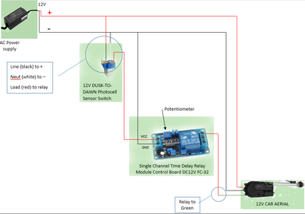

Step 5: Curses...Got a Problem.
Because my pen resides under many trees, I found the door was closing prematurely due to the heavy shade as nightfall approached. This was locking my chooks out of their coop before they had headed off to roost for the night.
So what I did was to install a delay relay switch to postpone the closing of the pen door by about 30 minutes.
The way the aerial works is as follows:-
With just the black and red wire connected to the power source, the aerial is in the retracted position, which means the door to my pen is open. For the aerial to extend and close my door, there needs to be power supplied to the green wire.
In the attached video, I have wired up the relay to delay for about seven seconds ( for demonstration purposes) before allowing power to the light - The light representing my aerial once I have incorporated the relay into my wiring.
With this particular relay module, the delay period can be extended to up to one hour by reconfiguring the jumper switches and adjusting the potentiometer as described further on in the following step..
The green LED will light up for the duration of the trigger time that has been set (7 seconds).
The light now switches on and will remain on (meaning my door will remain closed) until the photo-electric cell triggers again the following morning.

Step 7: Wiring Up Components
OK, so here is the complete wiring diagram on how I configured my setup. You could of course use a 12V battery, but i found that it required charging every 3-4 days which would be a pain in the butt for me. A solar charger was also out of the question due to shade, so i went with running mains voltage out to the pen.
I'm a complete dummy when it comes to wiring up and understanding electrical circuits. The photo-electric cell (PC) and delay relay came with no instructions what soever. I have only basic school boy knowledge, and could not find anywhere, a decent instruction on how to wire up the relay with the PC. So after a fair bit of trial and error I was able to put something together and finally came up with the following solution. Hopefully this will help others like me who are also not electrically minded.

After installing and having it running for a while, I thought it would be handy to have an override switch on the door so as I could manually close the door during the day if needed. Certainly helps when trying to catch the little blighters.
The switch I used is a SPDT type, which allows the current to flow in only one of two directions, but not both at the same time - i.e. Current to flow to the aerial either via the PC and relay, OR directly from the power source.
You need this type of switch to isolate the relay from receiving a current backflow into the output end of the device as it sends the device into a panic attack.
Above is the switch and the wiring if you are interested in adding this. The switch cover is just a cut out plastic bottle to protect it from the elements.
