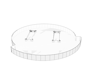

Step 2: 3D Modeling of Inertial Separator
I used SolidWorks to model the MDF parts. With the HSMXpress addon, I created the G-Code that would control the CNC Router. The STL Files are attached, but the G-Code should be created using a post processor for the specific machine.
The top is a 9.5in circle with 4 thru holes for bolts and two 1.5in holes for the PCV. Easily made using a router with circle jig, hole saw, drill bit, and drill press.
The bottom is an 11in circle with a groove 135deg for the dust to fall through
Supports are 5in by 3in rectangles to hold the assembly together
