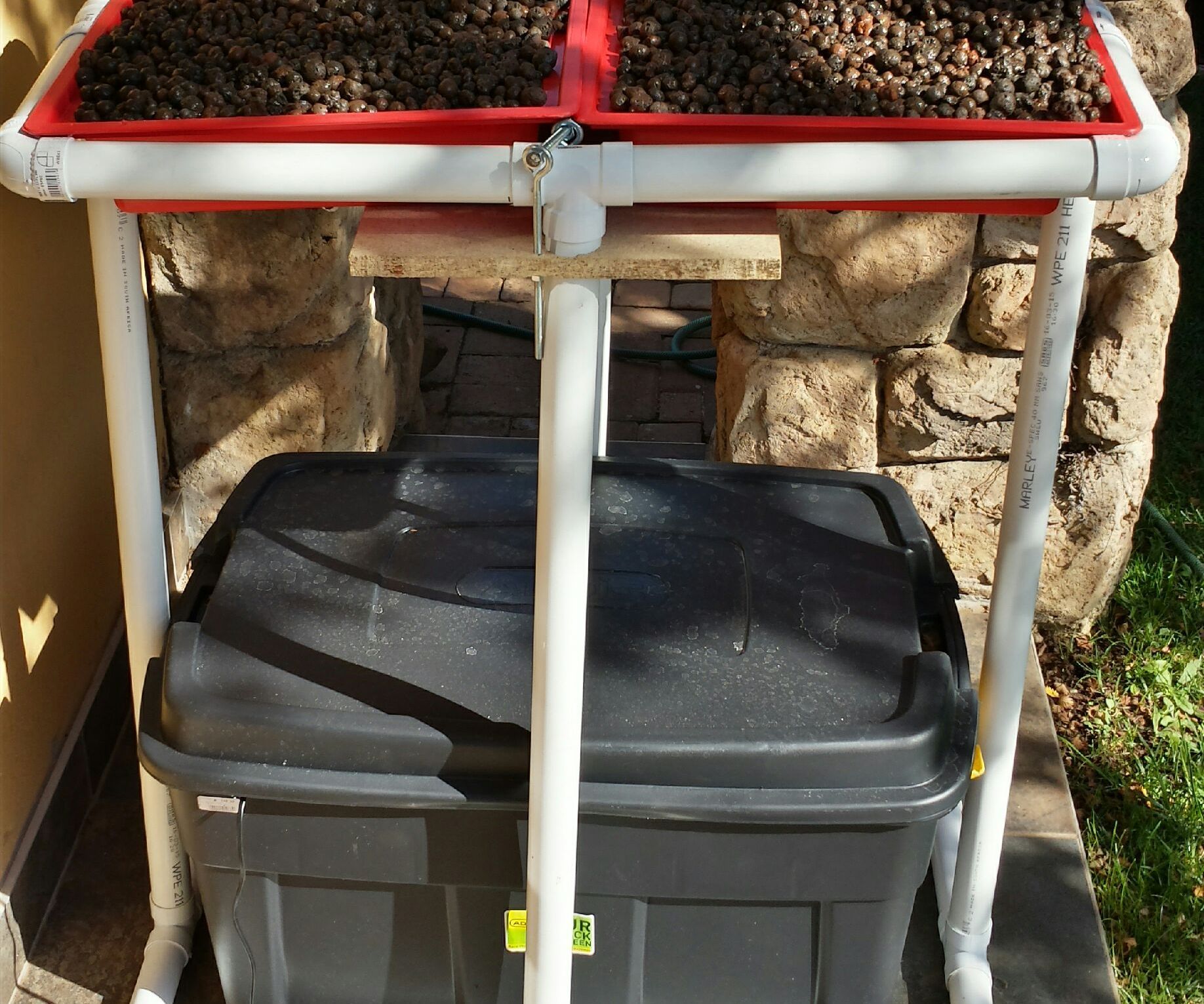

Step 6: Pump and Final Adjustments
The pump can now be put in the reservoir and water added to the reservoir.
I chose to use perlite as my growing medium, which I bought from my local hydroponics store. The inner bucket can be filled with perlite (I suggest rinsing the perlite first).
The system can be tested and as you can see I added some cheesecloth on the overflow as a filter (as some perlite was coming through the system and blocking the drippers). This is a temporary solution as I will put a filter bag around the pump to stop any perlite from circulating through the system.
I cut a hole in the lid of the reservoir for the inlet and outlet pipes.
Step 7: Final Product
Here you can see the final dutch bucket system up and running with my first plant in the system ( a pea moved from one of my other hydroponic projects as it was outgrowing that system https://www.instructables.com/id/Backyard-Ebb-and-...
My system is currently running 24/7, I will adjust and add a timer if i find it necessary. The nutrients in the reservoir were also purchased from my local hydroponics store.
There are still one or two things that i need to do to this system. The first is a wish to cut plastic sheeting and place it over the perlite to keep the perlite out the sun and decrease the amount of algae growth. The second thing is i might need to get an airpump and airstone to ensure that their is enough oxygen in the nutrient water.
When summer comes I might need to cover my buckets as well as reservoir in white plastic to try keep the temperature of the nutrient solution and plant roots down, however it is currently winter so I want as much heat as possible.
Step 8: Quick Update
My garden pea is loving the system and has been doing the best of the lot, lots of fruit almost ready to be picked. I've also chowed some of the cos lettuce and freckled lettuce that I have been growing. Very happy with the results.
The only things that have changed, is that I have added an air stone and airpump to give the plants a little bit more oxygen. I have also added covers that go over the perlite to stop algae growth. You will see that I was having a problem.
Other than that all is good and very happy with the setup, no leaks and very low maintenance
