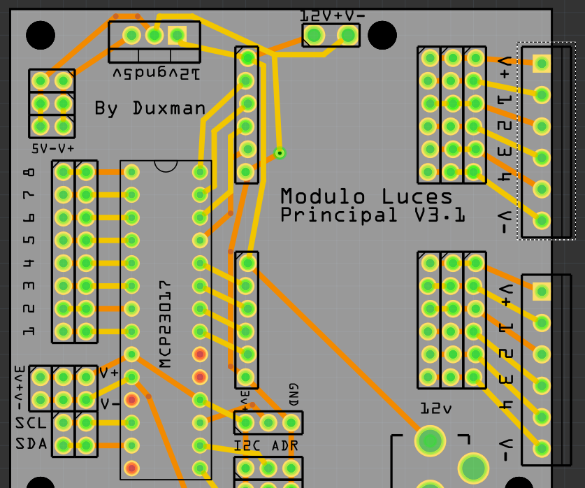

Step 3: Use My Designed Hardware, V1
This is my first board version
We can control three Zones or a RGB led strip
You only need three transsistor tip120 a conexion pins and connection terminals
Step 4: Use My Designed Hardware, V2
This is my second board version
We can control 15 Zones You only need 15 transsistor tip120 a conexion pins
