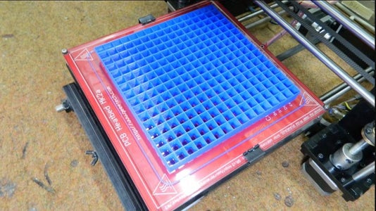

The components are built into a suitable box made of PVC material that I made for a previous project of mine, and on the front of the matrix there is a 3D printed grid for which you can find the .STL file at the end of this text.
To achieve a more realistic simulation, I used a tilt switch, so by rotating the clock 180 degrees the countdown starts over.
