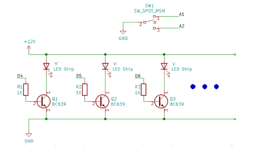

Step 4: Circuitry
An Arduino Uno is used to control each letter, however the GPIO pins on the Arduino cannot sink or source enough current to power the LEDs, so some additional driver circuitry is required. A low side transistor switch can be used to turn the letters on and off. The collector is connected to the low side of each letter, emitter to ground and the base to each GPIO pin of the Arduino via a 1k resistor. Following the circuit diagram you can include as many transistor switches as you have letters on your sign.
I made a header board with the transistors to fit neatly on top of the Arduino. If you want more letters than the Uno has GPIO pins available you could upgrade to an Arduino Mega or use an IO expander such as the MCP23017.
The 12V cable that goes to all the LED strips is then connected to the back of the positive pin of the barrel connector on the Uno. This way a single 12V DC power supply can be used for the LEDs and Arduino, do make sure the chosen supply can provide enough current for all the LEDs.
The last past of the circuitry is to attach a SPDT On-Off-On switch to toggle between the different modes. The common of the switch is connected to GND and the other two pins are connected directly to A1 and A2 and will take advantage of the internal pull up resistors on these pins.
