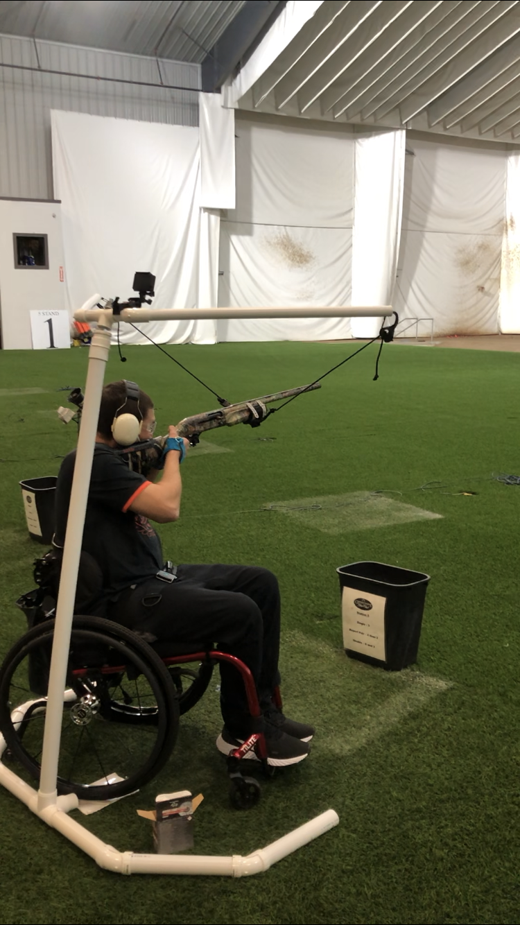

I made this piece of adaptive equipment for people who have various levels of strength deficits or impaired trunk control. It provides stability while reacting to shooter's movement capabilities and can support power wheelchairs or manual wheelchairs.
I have included the instructional guide to be a community resource for anyone who can benefit from it. Hopefully it will be straight forward to follow and easy for people to replicate.

Step 7: 1 1/2" PVC Cut List
I tried to make this where you can either follow based on the pictures or by reading the descriptions. In my updated version, I have rounded corners but as long as the edges are smooth, the corners have not impacted anything in my experience.
Step 8: DSS Base Assembly
Glue all of the highlighted areas with the exception of the vertical (53") piece into the top opening of the 4-way connector. This allows it to be broken down into 3 sections for easy transportation and set up.
Step 9: 1" PVC Cut List
I also tried to make this where you can either follow based on the pictures or by reading the descriptions. You do not need to drill all the way through the end of the 30" pieces of PVC pipe because the carabiners only hook into on hole.
Step 10: Overhead Assembly
Follow the instructions on this slide, but in summary
1) heat up the 3-way connector
2) use bolt to help press bearing into position and allow to cool
3) use PVC cement to adhere components leaving slight angle into upright
4) attach carabiners with locking mechanism facing to outside away from individual using device to hold in place
5) tie 1/4" paracord to alternating buckles to paracord bracelet (to allow for rapid attachment/detachment) and tie a knot on ends to prevent lines from falling through if it slips
This is the step where if it is not going to need to be adjusted for a variety of wheelchair heights, you can get it the appropriate height and just tie the rope straight to the hole in the PVC pipe.

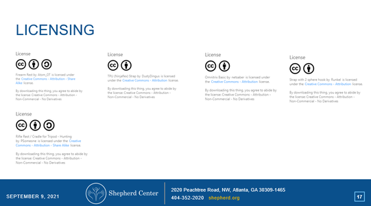

Step 12: References and Licensing
I welcome any feedback to improve performance or accessibility to try and allow as many people to benefit from this as possible. Thank your time looking through my instruction guide. Happy building and enjoy it!
